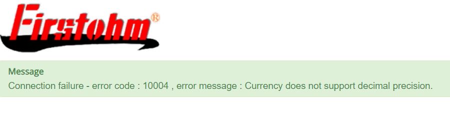

We use paypal plugin, it used to work well, but recently we got this error message:
Connection failure - error code : 10004 , error message : Currency does not support decimal precision.
Could you tell me what is going wrong,

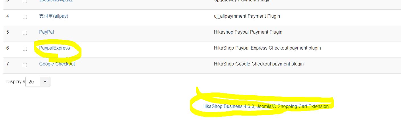

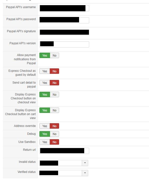

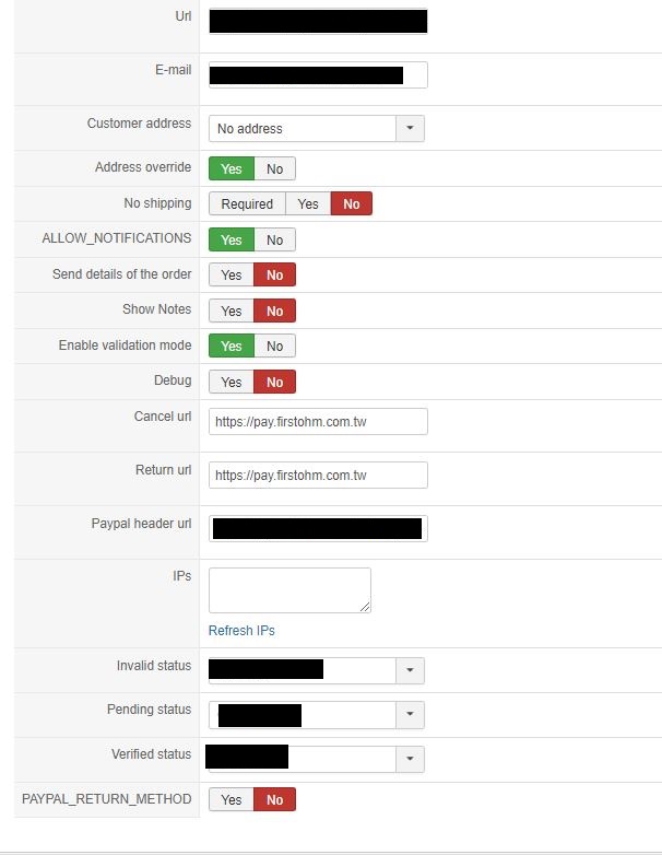

I just installed the new plugin, but I found a big problem that is the setting is different from my original one.
The plugin we were using is PaypalExpress
and the setting page is in attached_1
and the new plugin setting page is in attached_2
Could you send me this one
Thanks again

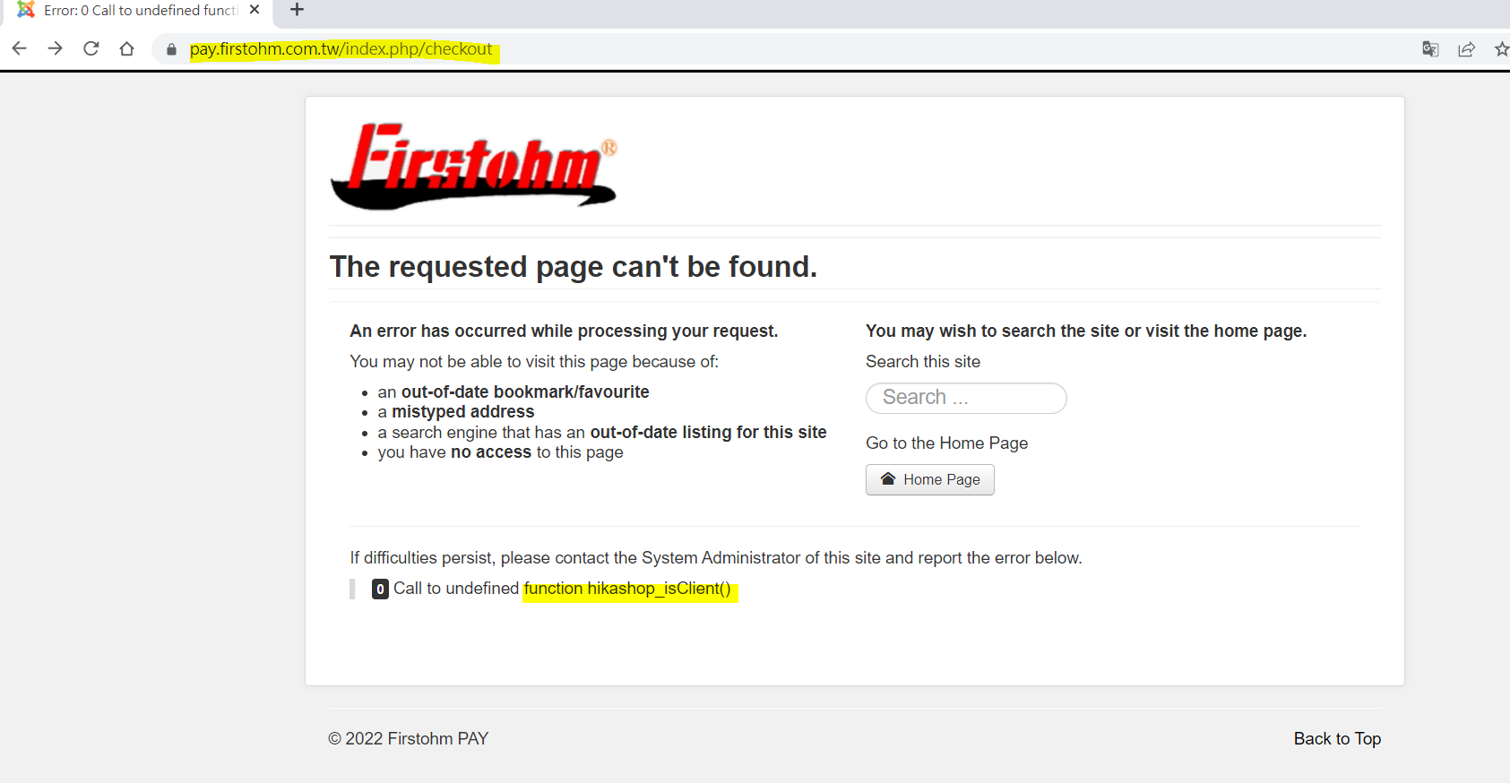

Thansk for you prompt replay, but I still have trouble setting my paypal.
Attached is the screenshot from after installing the new paypalExpress plug in.
That was when I click on add to cart.
Could you help to solve the trouble, thanks.

4 years 5 months ago #342685 by nicolas
Replied by nicolas on topic paypal not working
That's because you have an old version of HikaShop.
Update your HikaShop and you won't have that error.
I checked your website and it seems pretty standard so updating shouldn't be a problem.
