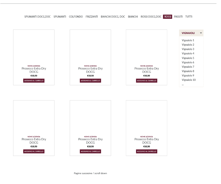

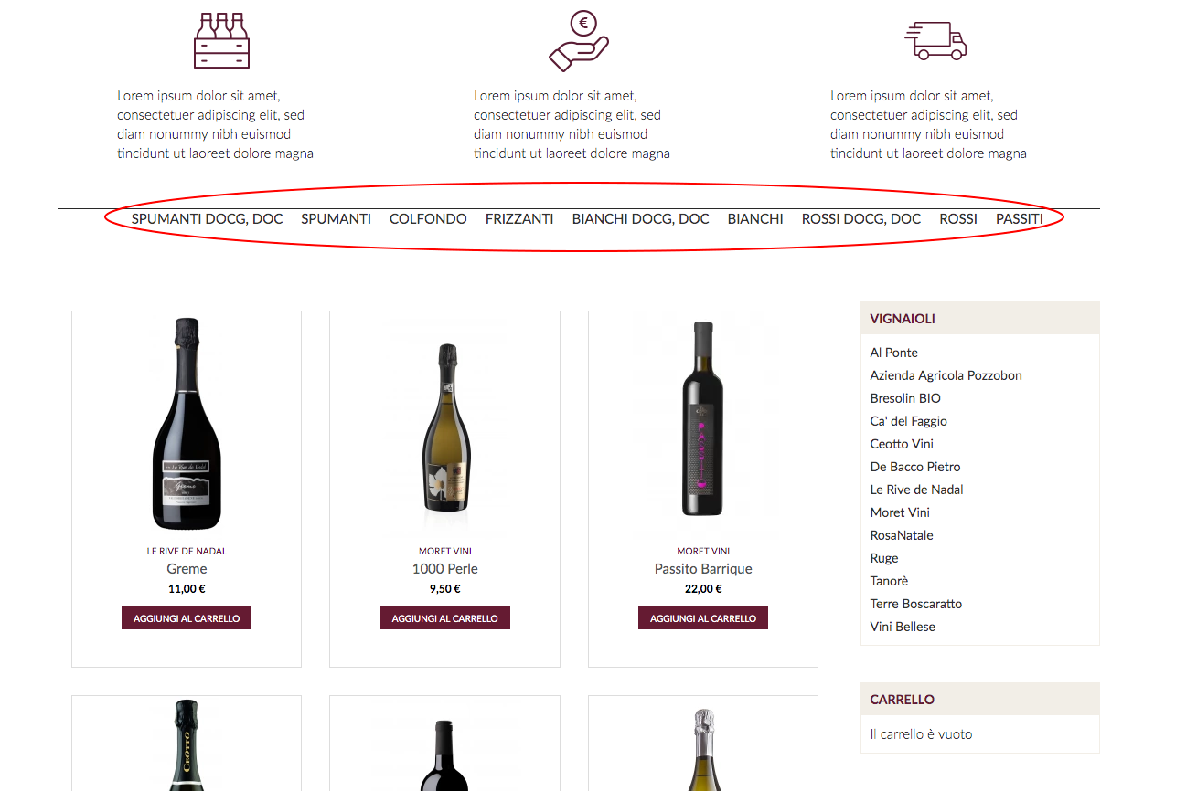

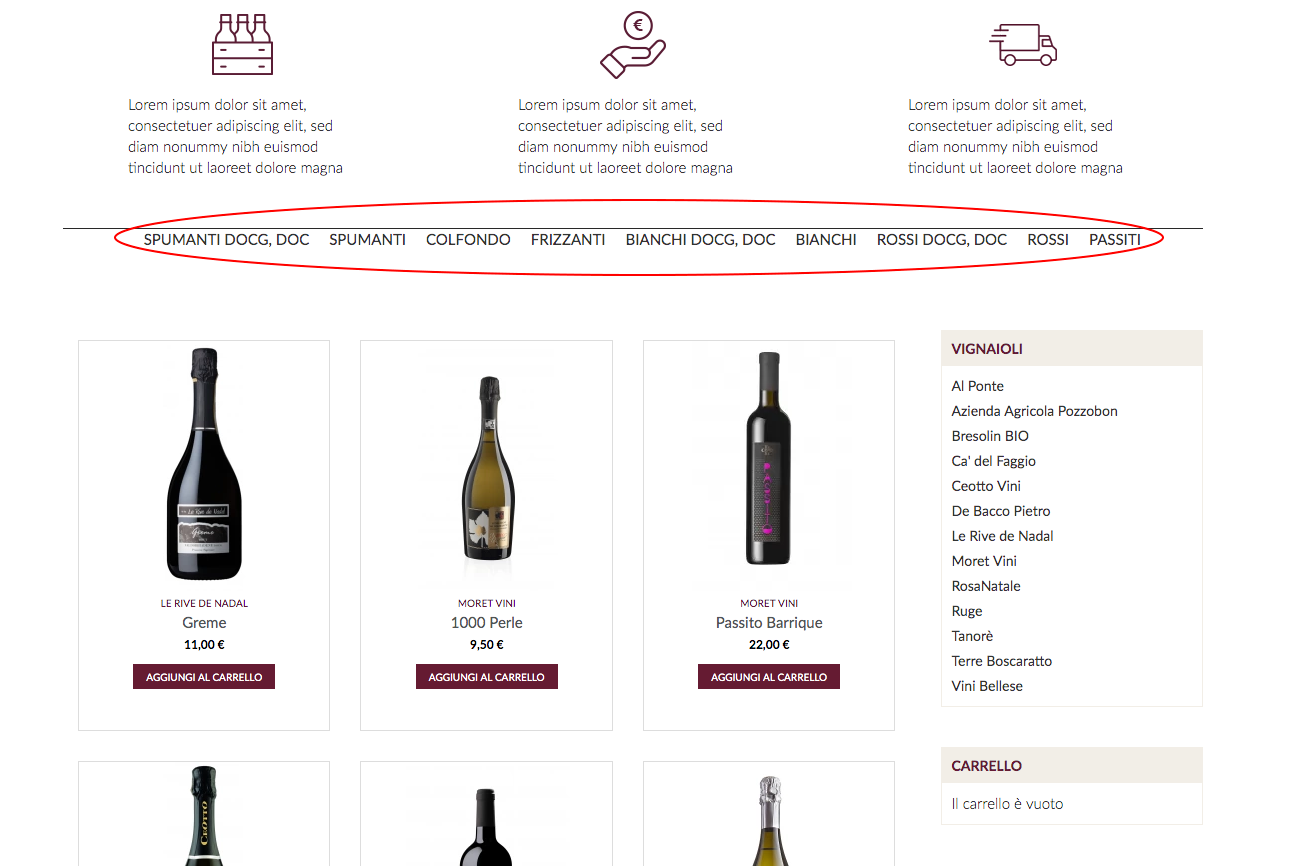

I'd like to create filter like the attachment; so I create a filter on Hikashop admin and I'd like that filter are on text type in the same line, so when I click on filter product are view based on the choice.
How can I do that?

7 years 2 months ago #310040 by nicolas
Replied by nicolas on topic Filter on product list
You can create filters via the menu Display>Filters in your backend.
Then, you want your "rossi" menu item to list all your products by default and you want to turn off the "filters" display setting of the menu item so that the filters don't appear at the top of the listing.
Then, you can configure the Hikashop Filter module via the Joomla modules manager to display in the sidebar position of your template for that menu item so that it can display your filter.

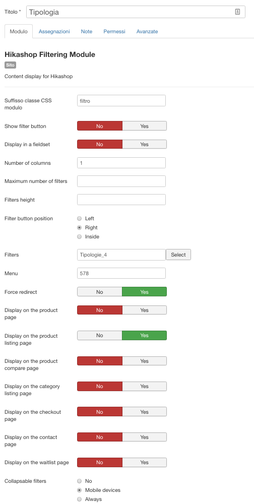

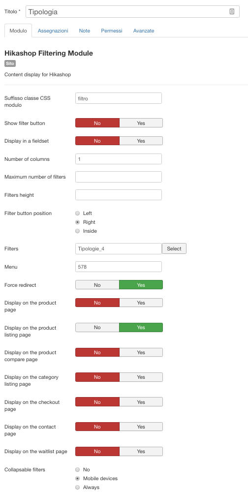

here the screen of module configuration.

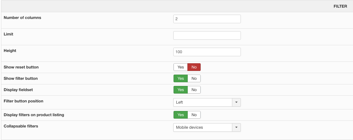

7 years 1 month ago #310245 by nicolas

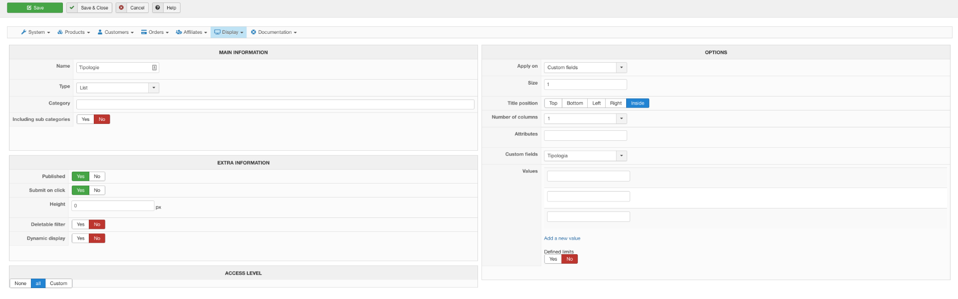

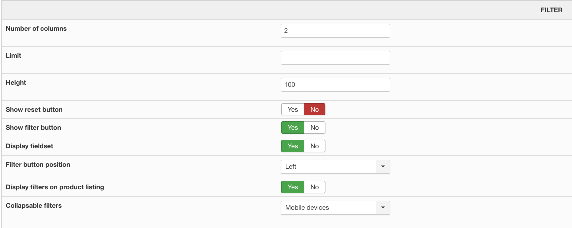

1. That's a screenshot of the settings of the filter section of the HikaShop configuration, that's not a screenshot of the settings of the filter itself.
Please go in the menu Display>Filters and edit your filter there. I need a screenshot of that area.
2. For the brand title, go in the Joomla menu manager and edit your menu item with the alias "hikashop-menu-for-brands-listing". There, make sure that the "show page heading" setting is activated and that the "Use the menu name as title" setting is deactivated. Then it should display the brand name as heading of the listing as you want.

here the attachment.

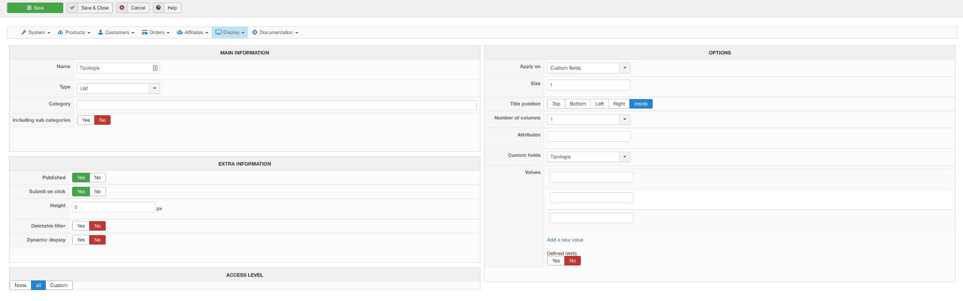

Matteo Fontana
More
7 years 1 month ago #310285 by nicolas
HI,
1. Thanks. I was able to reproduce the issue and added a patch for it. Download again the HikaShop Business install package on our website and install it on yours and you'll get the patch.
2. Try adding a value "all" to your custom product field. And in the "value" input of that "all" value, leave that input empty.

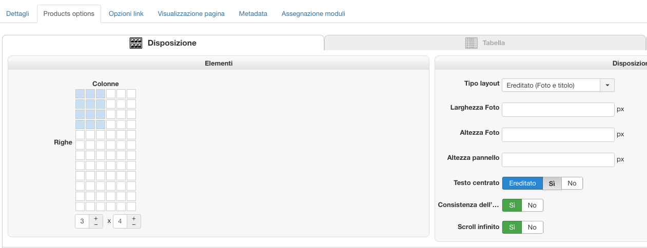

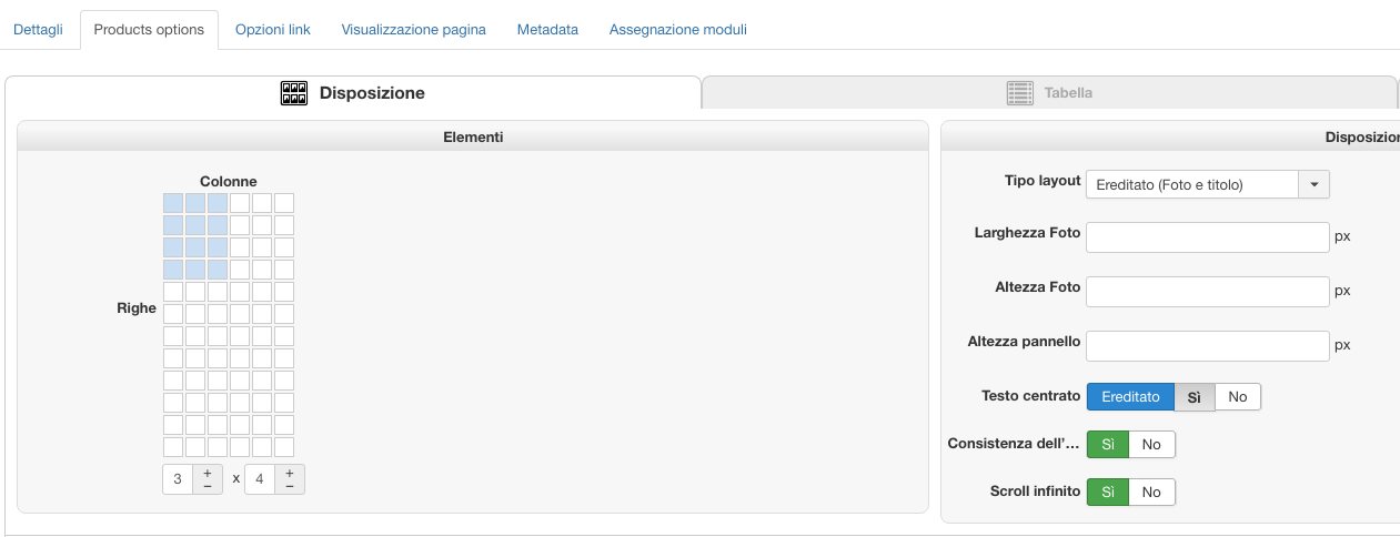

I've another problem, I activate the infinity scroll on menu settings but no function on frontend. Why?
Matteo
More
7 years 1 month ago #310625 by nicolas
Could you provide a link to this menu element ?
Also, try to temporarily rename the folder templates/YOUR_TEMPLATE/html/com_hikashop/product/ via FTP in order to deactivate the view overrides of your template on the products listings. If it works that way, then it means that the issue comes from one of the overrides in this folder. You can then rename the files one by one in that folder in order to find the culprit.

7 years 1 month ago #310796 by nicolas
Looking at the situation, it seems that you've activated the "random" setting of your menu item. In that case, the page will display 12 random products each time the page is refreshed. So in that case, you can't have a pagination (otherwise, you wouldn't see some products or you would see others several times).

7 years 1 month ago #311079 by nicolas
You would have to turn off the "force redirect" option of the filter module.
Then the module will filter the products listing on the same page.
Note that this supposes that the products listing below the filter module has all your products.
