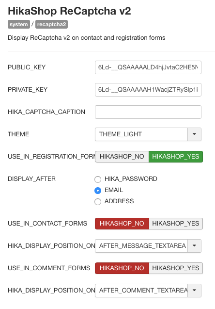

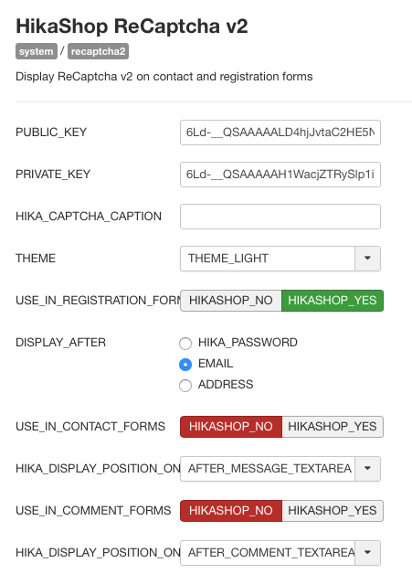

8 years 3 months ago #293451 by Scott2451
Replied by Scott2451 on topic Recaptcha v2 issue
See the attached screen shot. Is this correct?
I disabled the other plugin which is named Captcha - ReCaptcha.
The reCaptcha does appear on the Hikashop page were we ask for a person's email address.
Any other forms outside of Hikashop for other purposes the reCaptcha is there.
We are having an issue with some people that come to the site to order what the site sells. They say "Some users are not seeing a captcha but they are being told the solution to the captcha is wrong and they cannot order."
More

8 years 3 months ago #293462 by nicolas
Replied by nicolas on topic Recaptcha v2 issue
The way you configured the plugin it will only display itself on the registration form of HikaShop and Joomla.
It won't display in any other form and won't interfer with them.
If you see the the recaptcha of the plugin on the checkout, then, as long as you fill the captcha correctly it will work.... unless another captcha system interfers with the registration process. If that's case, then please check that the "Default Captcha" setting of the Joomla configuration is set to "none" and that the " Captcha" setting of the user manager options of Joomla is also set to none.

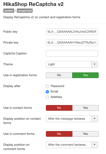

8 years 3 months ago #293492 by Scott2451
I don't understand what you're saying in your reply. Its confusing.
I just looked in the Joomla Global Configuration Site tab. Default Captcha is set to Captcha - ReCaptcha. You saying I should change it to None?
Are there any other settings that need to be changed? If so where are they?
Should I leave the settings as they are in the screen shot that I posted here?
Will the reCaptcha still be on forms outside of Hikashop if I change the Default Captcha is set to Captcha - ReCaptcha to none?
I also have a reCaptcha plugin other than Hikashop's. Should I keep that disabled or enable it?

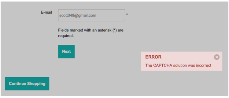

8 years 3 months ago #293497 by Scott2451

8 years 3 months ago #293521 by nicolas
On both URLs, you're using HikaShop 2.6.0.
Please update your HikaShop.
Normally, after that, on the page of your screenshots, you should see the recaptcha from the Recatpcha v2 plugin as long as you publish it and correctly configure it (which looks like it's the case).

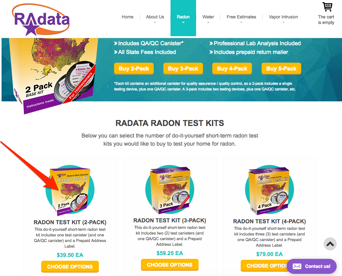

8 years 3 months ago #293606 by Scott2451
See the attached screen shot. You clicked on the wrong one. Go back to dev.radata.com and click on the item that I have a red arrow pointed to.
On the dev site the captcha works and can be seen.
Its on the prod site radata.com that it doesn't work. I've said this over and over again. I had disable Hikashop reCaptcha on this site because it was stopping people from ordering and we can't have that. If you look back at the prior screen shots you'll see that when I had it enabled that error appeared.

8 years 3 months ago #293615 by nicolas
This wasn't clear and it still isn't.
The only screenshot you provided of the issue so far is on this message:
www.hikashop.com/forum/customers/879744-...v2-issue.html#293497
And on this screenshot the captcha doesn't appear but the error message appear.
But here, you're saying that the captcha displays but you get an error.
First, you need to understand that each captcha system has two elements:
- the displaying part, which display the captcha interface on the form
- the checking part, which checks whether the captcha was solved correctly and refuse or not the submission of the form
So the catpcha "not working" on the registration form of the checkout of HikaShop can have three scenarios:
1. the display works, the checking doesn't. Since the plugin itself works fine, it means that something else refuses the submission. This ussually happens when another captcha plugin is triggered for the checking while it didn't display itself on the form. And that happens when you have other captcha plugins for the user account creation enabled but not compatible with the registration form of HikaShop.
I thought that this was your issue first as it's the most common and thus that's why I recommended to check other captcha plugins.
2. the display doesn't happen and the checking doesn't either (meaning that no checking is done). This would mean that the plugin is deactivated.
3. the display doesn't happen but the checking display an error message.
Your screenshot seemed to indicate that you were in that case.
In that case, it's usually because of a customization of the form not expected by the captcha plugin, and that's what I was talking about here:
www.hikashop.com/forum/customers/879744-...v2-issue.html#293540

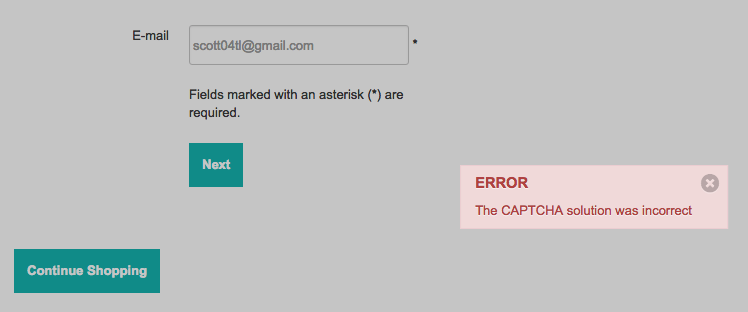

8 years 3 months ago #293685 by Scott2451
As my message said but you skipped over it look at the screen shot from a prior message I posted so here it is again included in this message. This is from the production site radata.com - I had to disable the Hikashop reCaptcha because it was stopping people from ordering but I wanted you to see the error again before I disabled it.
There are three reCaptcha in Joomla. Hikashop reCaptcha, reCaptcha (that are plugins) and Joomla's reCaptcha that is found in System Confiq.
Which ones should be enabled and which ones disabled so that the Hikashop reCaptcha doesn't put out the error?

8 years 3 months ago #293692 by nicolas
No, I didn't skip your message...
On this screenshot there is an error message and no display of captcha.
So the reason you don't get the display of the captcha is either that you have the recaptcha v2 plugin we provide disabled, or that the view has been customized in a way preventing the plugin to display itself.
If the recaptcha v2 plugin is disabled, then the error message you get on that screenshot doesn't come from the recaptcha v2 plugin, but another plugin that you should deactivate.
If the plugin is enabled, then it's normal that you get the error when it can't display itself. And in that case, you want to follow the indications there:
