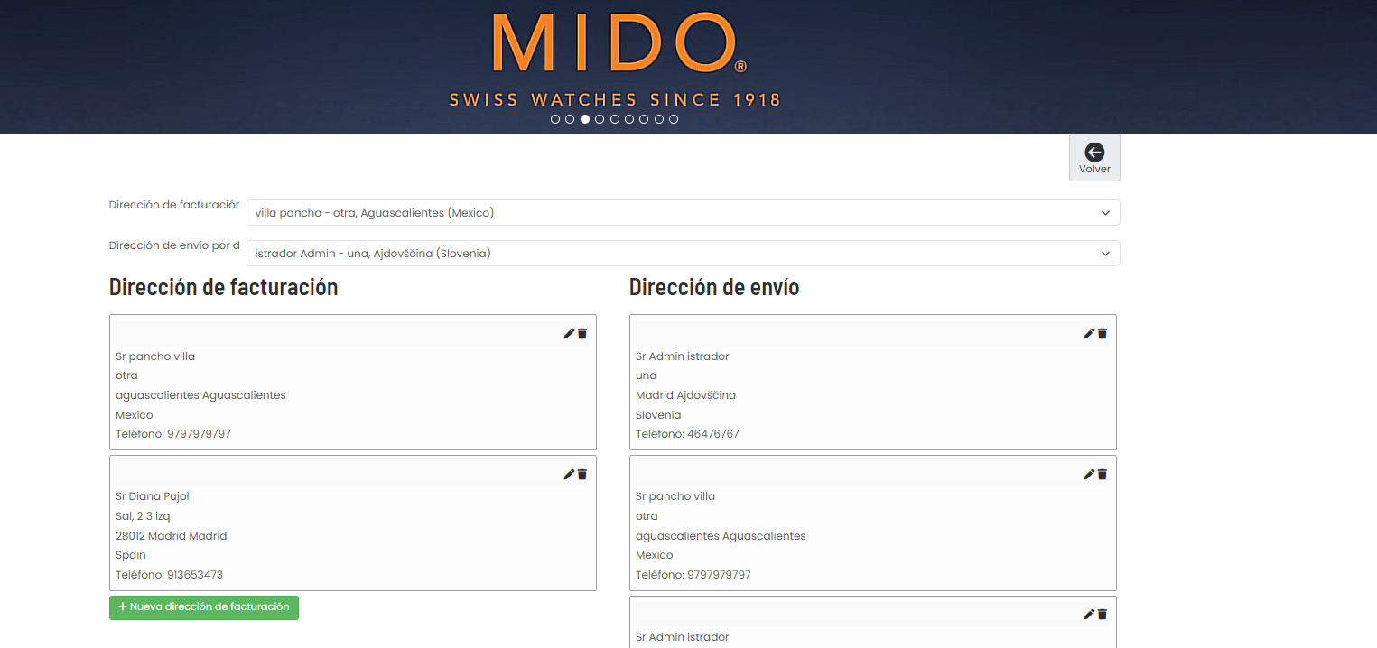

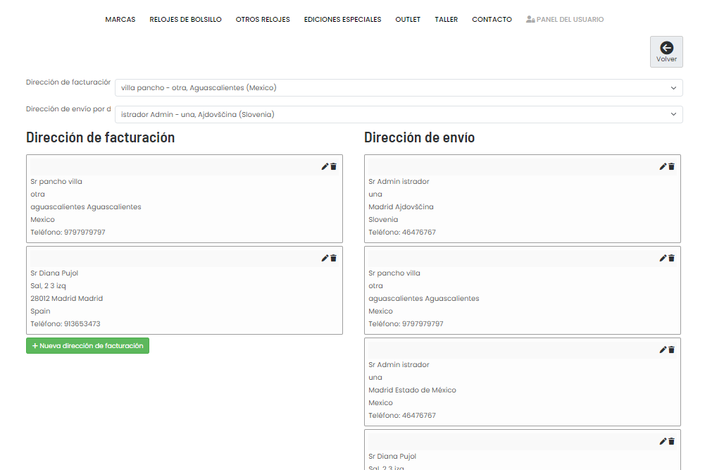

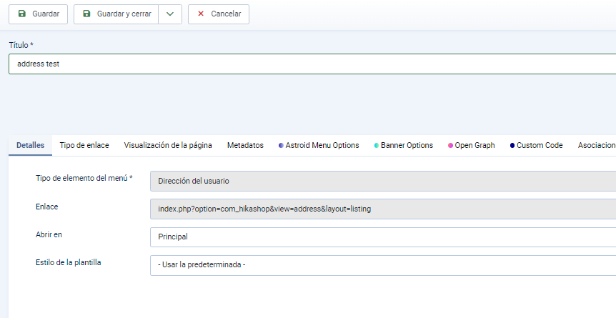

2 years 2 months ago #362908 by Reyesar
Replied by Reyesar on topic User Panel
I have created the menu element again (see image)
I have clicked in it and the page is the home template (yo can see the banner over the addressess) and the return button. The URL is component/hikashop/view-address/layout-listing
I have clicked on addressess from the cpanel (another template). The URL is panel-del-usuario/panel-del-usuario/address

2 years 2 months ago - 2 years 2 months ago #362913 by nicolas
Replied by nicolas on topic User Panel
I don't see how that's possible that you get that URL when accessing the user addresses area from a menu item configured like that.
Either there's an extension messing with the URL generation or there's something else I'm missing.
Could you provide via our contact form a backend access and a FTP access in order to check on the situation ?
