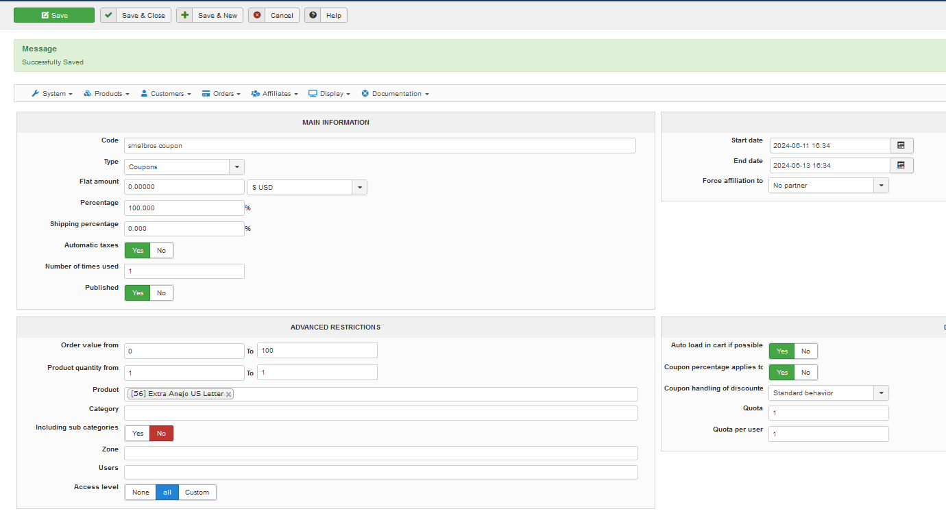

2 years 4 months ago #361524 by FrameMakers
Replied by FrameMakers on topic Using Coupon codes
Thank you for your quick reply.
I have created a coupon and assigned it to a specific product. But I can not see the coupon option appear in the checkout.
Am I doing something wrong?

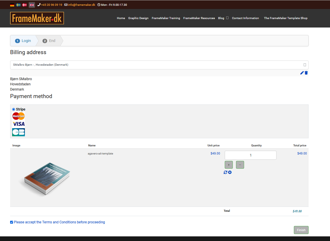

2 years 4 months ago #361579 by framemaker
Replied by framemaker on topic Using Coupon codes
Thank you for your answer. I am still having problems, though. I am not able to make the coupon show in the checkout.

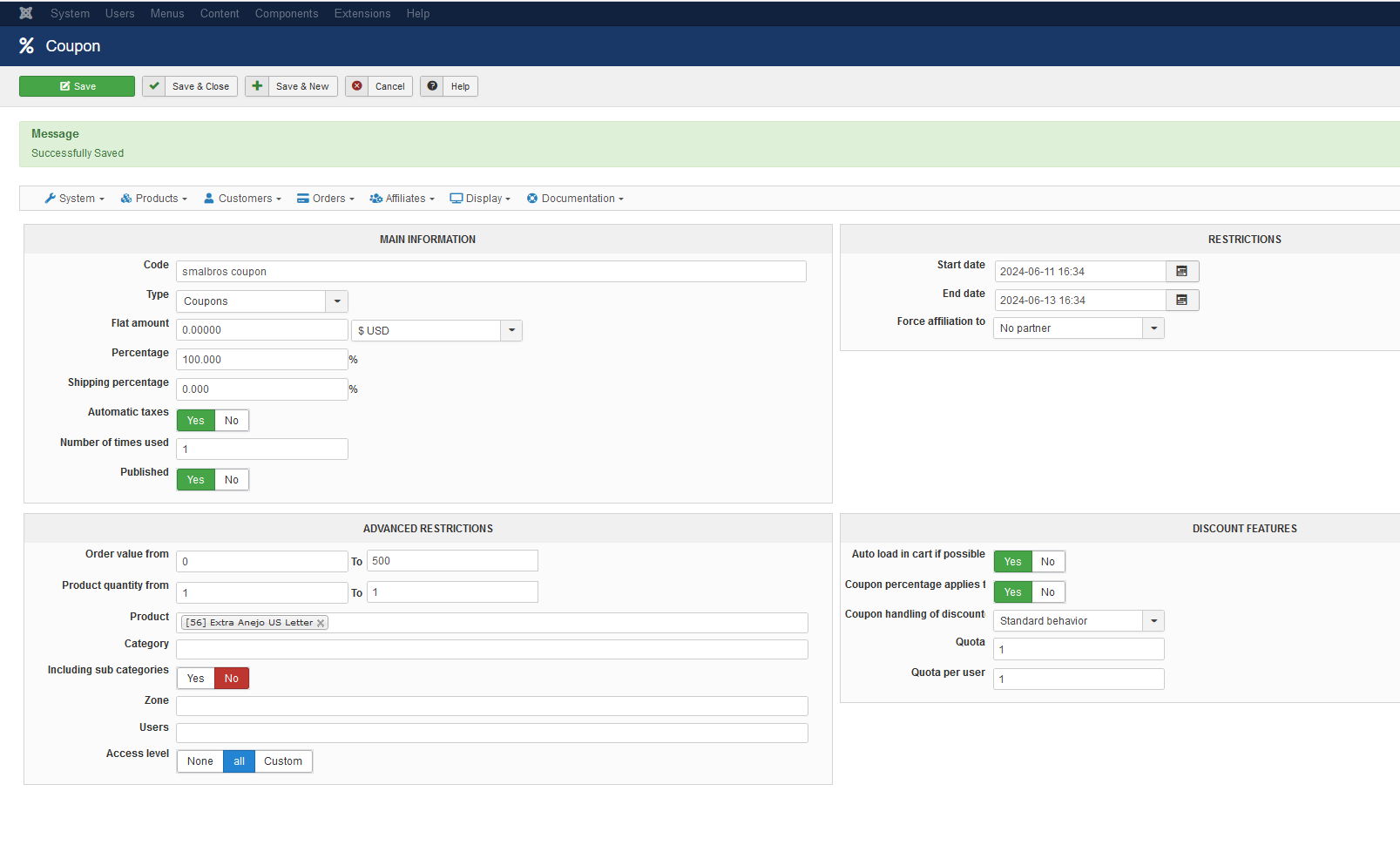

1: I have created a coupon and assigned it to a product (coupon setup.png)

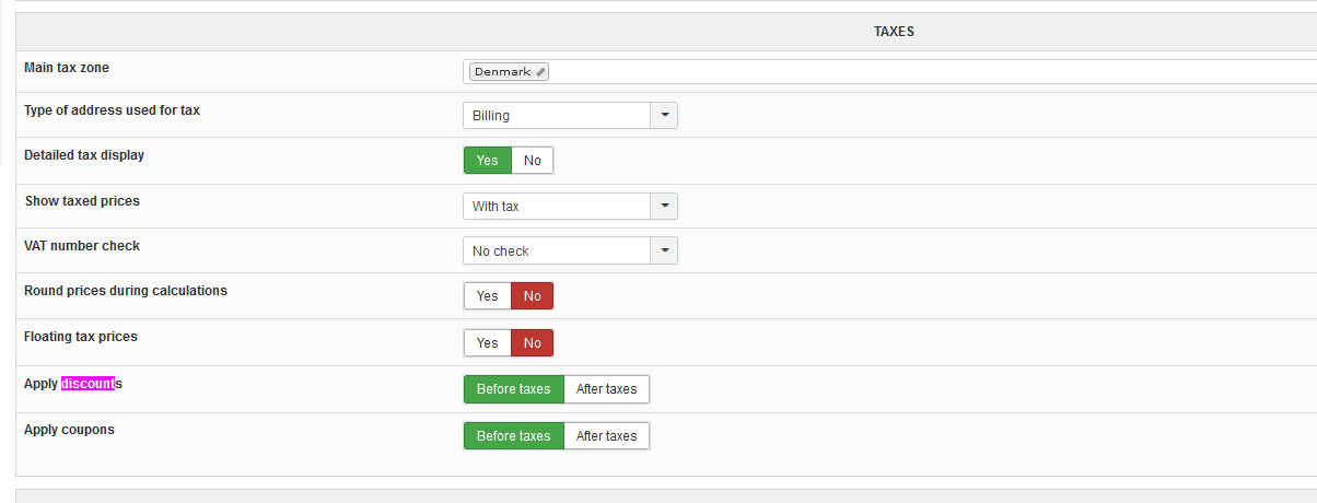

2: In the configuration I have enabled coupons (apply discount.png)
3: In the "Display", coupons are enabled (display coupon.png)
4: But no coupons in the checkout (checkout.png)
Something is not working and I am not clever enough to figure out why not. Can you possibly help me please?

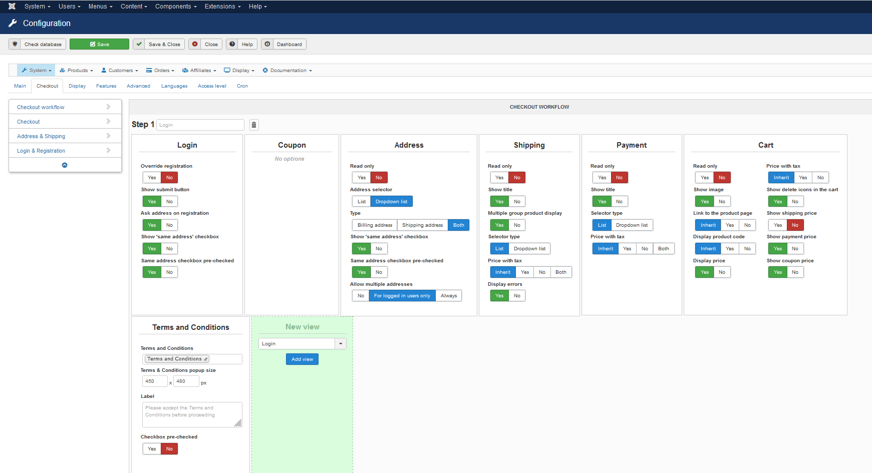

2 years 4 months ago #361581 by nicolas
Replied by nicolas on topic Using Coupon codes
As I said, you need to add back the coupon view in your checkout workflow, in the HikaShop configuration:
www.hikashop.com/support/documentation/4...eckout-workflow.html

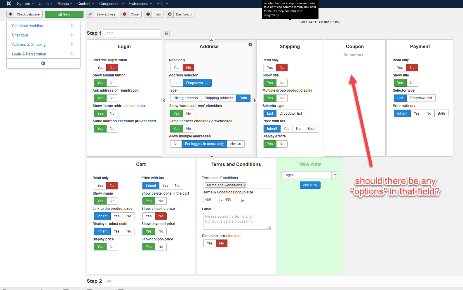

2 years 4 months ago #361600 by framemaker
Thank you for your always quick answers!
I have inserted the Coupon field in the checkout workflow. But I am still not able to make it work. I would expect to have to add some sort of value to the "options" in the Coupon field? Am I overlooking something very obvious?
Best regards
Bjørn Smalbro

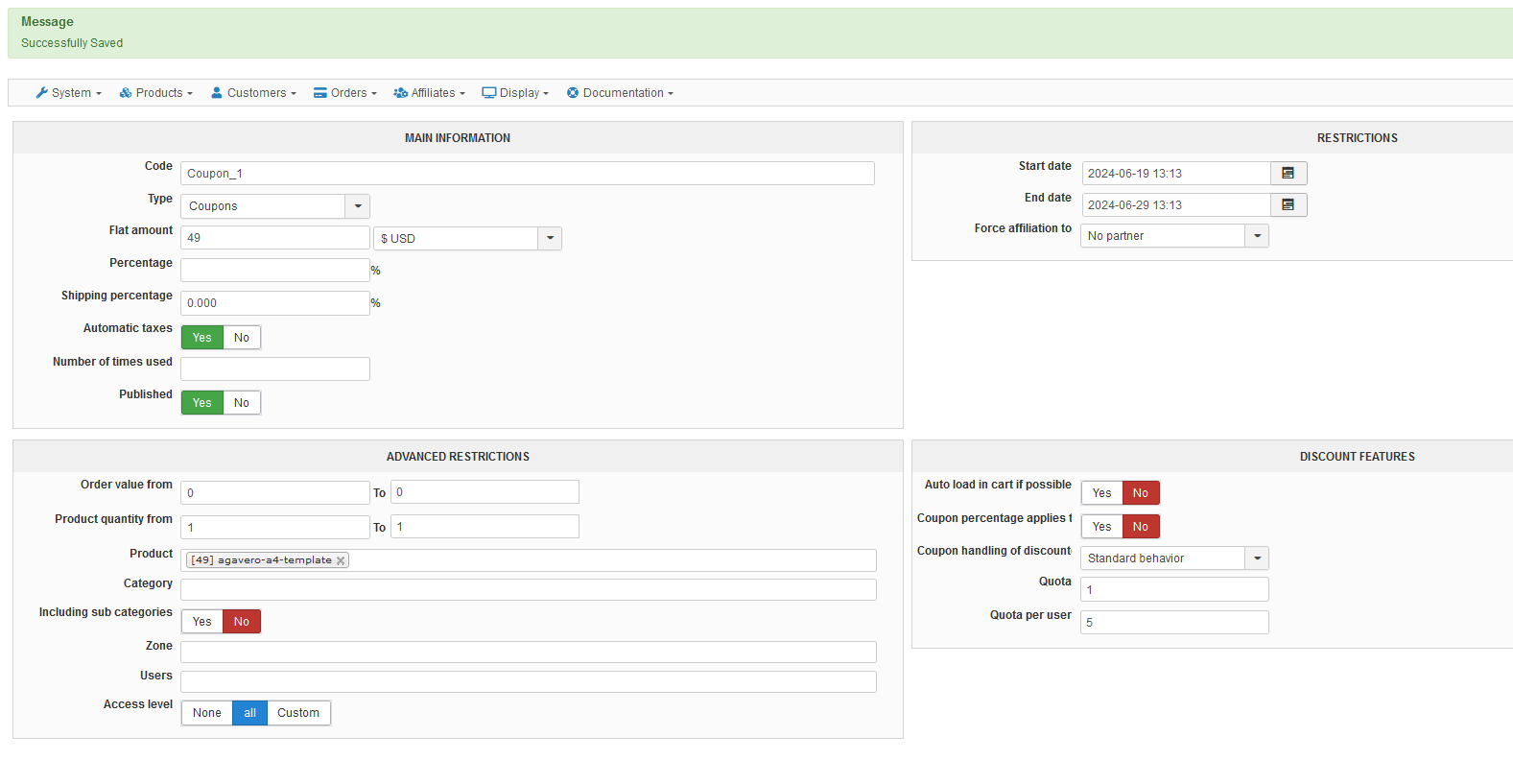

2 years 4 months ago - 2 years 4 months ago #361601 by Philip
Replied by Philip on topic Using Coupon codes
From your configuration, we think we know why your coupon don't work :
You have restricted your coupon to be used in a specific dates, except, this date has now passed.
Last edit: 2 years 4 months ago by Philip.

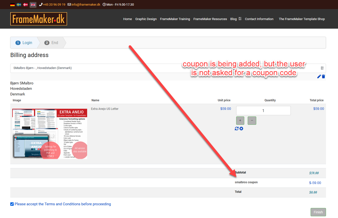

2 years 4 months ago #361660 by framemaker
Once again - I am grateful for your quick answers

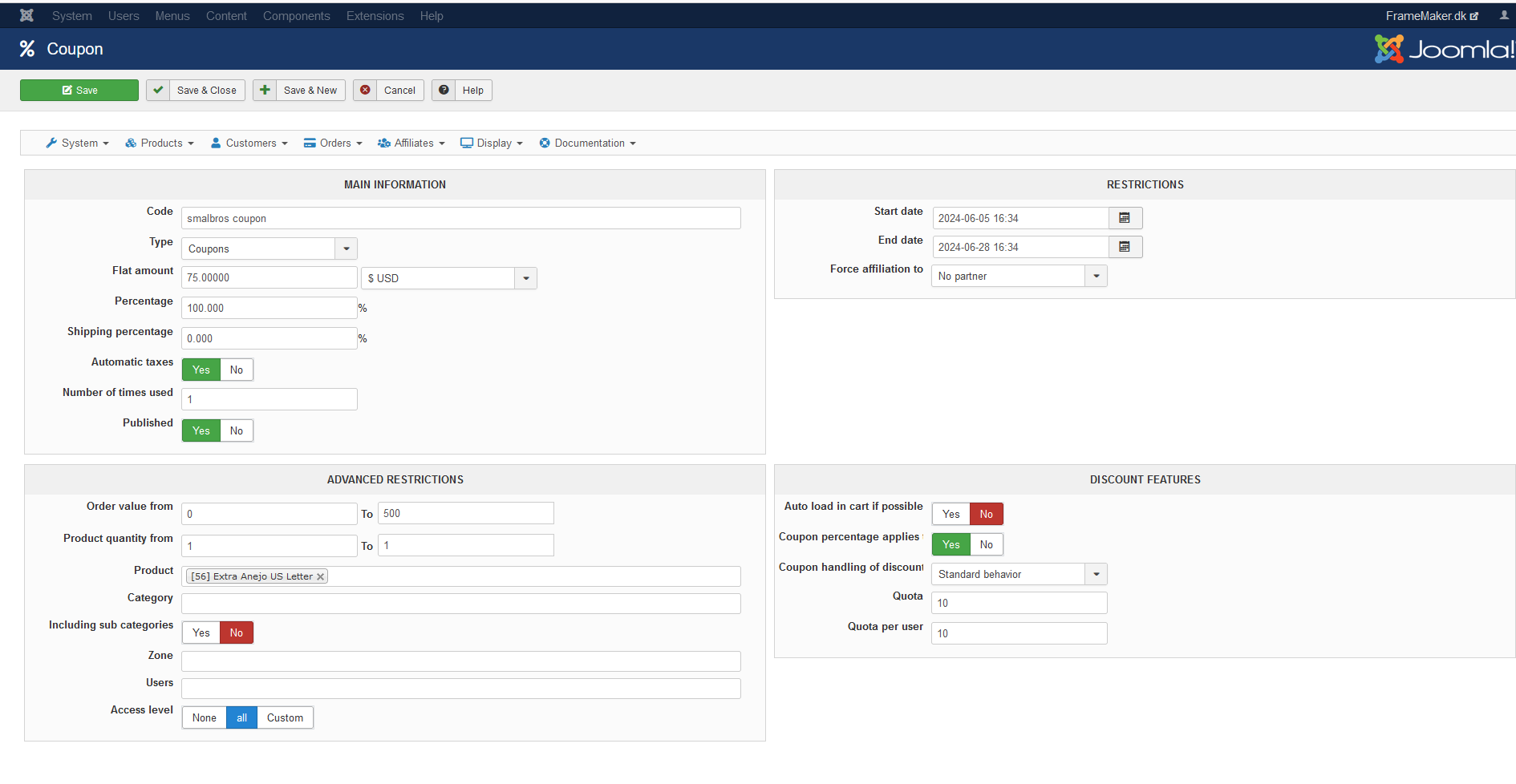

I have changed the coupon setup to not use autoloads. (Coupon setup no autoload)
On checkout the coupon IS subtracted from the checkout sum, but the user is not prompted for a coupon code.
I would expect the user to be prompted for a coupon code, which would release the discount.
And I would expect a coupon field to show always. Have I overlookend an option somewhere to always show a coupon field in the cart?
Best regards
Bjørn Smalbro
More
2 years 4 months ago #361665 by nicolas
Once the coupon is added to the cart, even if you turn off the "auto load" setting the coupon will stay linked to the cart and the system won't provide the coupon code input field.
To properly test this, delete your cart via the Customers>Carts menu and try again. You'll see that the coupon won't be auto loaded anymore and you'll see the coupon code input field.
If you want the coupon code input field to still be available even after a coupon has been added to the cart, then you want to use the "multi coupon checkout plugin" :
www.hikashop.com/marketplace/product/164...coupon-checkout.html
This way, the system will allow the customer to enter several coupon codes for the same order and thus, the coupon code input field will always be visible in the coupon area of the checkout.

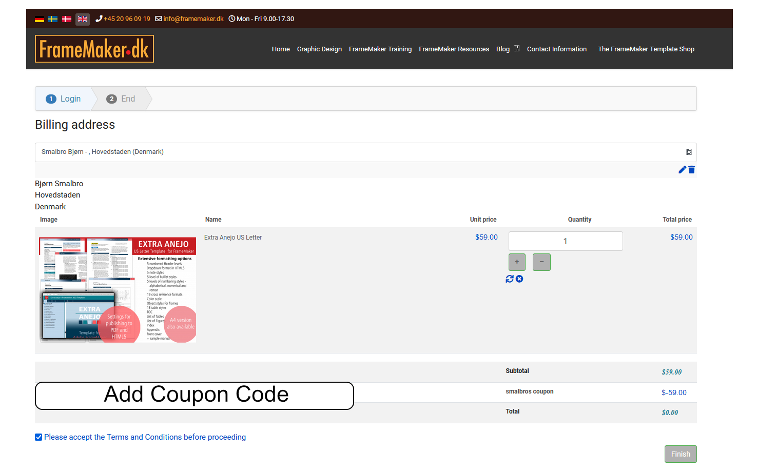

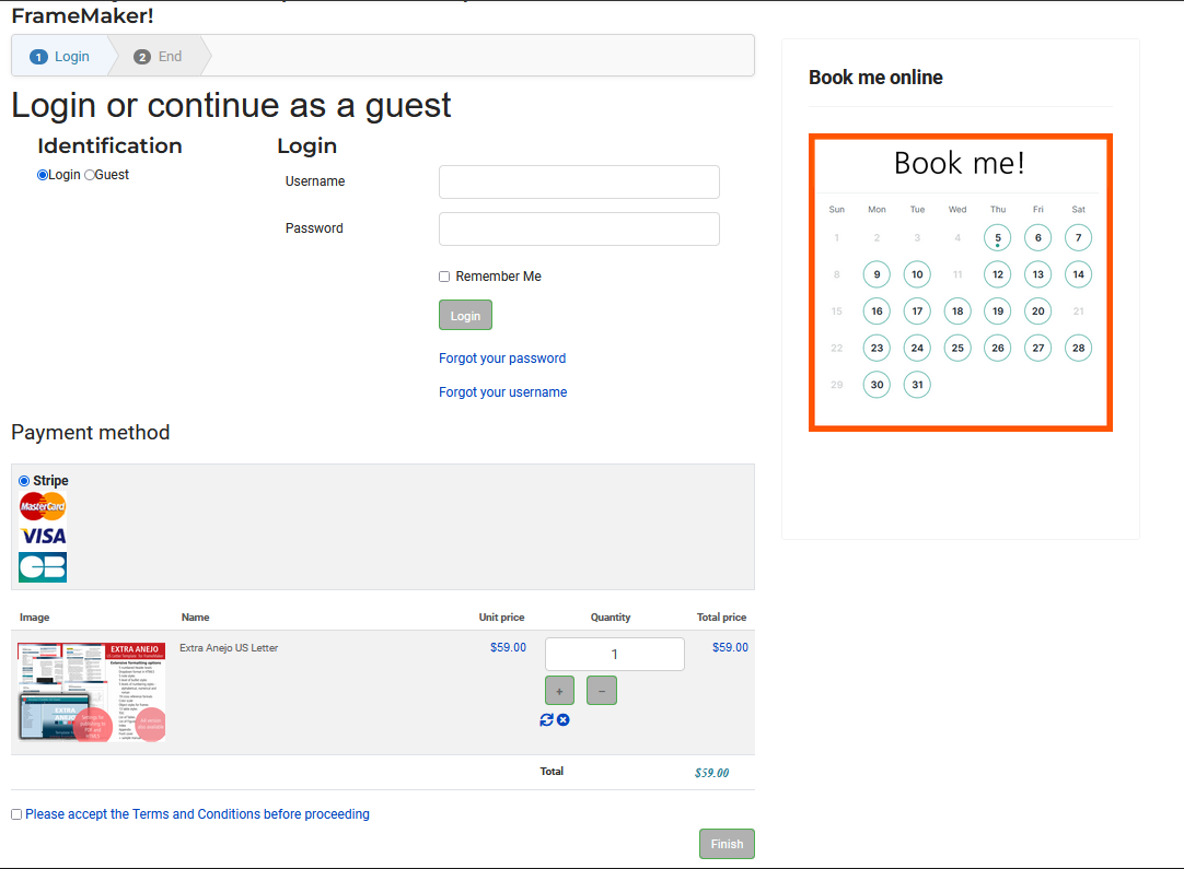

2 years 3 months ago #361735 by framemaker
Hi again
I am completely unable to make a coupon input field appear. I was expecting something like in the attached screenshot, but it is it even possible? Are my expectations just wrong? Is it not possible to have a permanent coupon code field visible?
Best regards
Bjørn Smalbro

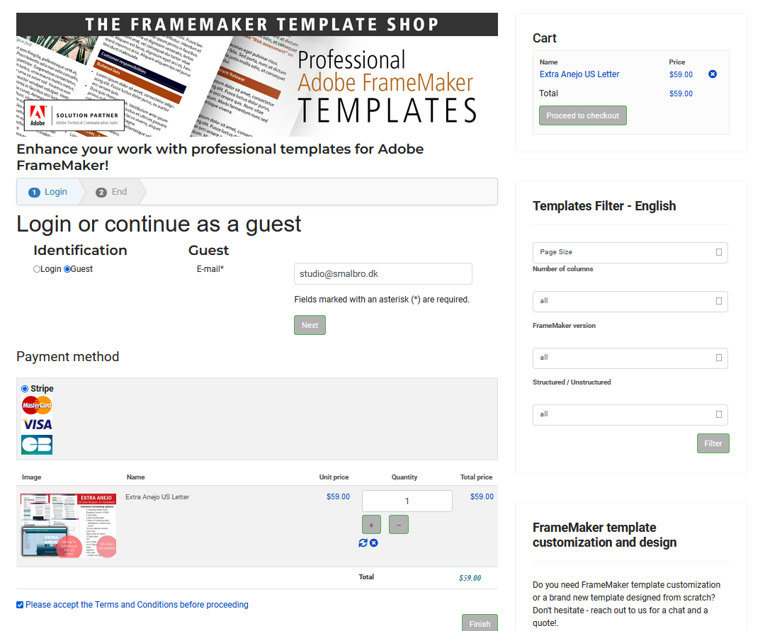

2 years 3 months ago #361746 by framemaker
Thank you for your answer. My main issue here is not getting the coupon field in the cart.
In the screen dump you have sent me, there is a coupon field. I am unable to make that coupon field show. I have added screendump of the checkout configuration, the coupon code configuration and the cart.
Best regards
Bjørn Smalbro
More
2 years 3 months ago #361750 by nicolas
There is nothing wrong with your setup.
The problem is that you've added custom CSS code in order to hide the coupon view area on your frontend:
i.imgur.com/CIbw64Y.png
So you need to remove that display:none; CSS command from your HikaShop frontend_custom CSS file:
i.imgur.com/IOKpkGO.png
The following user(s) said Thank You: framemaker
More
2 years 3 months ago #361779 by framemaker
THAT was It! Thank you very much for having the patience to help me make this work. This was clearly a fault of my own for having wanted to hide the coupon field some years ago. I am very grateful for your help!
