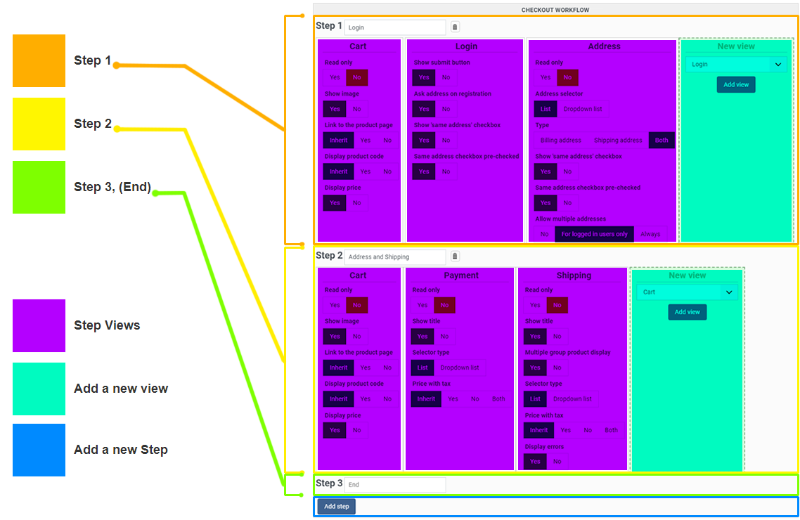

The workflow is a list of steps, one below the other. Each step is a page of the checkout, and it holds one or several views, the blocks which are displayed one below the other on that page.
  • Step : a box with its number, the title used for it in the progress bar (a field you can fill in) and a trash icon to delete it. The Add step button below the last step adds a new one.
  • View : each card is a block of the checkout page (Login, Address, Shipping...). The x at its top right removes it, and the arrows around it move it, as explained in the How to move Views section.
  • New view : at the end of each step, a block lets you choose a type of view and add it to that step.
  • The last step, End : it is not a page of the checkout: it is what the customer sees once the order is validated.

In order to move a view in your workflow you have some arrow buttons that will appear when you hover the view, all around the border of your view.
To delete a view: When you hover over a view block, you'll see a trash icon (or X) in the top right corner. Click on it to remove the view from the step. Don't worry - you can always add it back later using the "Add view" dropdown.
The up and down arrows swap the view with the previous or the next one in the same step. The left and right arrows move it to the previous or to the next step.
Manage steps
Adding a new step: To add a new step to your checkout workflow, click on the blue "Add step" button located at the bottom of the existing steps. The new step will be added at the end (before the "End" step), and you can then add views to it using the "Add view" dropdown.
Step options:
  • Step Title: The input field shows the default title that will be used for this step in the progress bar (by default, it's the title of the first view in the step). You can type your own custom text in this field.
    You can also enter a translation key here so that you can have a different title in each language of your website.
  • Trash icon button: This button enables you to delete the step.
    Note: All steps can be deleted except the last one, the "End" step. That step is not a real step of your checkout. That's the page the customer will see after clicking on the "Finish" button of your checkout, which in most cases will redirect them to the payment gateway automatically so that they can pay for their order.

  • Login/Registration first: Always place the Login view at the beginning of your checkout (usually in the first step). The customer needs to be identified before you can display shipping methods based on their address.
  • Address before Shipping: In most cases, place the Address view before the Shipping view. Shipping methods and costs often depend on the customer's shipping address, so they need to provide it first.
  • Shipping before Payment: In most cases, place the Shipping view before the Payment view. Some payment methods may depend on the shipping cost (e.g., Cash on Delivery restrictions), and the final total needs to include shipping costs.
  • Use "Read only" for order review: If you want to show an order summary on the final step before payment, add a Cart view with the "Read only" option enabled. This prevents accidental quantity changes at the last moment.
  • Terms & Conditions on the final step: Place the Terms & Conditions view on the last step of your checkout, just before the customer clicks "Finish". This ensures they acknowledge the terms right before placing the order.
  • One-page vs Multi-step: For simple products or quick purchases, a one-page checkout can reduce friction. For complex orders or when you need to validate each step (e.g., address validation before showing shipping options), a multi-step checkout is better.
  • Don't forget to save: After making changes to your checkout workflow, don't forget to click the "Save" button in the HikaShop configuration to apply your changes.
