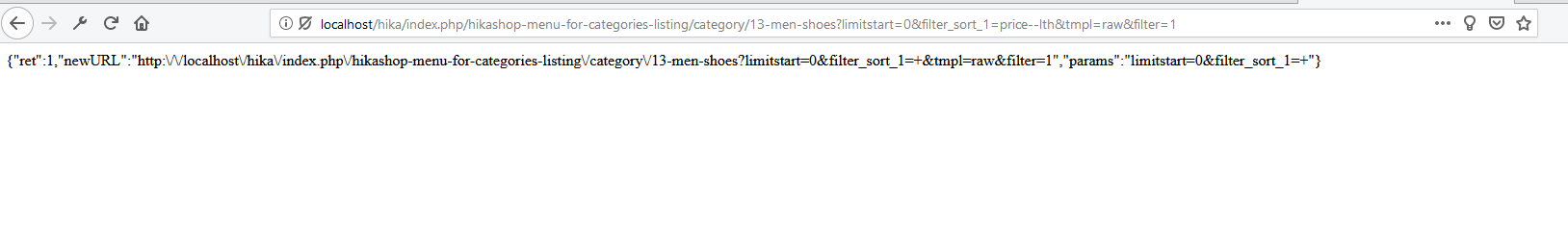

Just installed Hikashop 4.2.0 on localhost and seems cant find ajax filters. Filters are working as it was, reloading the whole page. Looking html i see it has changed... Trying with blank protostar template. Maybe i miss something?

Would like give some update here. Updated again with Hikashop 4.2.0 and it got a bit better.
1. It seems that ajax filtering works only with hikashop filter module. If filters are set to show on top of the product listing without module, it doesn't work. Just nothing happens.... You may want to take a look into this.
2. I would suggest to scroll page to the top after filtering is done. If you have a lot of filters on the left or right sidebar it is a pain for the user to scroll each time up. So we get better user experience if we do this...

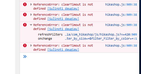

3. Setting any filtering to submit on click to "YES" and then fast double tap filter (checkbox as example) or button "FILTER", console throws error "ReferenceError: clearTimout is not defined"

Please re-download HikaShop package to get the fix regarding the JavaScript issue.

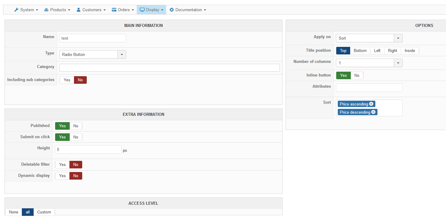

1. It is easy to reproduce the issue:
1. Create some filter, as example sort or something with checkbox
2. Create menu item of product listing or category listing
3. Via that menu item product options settings set Filters display to "YES"
4. Try to filter and see behaviour
Seems i am not the only one who have some issue like this: www.hikashop.com/forum/install-update/89...the-menu.html#308637
2. Sometime when filtering we get blank page with url params in it.
Here is the example which was done like this.
1. Installed Fresh Joomla 3.9.10 and Hikashop 4.2.0 with demo content. Created sort filter with radio. Filtering seems working but after pressing delete button i get this page:
All test are done on protostar template with no modifcations.

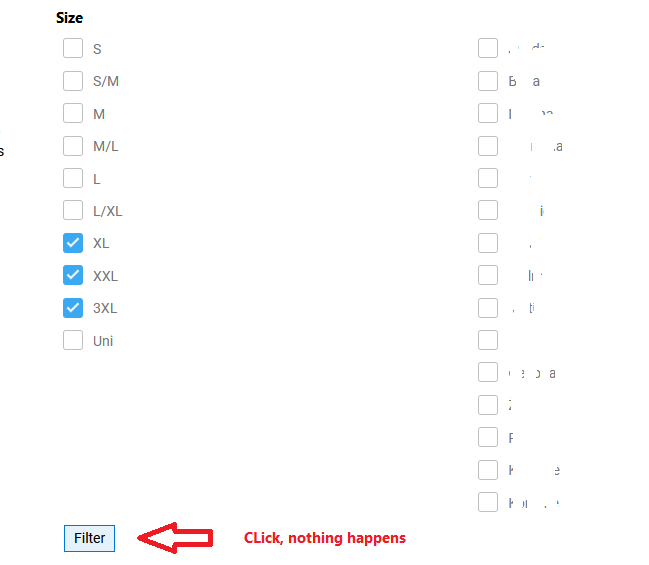

7 years 4 months ago #308732 by kyratn
Replied by kyratn on topic No ajax filtering

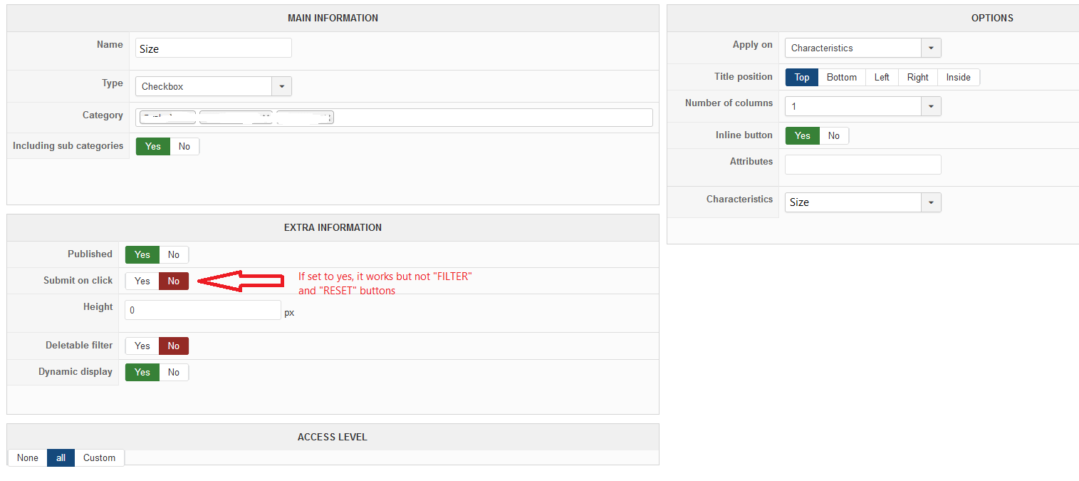

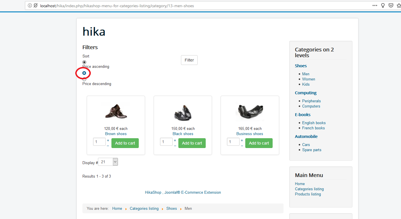

It looks a bit better but there are still some issues.
Now filtering for sort does work and if filter type of checkbox is set to submit on click to "YES" this filter does work. However if i set submit on click to "NO" and try to filter with button "FILTER" it doesn't work. Same for reset button. It just nothing happens, no any action...
Here are some screenshots which i hope will help.
7 years 4 months ago #308751 by nicolas
Replied by nicolas on topic No ajax filtering
I'm not able to reproduce the issue on my end.
Make sure you have the latest build and no override of the view files product/listing.php product/listing_div.php and product/filter.php
If you do, try renaming them in templates/YOUR_TEMPLATE/html/com_hikashop/product/ and try again.
7 years 4 months ago #308755 by kyratn

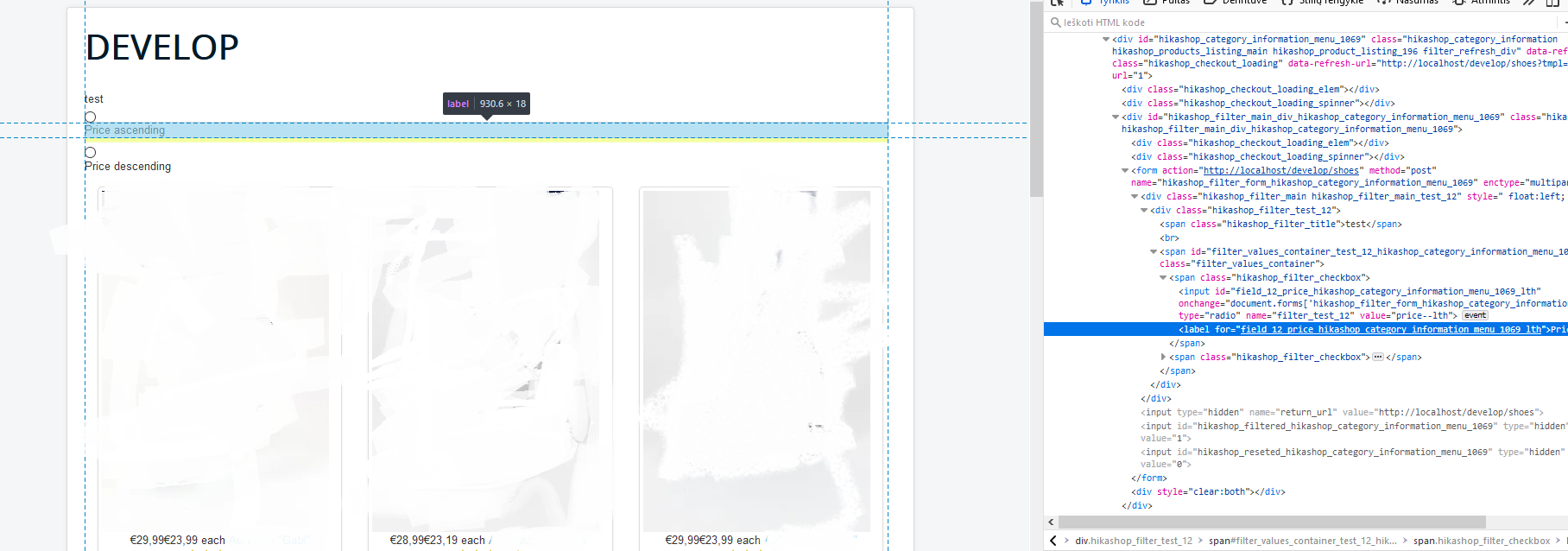

Nope, no view overrides but i found the issue.
Via Hikashop configuration-> Filter button position, setting it to "Right" or "Left" is fixing the issue.
So checked html and it seems if button position is set to "Inside". "Filter" and "Reset" buttons are missing some html "data-container-div"
Someone forgot to add:
Code:
<?php echo $attributes; ?>
For these buttons :)
Please take a look into it.
Thank you

7 years 4 months ago #308760 by nicolas
Thanks for the feedback. Indeed the attributes were missing for that button position and my buttons were in another position so I didn't see the issue.
I've added the patch and updated the install packages on our end.
