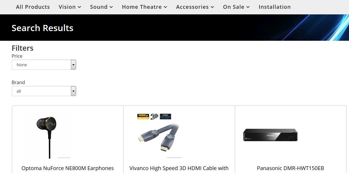

My users are complaining that the filtering has stopped working since I updated the site to 4.2.1.
1. It used to automatically filter as soon as I selected a filter, but now I have to hit the filter button?
2. It's not possible to remove the filters without adding a reset button (which it never used to need). Clicking the small crosses against each filter does nothing for me?
3. Is it possible to remove the search box on the filter page as it's not really necessary to have it displayed here?
Here is an example category page ... www.leconcepts.com/sound/wireless-music

In the meantime, if you take a look at my home page, is it possible;
1. to put the go! (filter) button inline with the search box? I have tried all options including making the column number smaller and also placing filter box on right but it disappears when I do this. The only way I can make it show is set the position as inside on the search module settings.
2. I don't need the search box on the filter results pages (under the filters - how do I get rid of this?

7 years 2 months ago #310749 by serbofleconcepts
Thanks, with regards to hiding the search bar on the product listing page, I usually add my custom css in the template area in the Joomla backend and they usually work ok, but this one doesn't seem to want to. I can't see it in the browser css inspector either. I've added !important to it too.

7 years 1 month ago #311049 by serbofleconcepts
Hi Nicolas, I couldn't get it to work no matter so I ended up replacing both the filter.php and listings.php files extracted from the lasted Hikashop download.
This has fixed everything, but I can't help wonder why the original files were dated 2018 - it suggests they weren't updated in the last update?
Also, is there a way to show the filters across the page rather than stacked on top of each other?
