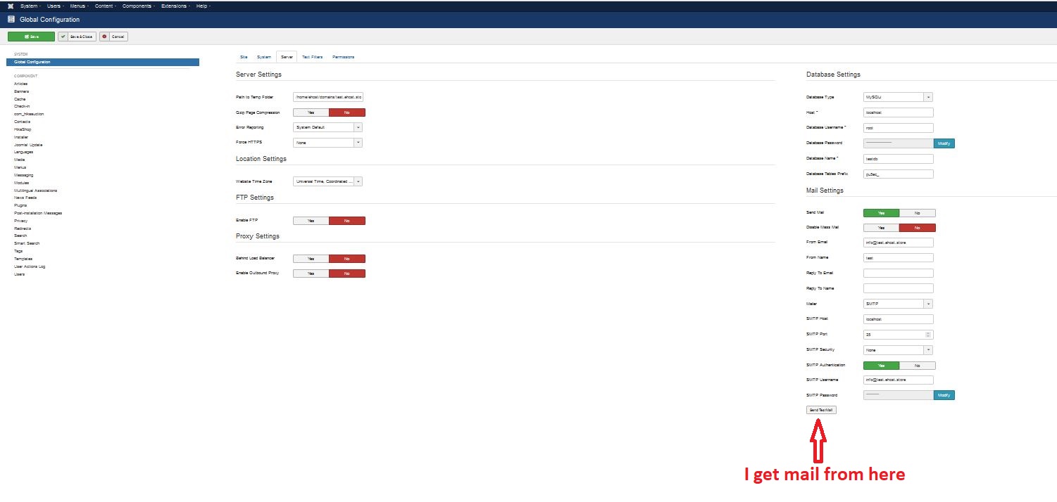

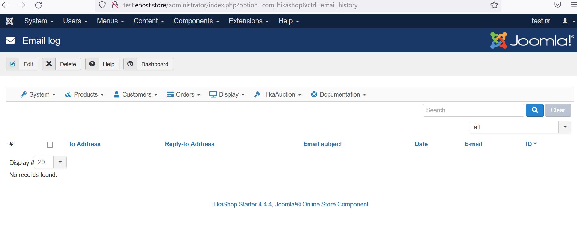

4 years 10 months ago - 4 years 10 months ago #337574 by ehsan.mohammadi
I'm using a Linux server and I did the settings exactly as you said Cron ist install, hikashop -> Email notification ist on, Customers -> Email-history ist empty, SMTP is adjusted and sends test email! , but the system does not send any emails.
You can see some screenshots in the attachment.
Kind regards
Ehsan

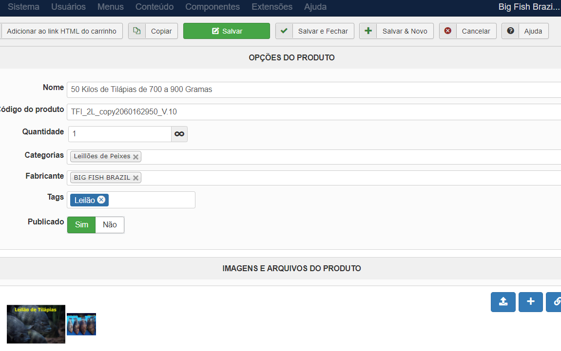

4 years 7 months ago - 4 years 7 months ago #339853 by eneasneto
Replied by eneasneto on topic Emails notifications
Hi! Greetings again, answering that:
I use Rochen Servers, the best for joomla
1. Joomla! version 3.10.6 is the current version. Your website is up-to-date.
2. I added the Cron job too at server
The Interesting Part:
3. Using this page: bigfishbrazil.com.br/shop/index.php?opti...ron&task=executeCron I receive that error message:
3.1 1146 Table 'jpvicsuj_joom217.#__hikamarket_vendor' doesn't exist
But the vendor is there: prnt.sc/3qU6XpWg18Oc
What shoul'd I do? Please...
Last edit: 4 years 7 months ago by eneasneto.
More

4 years 7 months ago #339855 by nicolas
Replied by nicolas on topic Emails notifications
This indicates that some of your products with the auction mode activated have a vendor id linked to them even though you don't have HikaMarket Multivendor installed on your website.
This shouldn't happen normally.
What you can do is to go in the menu System>Mass actions of HikaShop and create a new mass action. There, select the data type "product" and add an action "update the values" with the "product_vendor_id" column selected, the mode "int" and the value 0
Finally, press on the "process" button and it will remove any potential link to vendors in your products.
That should prevent that error message when the cron is being run and thus it should allow the emails to flow.
