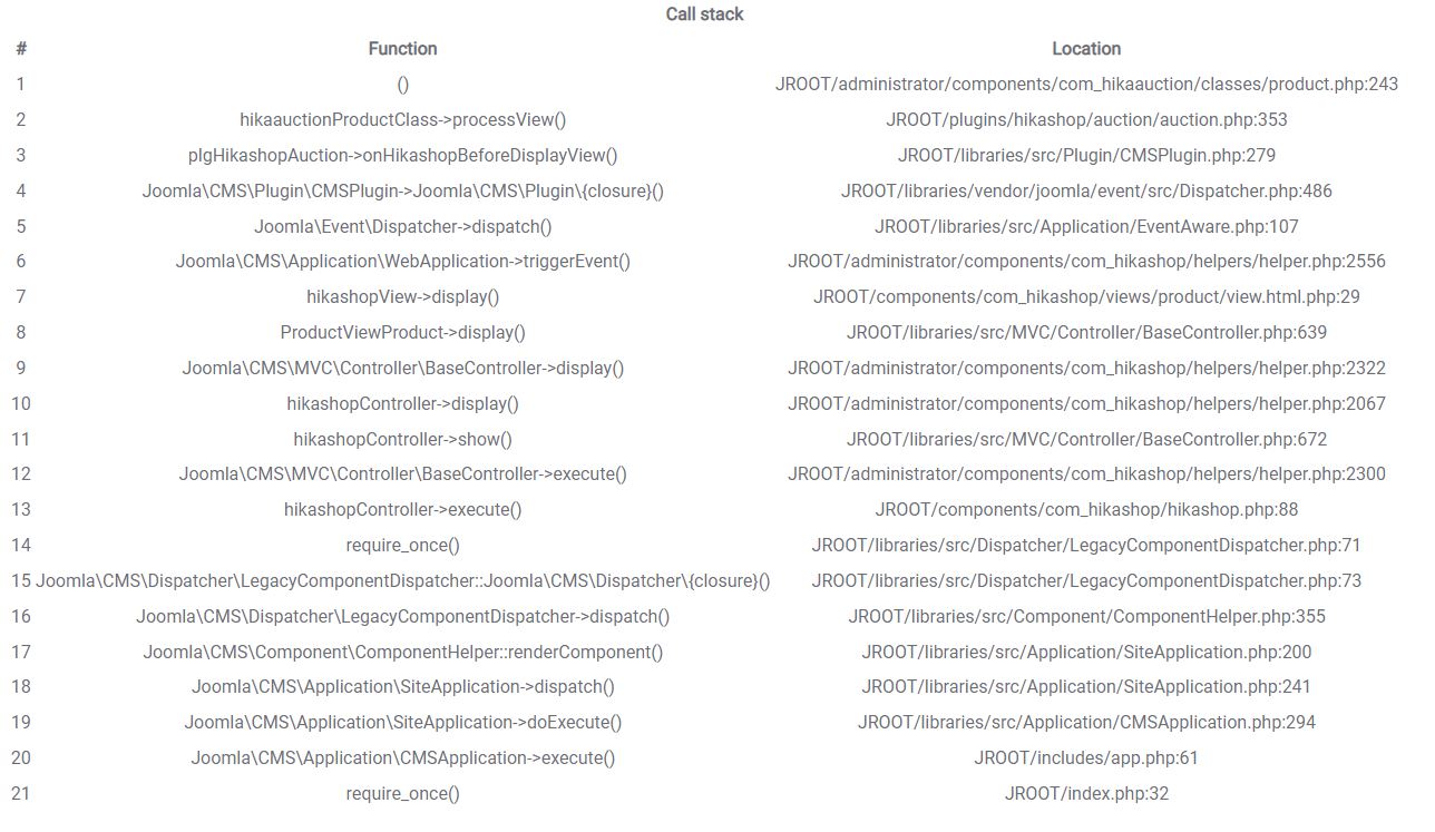

-- Error-message(debug-mod must be tuned on) -- : Call to a member function getUsersWithMaxBid() on null
I just migrated my website to Joomla 4 and have set PHP to 8.1.
In the backend all goes well but on the frontend when I call one of the finished auctions I get an error.
Hope this can be solved. Should you require login details please let me know.

3 years 8 months ago - 3 years 8 months ago #349053
by Philip
Replied by Philip on topic Problem after migration and PHP update
Last edit: 3 years 8 months ago by Philip.
3 years 8 months ago #349071
by chaldama
Replied by chaldama on topic Problem after migration and PHP update
