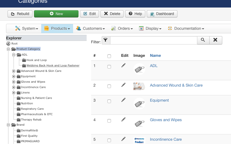

Categories -> Hook and Loop,Webbing Back Hook and Loop Fastener
Instead of creating a category tree like:
ADL
- Hook and Loop
-- Webbing Back Hook and Loop Fastener
The import creates categories like:
ADL
- Hook and Loop
Per the doc, HIKA shows it should create nested sub-categories?
As for the auto creation of subcat->subcat vs cat,cat, we have not gotten that problem worked out per this thread.
www.hikashop.com/forum/import-export-csv...s-at-all.html#228614
We've tried commas and semi-colons in the categories field like this.
Parent_category -> ADL
ADL
- Hook and Loop
ADL
- Hook and Loop
10 years 9 months ago #228748
by nicolas
Replied by nicolas on topic Import not working for us at all........
Your CSV is just wrong I suppose.
It should be like that:
product_code;parent_category;categories
code of a product in the category hook and loop;ADL;Hook and Loop
code of a product in the category webbing back...;Hook and Loop;Webbing Back Hook and Loop Fastener
