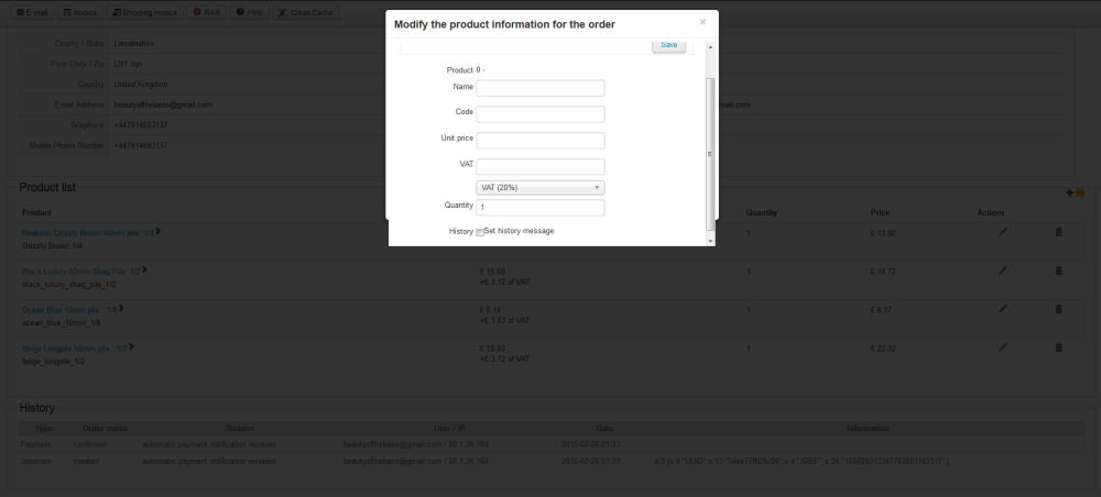

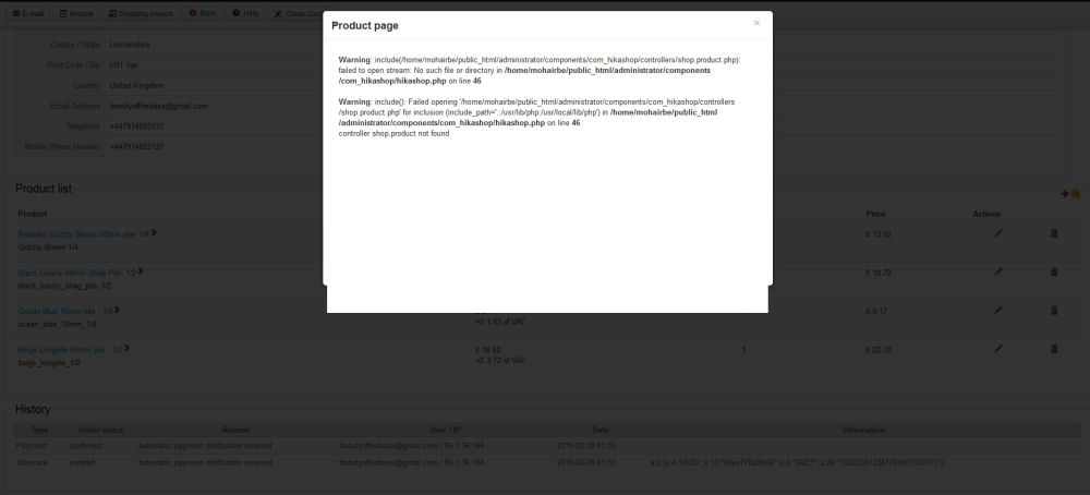

Also, i was testing your demo Hikashop. On demo site, i can easily change order status and let customer know by email.
In my hikashop its different. When i choose change order, pop up will appear and i can see my website in pop up window. Not order status option:
ctrlv.cz/shots/2015/02/25/h313.png
and popup:
ctrlv.cz/shots/2015/02/25/UASv.png
I cant change order status.
Please help me. Thank you very much.
