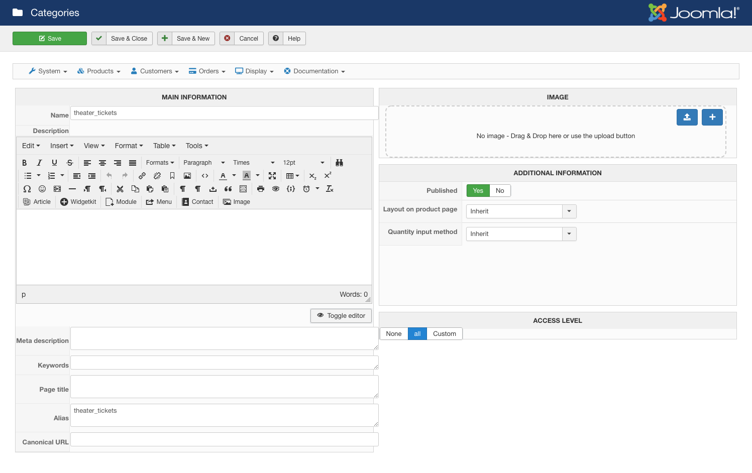

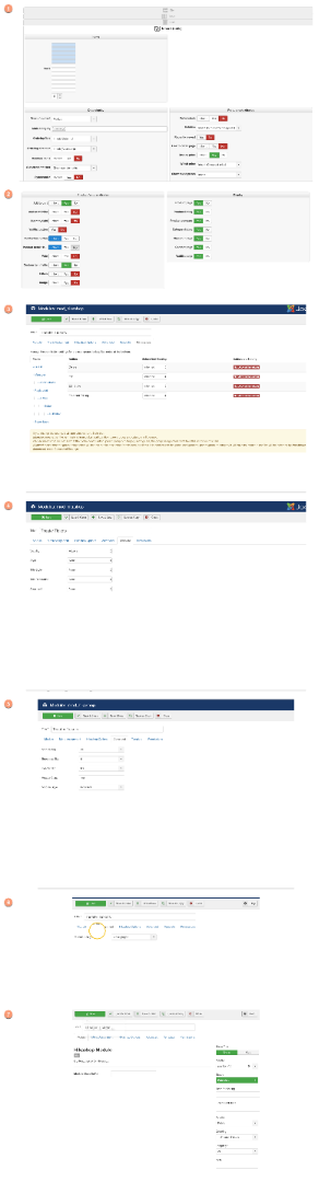

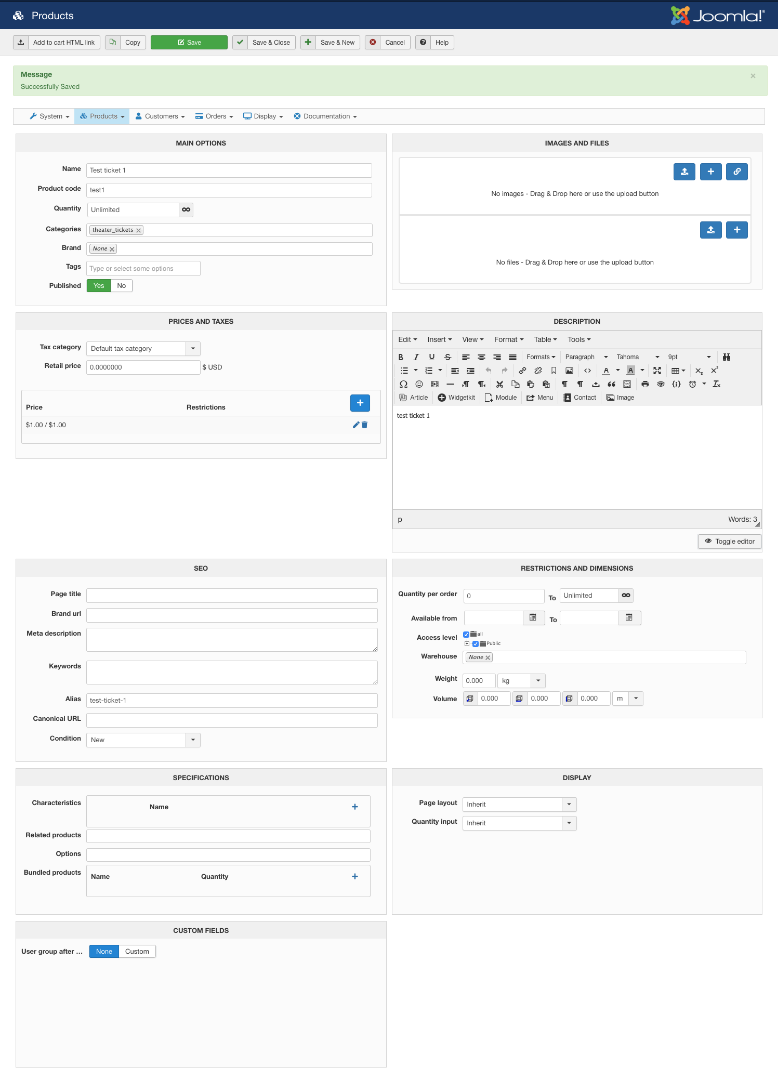

  • Posts: 50
6 years 8 months ago #313679
I'm attaching category and product listing. I have a feeling that may not be exactly what you asked for, if that's the case please let me know.
  • Posts: 86081
  • Thank you received: 14189
6 years 8 months ago #313703
No, I mean:
go in the Joomla modules manager, edit the settings of the module that you're using to display the listing, and provide a screenshot of the settings in the different tabs there, especially the "hikashop options" tab.
