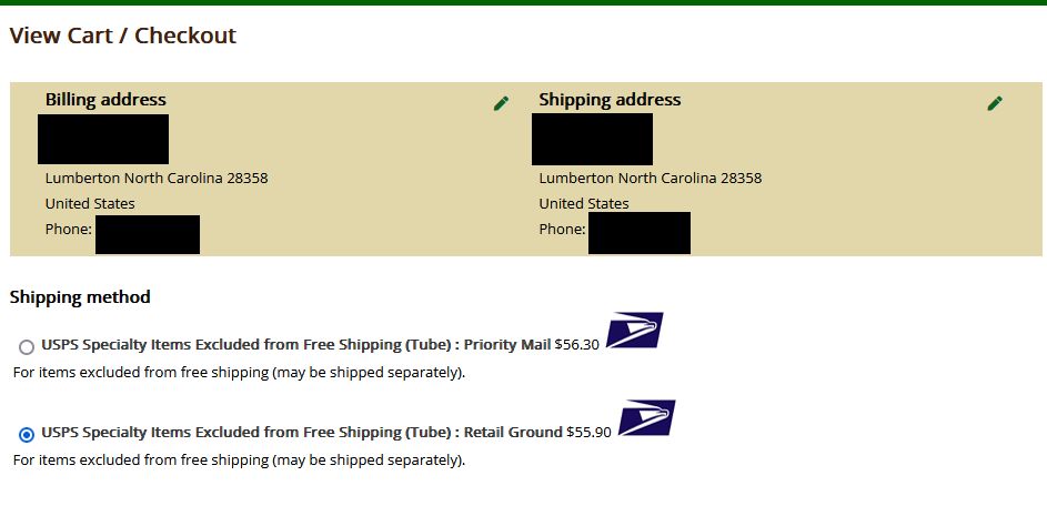

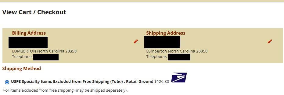

4 years 6 months ago #341083 by jazzmang
Sorry I got distracted and didn't hit send immediately on my prior post.
I think I see what happened; I forgot to re-check the retail ground option on the main site.
However, I re-tested. After your debug code, I got a completely different and wrong price (~$250).
I tested the other site, and it works fine (using the workaround).
I also included a screenshot of increasing the length to 57 inches on the other site.
Could something in your debug code cause making it double?

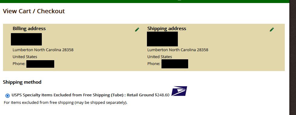

4 years 6 months ago #341084 by jazzmang
Also, even the workaround is now wrong on the main site.

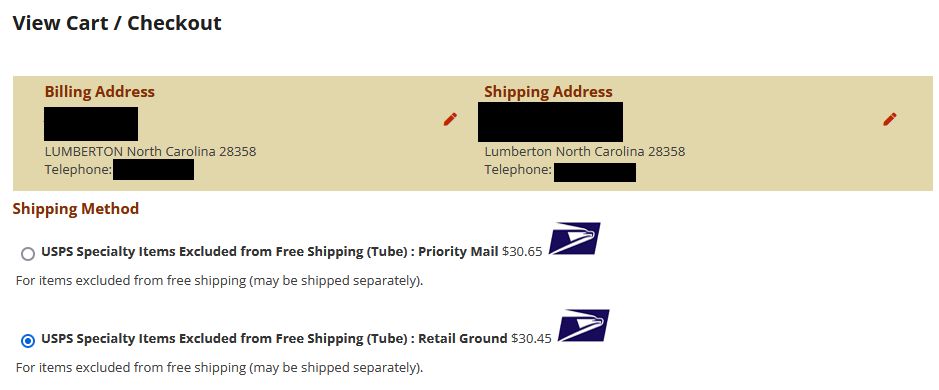

I've made a patch in the plugin and uploaded a new version of the plugin on your website.
I then run a test and I got both "Priority Mail $30.65" and "Retail Ground $30.45" which sounds much better.
If we remove the $5 surplus you had added to the shipping mehtod, we should get the exact shipping fee provided on USPS's calculator tool.
Please check on your end whether it fixes the issue and doesn't create other side effects.
More
4 years 6 months ago #341106 by jazzmang
Yes, that looks like it is working as expected.
Can we get the code update so we can get this working on the other site as well?
