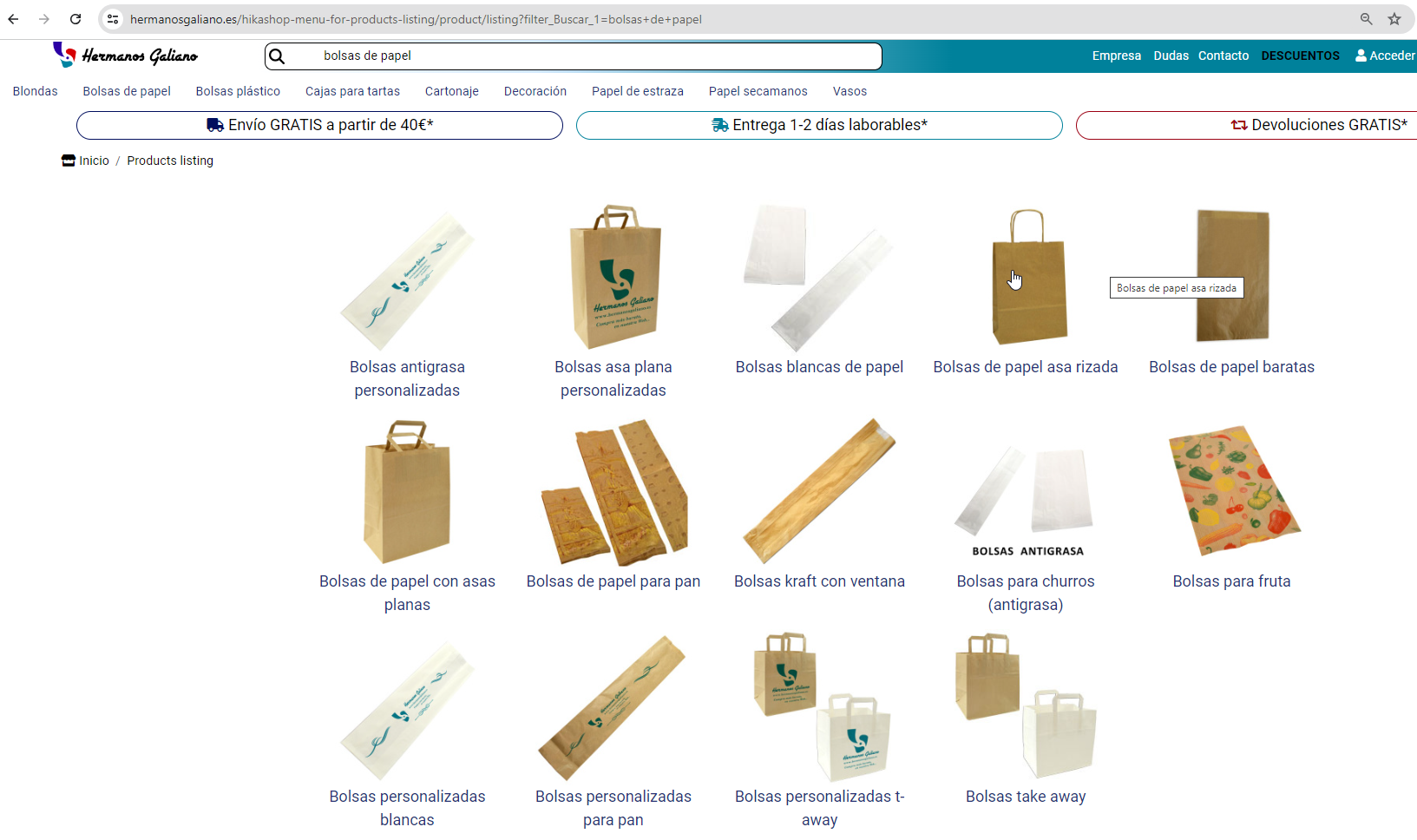

I mean that when you do a search on Google there are ecommerce that have the search urls of their own site positioned.
It's like I want to position this url (for the search intent "bolsas de papel"):
www.hermanosgaliano.es/hikashop-menu-for...ar_1=bolsas+de+papel

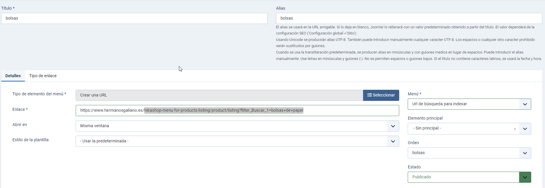

2 years 3 months ago #361828 by nicolas
Replied by nicolas on topic Index search urls
If you get a 404 error, then it means that the URL you provided in the settings of the menu item is wrong.
Can you confirm that you provided a valid URL ?
Could you provide a screenshot of the settings of the menu item ?

2 years 3 months ago #361840 by Reincidente
Replied by Reincidente on topic Index search urls
I attach the screenshot.
Apart from the complete url with the htttps:// (as recommended by joomla), I have also tested the part of the url behind the domain:
hikashop-menu-for-products-listing/product/listing?filter_Buscar_1=bolsas+de+papel
It is a search url for some Hikashop products.
I also put the screenshot with the result on the screen of the url

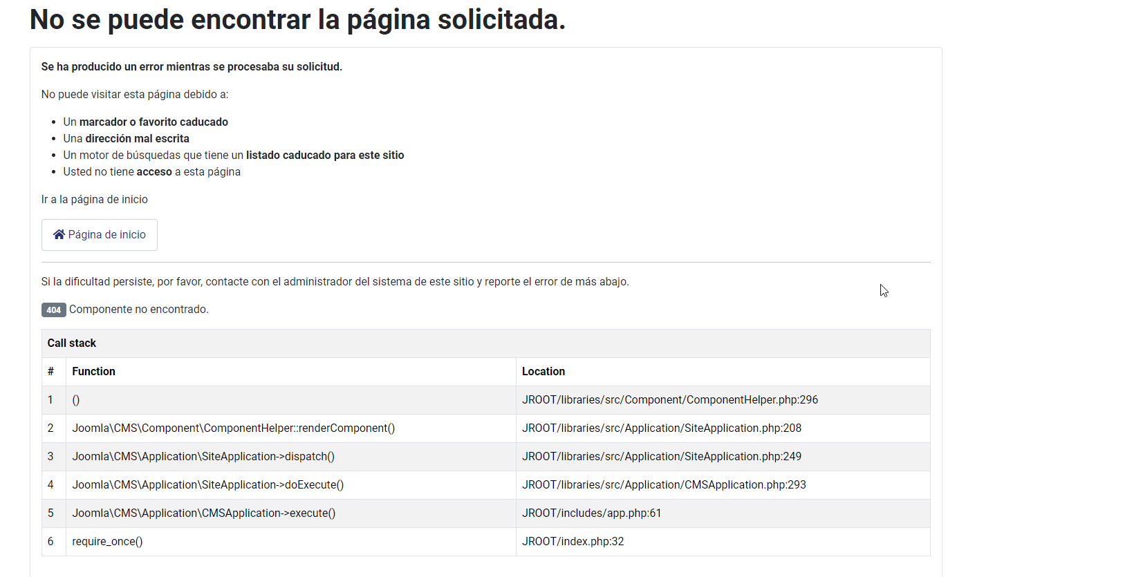

2 years 3 months ago #361878 by Reincidente
Hi Nicolas.
I attach a screenshot with the "error" messages that appear with debug activated
More

2 years 3 months ago #361881 by Reincidente
Sorry!!
