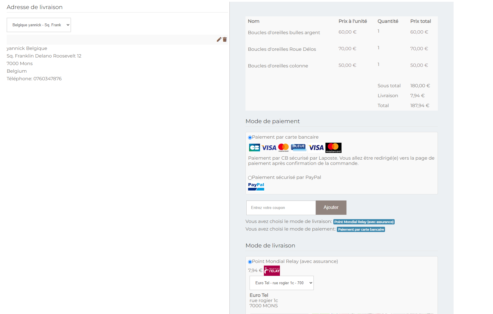

when i set a france address i see all shipping
when i set belgium address i see mondial realy shipping

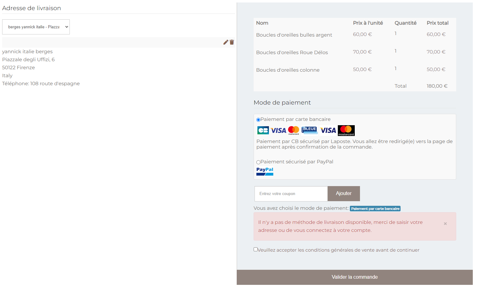

when i set an italian, german, potugal addres no shipping !!!
i don't understand why ??

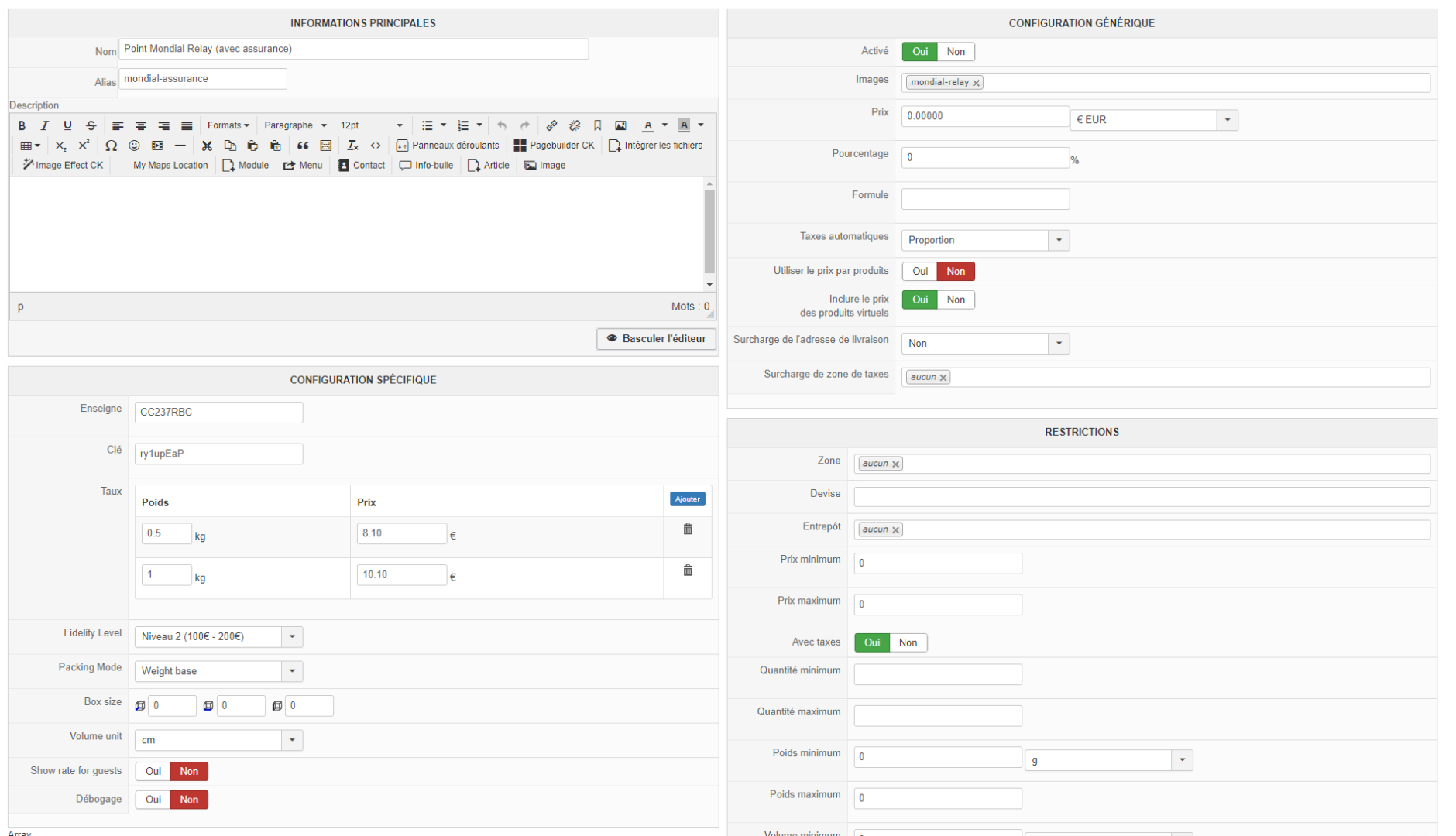

2 years 2 months ago #363035 by nicolas
I have no other idea. Could you provide a screenshot of the settings of the shipping method ?

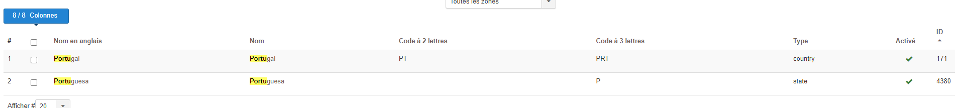

Can you confirm that you have "IT" and "PT" for the Italy and Portugal country zones in the 2 letters code field of these zones in the System>Zones menu ?
2 years 2 months ago #363039 by c-line
here all configurations
En mode commande
belgique
italie
2 years 2 months ago #363042 by nicolas
The settings look fine. So I don't see anything else.
