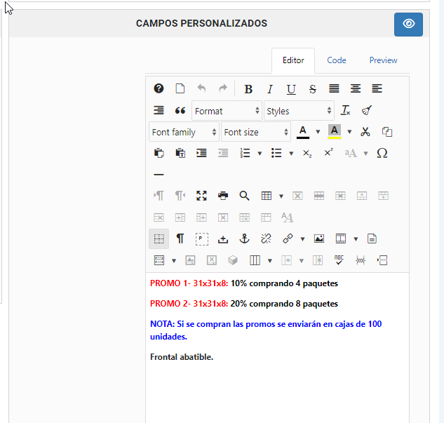

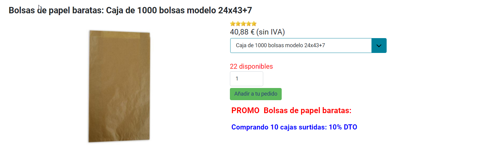

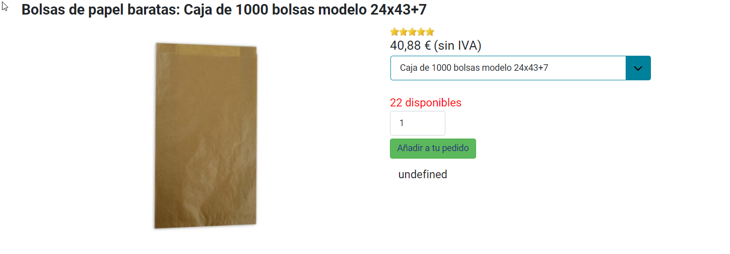

Many times I encounter an issue (I believe it usually happens after making some changes in the description or on the product page, although this is more of an assumption than a certainty): randomly, in the custom field of some feature, the word UNDEFINED appears, completely removing the original text that I had entered and that should normally be displayed.
I’m attaching two screenshots so you can see the original and the one showing the error.
Would you know why this happens or how to avoid it?

Could it be that you have a mass action which has this custom field configured somewhere ?
How is your custom field configured ? Could you provide a screenshot of its settings ?
Could it be that you're using a "WYSIWYG" type custom field ? Maybe the editor you're using was not able to load on the page and thus, when you saved, it couldn't provide the text and thus it returned "undefined" ? Try to switch to a textarea type custom field to see if you still have the issue. If you don't get the issue anymore, maybe switch to another editor, or event stick to the textarea type ?

Nicolas, by default I have the same configuration in all the custom fields. I’m sending you screenshots of one of the items that were affected, in case it helps. Please note that there is no bulk action configured for the custom fields.

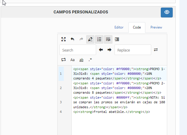

Nicolas, I have changed the specifications to 'text area'. I see that I now have to use HTML code, but it doesn’t allow me to preview it.
Is there a way to enable the preview?
