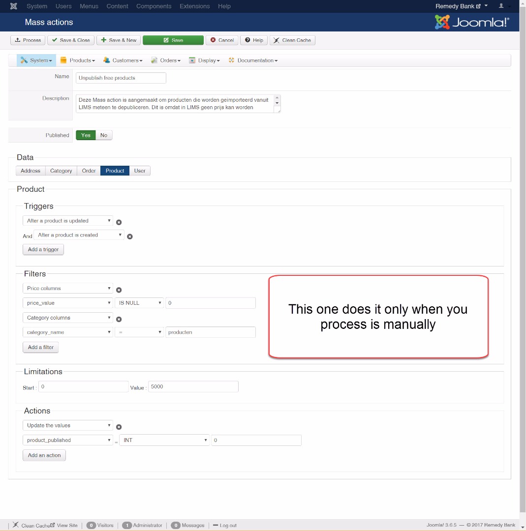

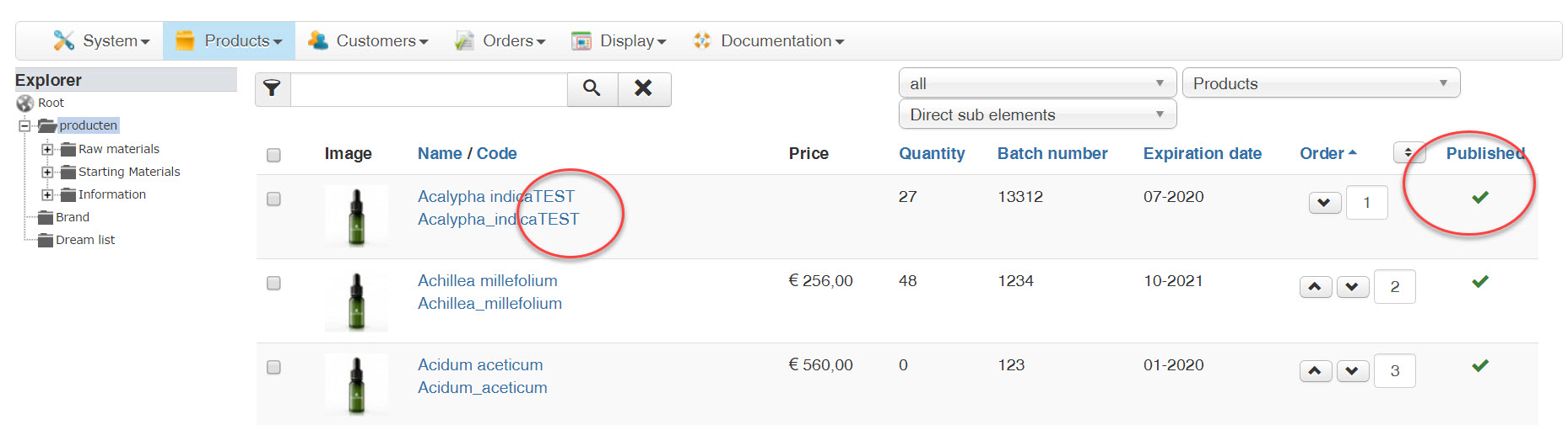

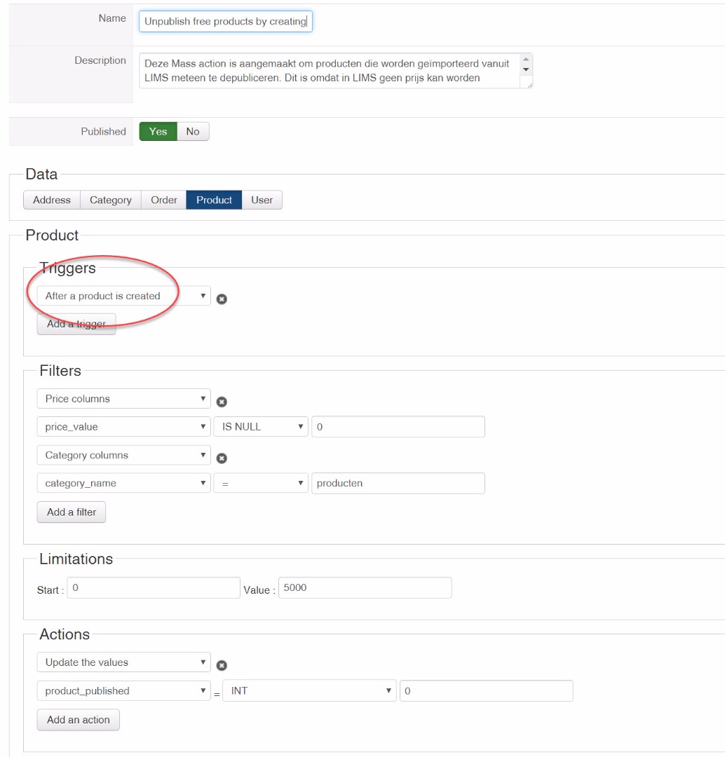

I have created two mass action which only works when you trigger (process) it manually.
The action is to unpublish products whose value is 0.
So it's a simple to check if it's working if you change the productname. Then you do a update but the product is still published when there is no price available.
Hope you can help me.

See configuration:

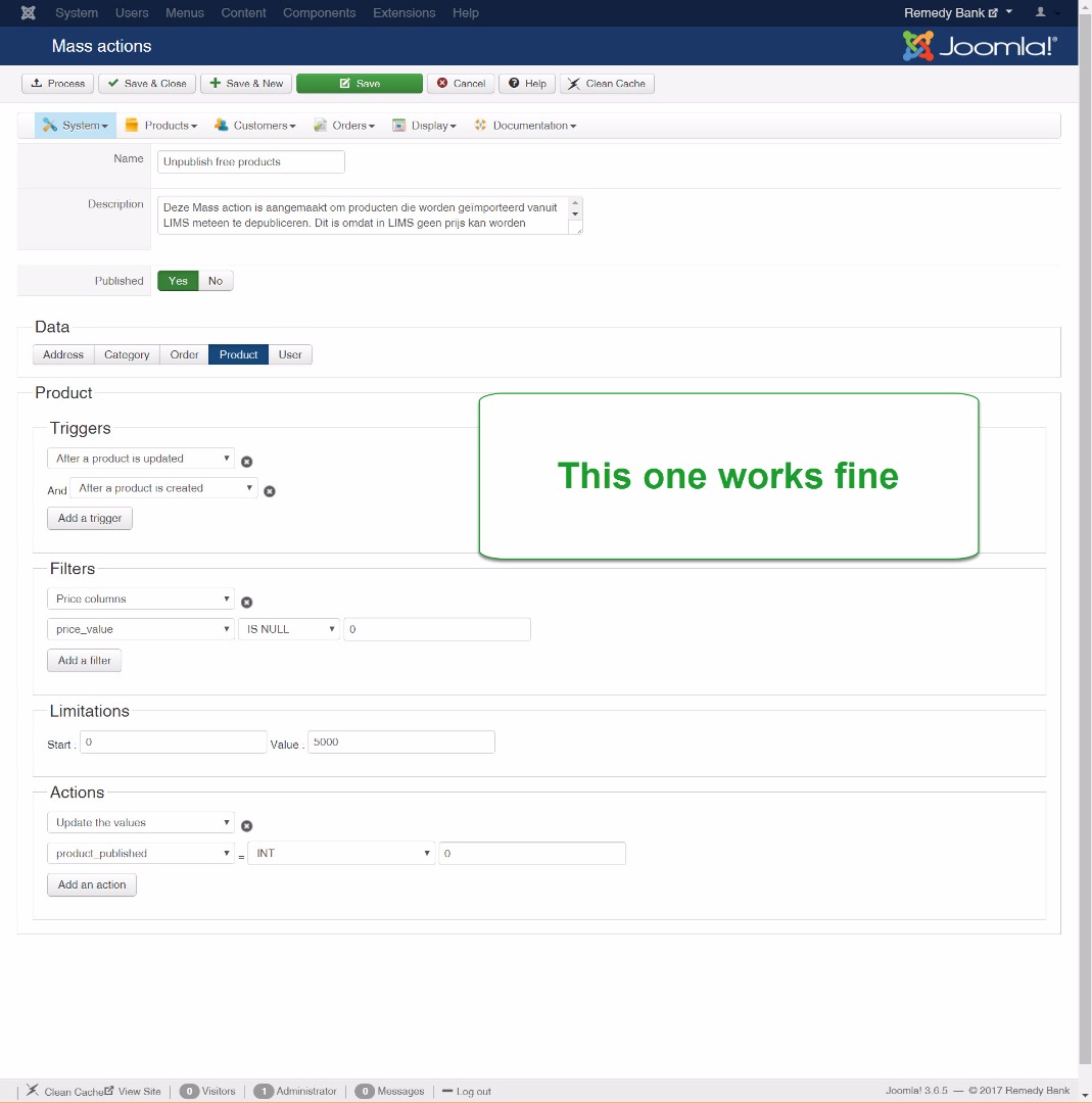

I have this issue also in 2.6.4 and 3.0.0 so you are correct that there is no difference.

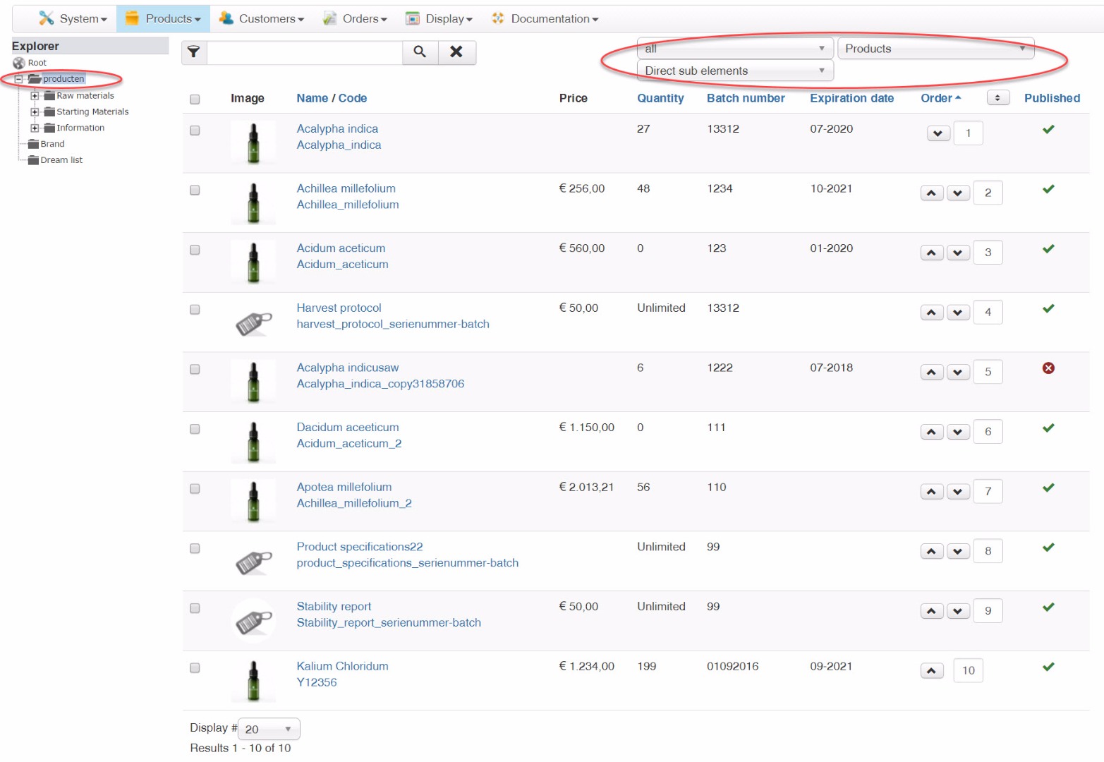

By coincidence I found out that is issue has to do with the Filters.
When I use one filter it works fine, but with the second filter on it doesn't work anymore.
See screenprint:
I have tried the name and also the ID but none of the options works
After updating the NAME, the product is still Published. Also after I cleared the cash.
When I do a manual Mass Action it works fine!
Kind regards,

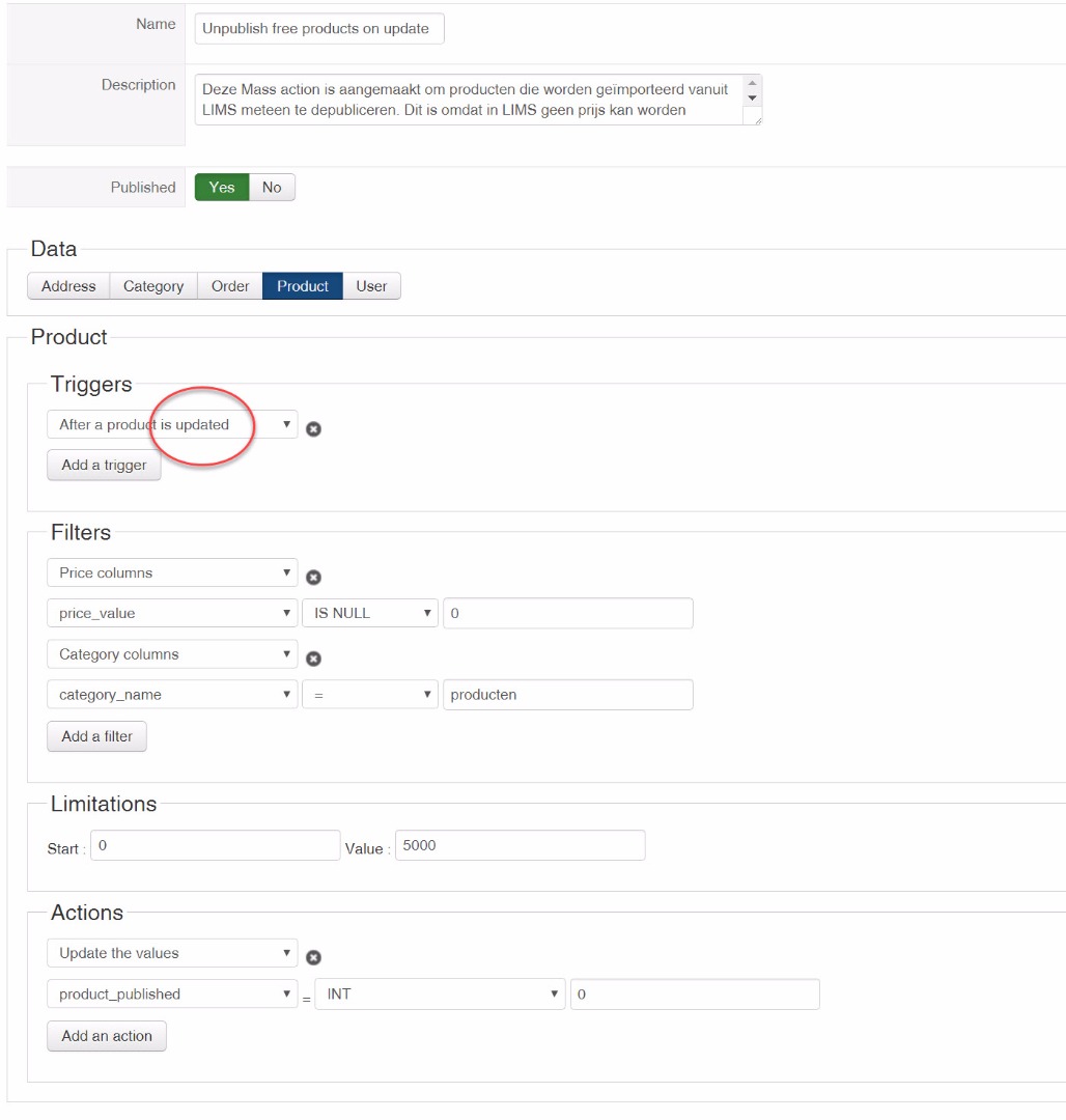

9 years 8 months ago #262146 by Philip
Can you provide 2 Filters configuration screenshots (worked and non-worked).
Please note that your provided access didn't work for access backend.
Awaiting news from you

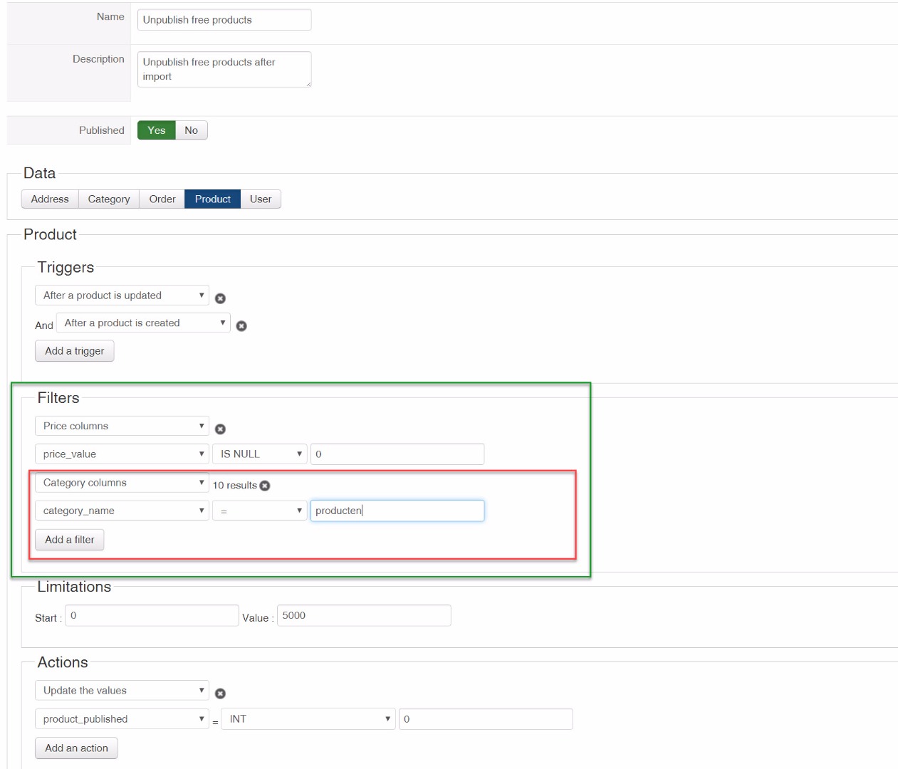

9 years 8 months ago - 9 years 7 months ago #262293 by Lumiga
Hi Philip,
Here the two screenshots.
Kind regards,
Lumiga

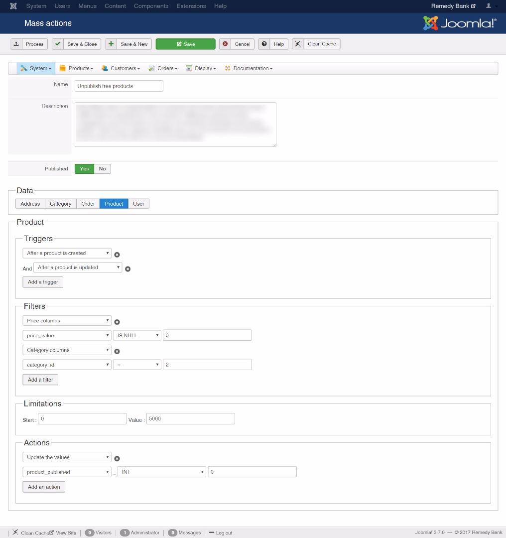

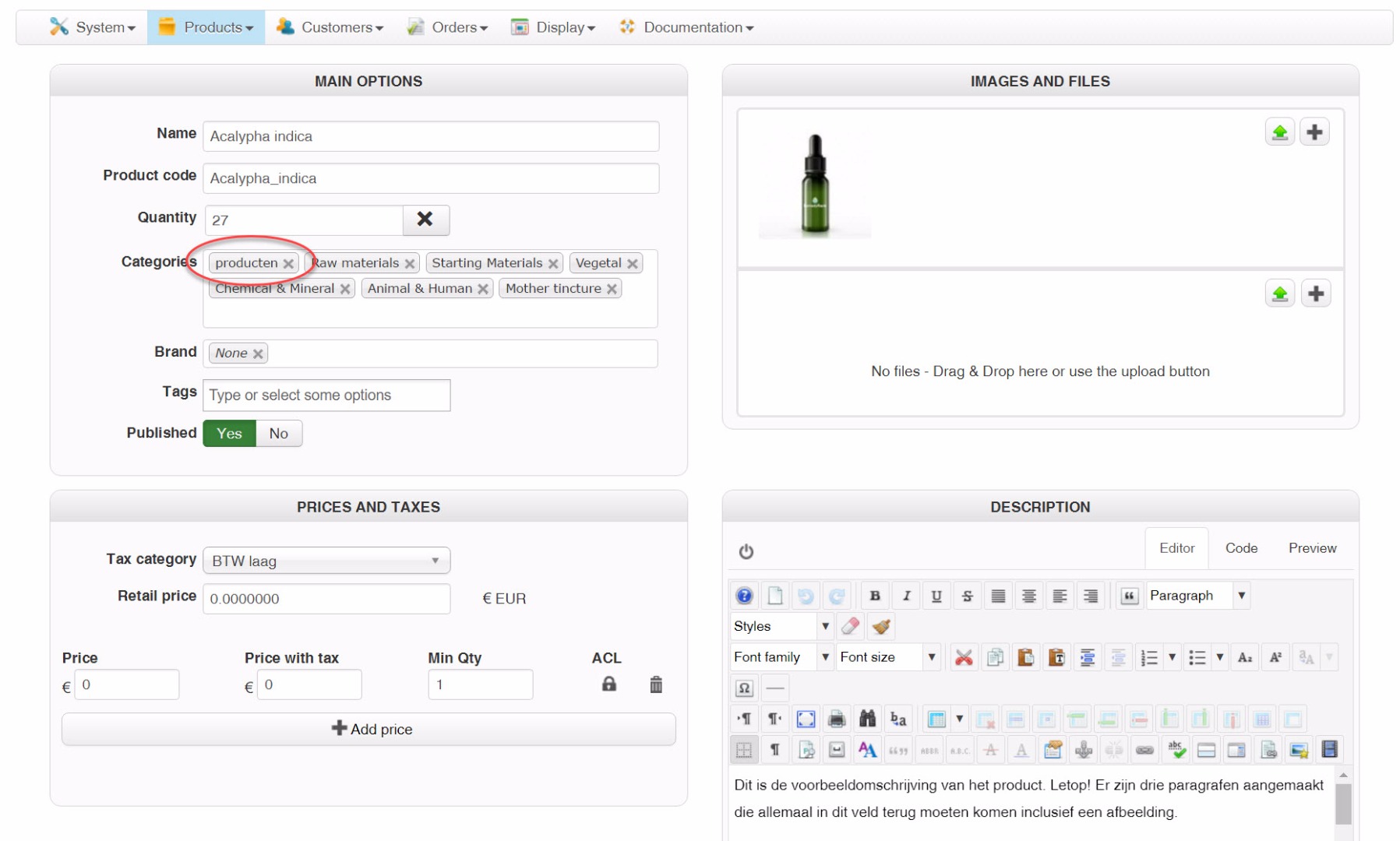

9 years 5 months ago #269133 by nicolas
Try to change the mass action to use the "category_id" equal to the id of the category instead of use the category_name.
It might be that the category_name is not loaded in some cases which could explain why it doesn't in some cases. But the category_id should always be ok.
More
9 years 5 months ago #269201 by Lumiga
Unfortunately, it did not have any effect to Change the mass action to use the "category_id" equal to the id of the category instead of use the category_name.
I get exactly the same issue with this configuration.
