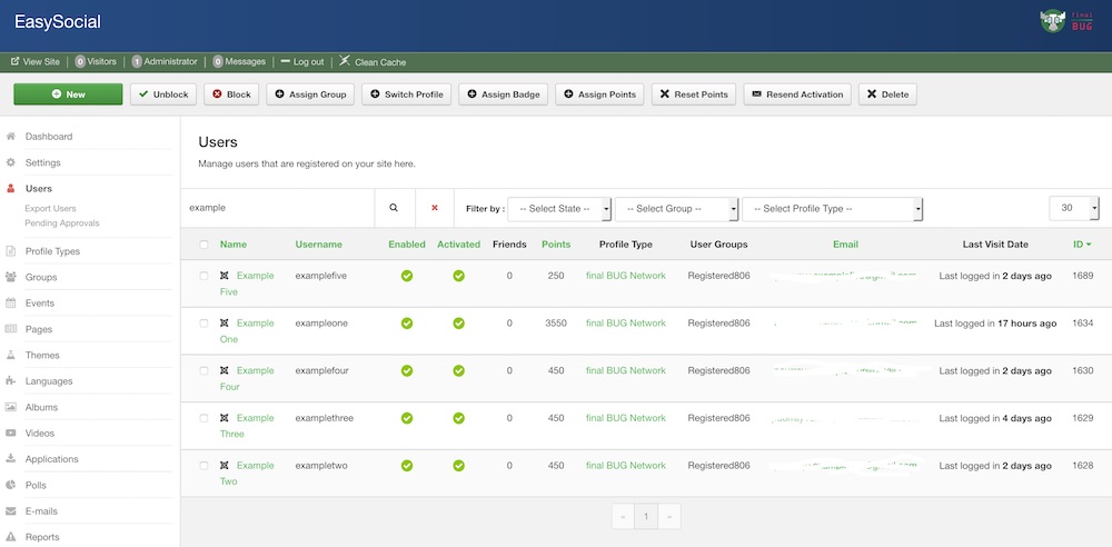

9 years 6 months ago #264756
b. That app allows you to change the profile type based on the points. If the "profile type" is what you meant by "EasySocial group", then yes. Otherwise, no, that's something else. I would recommend to check with StackIdeas as I'm not familiar with it.
c. Well, there is no action "add to EasySocial user group". There is an action "add to Joomla user group", but it won't help.
Adding such action could be interesting, but it still requires development, like with point a.

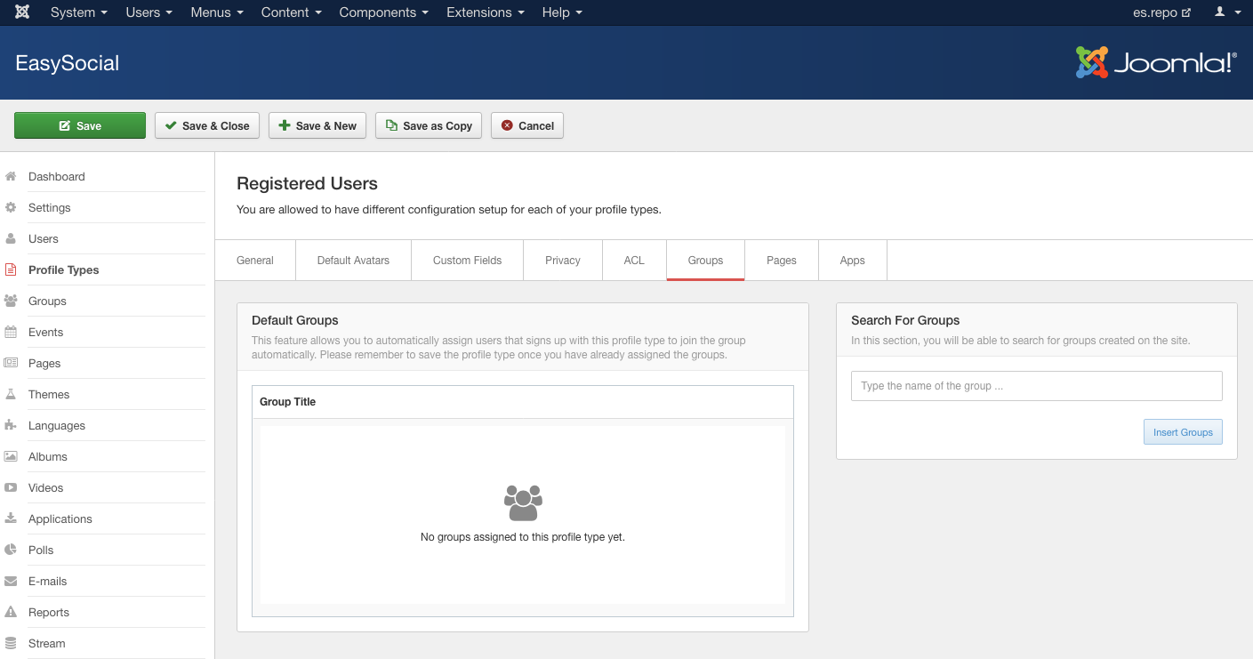

9 years 5 months ago #264773
Hi, hi
My question from the comments section:
stackideas.com/blog/profile-unlocker-app
Paul Murray
Please correct me if I am wrong but it is possible to associated a particular “ES Group” with a particular “Profiles Types”
e.g. user profile ABC is associated with group 123
e.g. user profile DEF is associated with group 456
e.g. user profile GHI is associated with group 789
The answer from the developer:
Jean-Marc Burri
In short yes.
You can define which groups are assigned to a profile when a user achieves a new profile through earning points he will get reassigned to a new profile which has/can have different groups assigned.
I think what this means with respect to Hika & Co is:
a) Award a user eg 1000 points for buying a product
b) Use the Profile Unlocker App to upgrade there profile
c) As part of there new profile put them in a new “EASY SOCIAL” Group.
In my case I am selling webinars:
a) Buy a course
b) Become a Student with fro e.g. a Basic Student Profile
c) Thus have access to an “EASY SOCIAL” Basic Study group
I believe that it will work!?! :blink:
It just seems to be a lot of money for a some thing that does one thing.
It is like buying “Thunderbolt to Gigabit Ethernet Adapter” so that I have the luxury of connecting my Mac to World Wide Web :unsure:
Whilst I believe it would work for me I am not sure how it would work for other people…
There is a pages Tab on the screen shot so many it would work similarly?
@ Eileen maybe you could put an Event in a Group or Page and get it to work like this!?!
The irony is that I actually have an insane Moodle/Easy Social integration with Joomlde.
Joomdle is integrated with Hika shop and lets me put buyers in “EASY SOCIAL” Groups.
Whilst it works...
...it is like flying from Berlin to Amsterdam via Beijing!
And I have decided that I just do not have the nerve to do this on an ongoing basis!

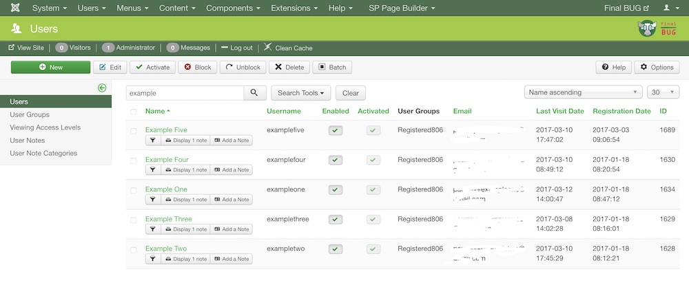

  • Posts: 6
9 years 5 months ago #264798
@Paul, the method you describe appears feasible but only practicle when it is presumed a need only for 1 or 2 groups. However, in the Multivendor Hikashop the idea for some (such as me) would be to allow my site users to create their own paid-access EasySocial groups where the EasySocial group has some value to end-users (i.e., it supports a real-life provision of services or there is certain content accessible from within the EasySocial group). In that case the end-user of the Hikashop capability is the EasySocial member who has created their own EasySocial Group or Event and wishes to provide paid-access to that group. In your case, it would appear the end-user of the Hikashop capability is just the site administrator.
@Nicolas, thank you for carrying the conversation over to the EasySocial developers. I believe this would satisfy the needs of many users looking to monetize their social sites and/or extend the products/services they offer users..

  • Posts: 86112
  • Thank you received: 14210
9 years 5 months ago #264815
@Eileen : Indeed, an integration would be necessary to be able to cover that.
@paurray : The fact that users are synchronized between extensions and Joomla is a great thing which simplifies a lot of things. If EasySocial were using normal Joomla user groups, then the mass actions would be a great way to do such things.
But if the extension has its own group, then it requires a specific integration, there's no way around that unfortunately. And also, since each extension having its own user groups implements that differently, it requires a different integration for each one.
