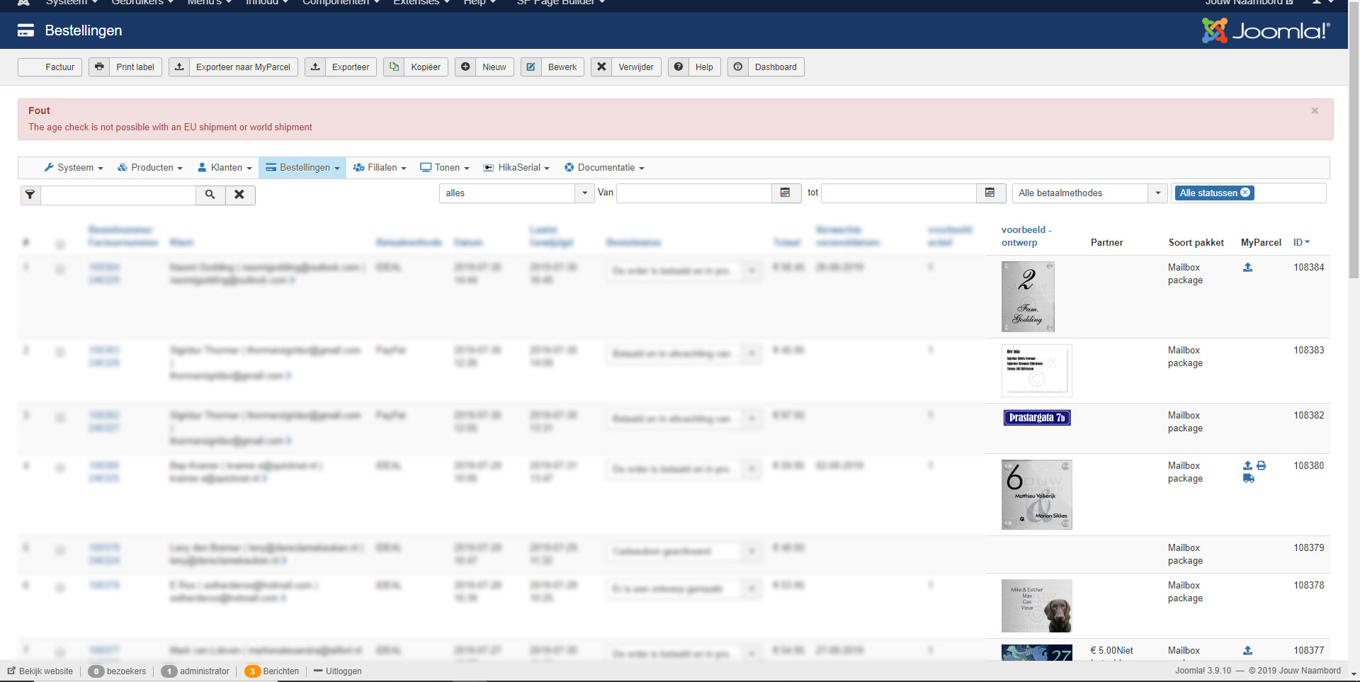

In the MyParcel plugin I found a little bug. When exporting an order with a foreign address to MyParcel I get this errormessage. See screenshot.

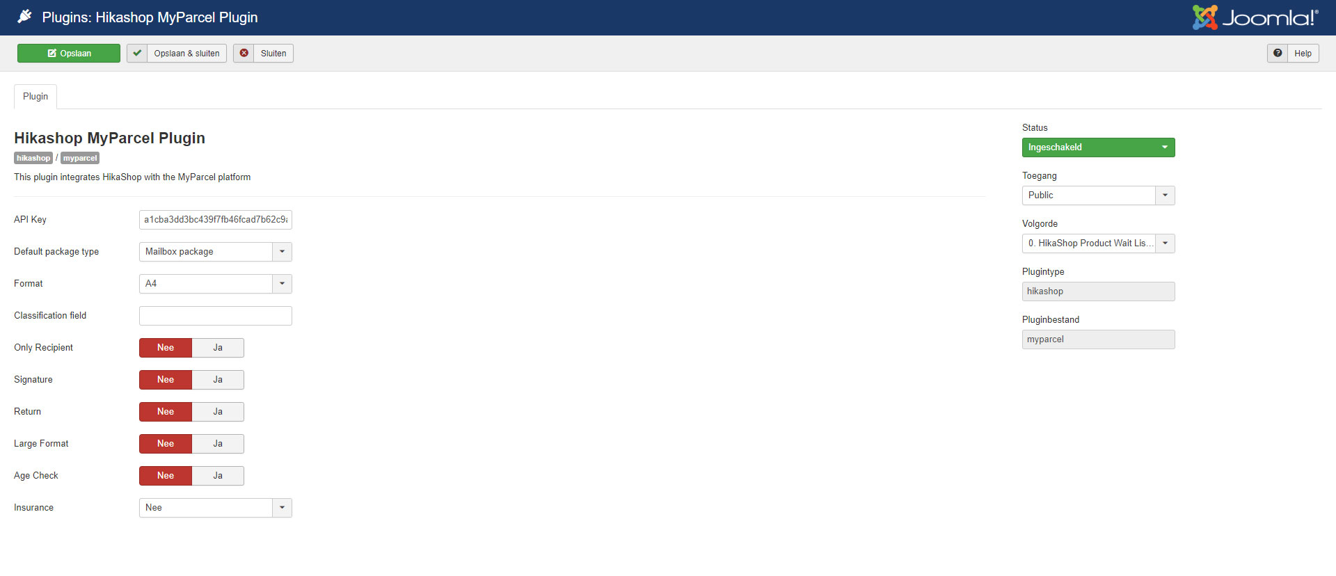

I added a screenshot and as you can see there it is deactivated?
7 years 2 months ago #309375
by nicolas
Replied by nicolas on topic MyParcel plugin error
Then add the line:
before the line:
in the code of the plugin.
Then add the line:
Code:
if($order->shipping_address->address_country_code_2 == 'NL')
Code:
$consignment->setAgeCheck($this->plugin_options['age_check']);
- jouwnaambord.nl
