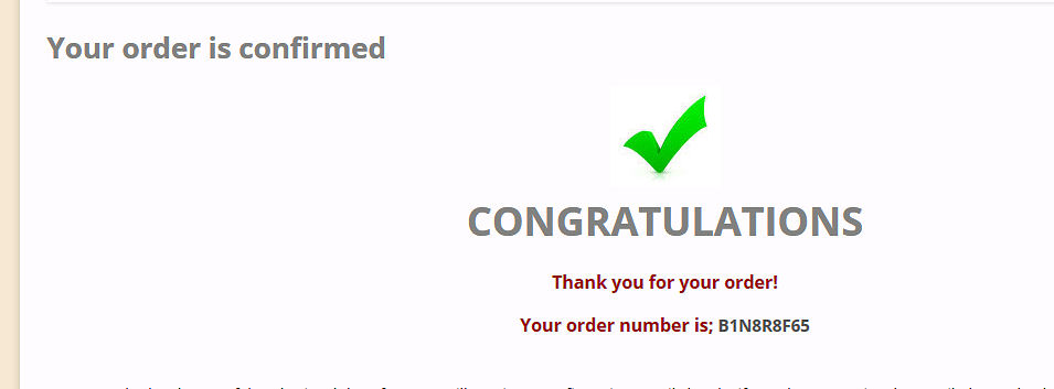

11 years 1 week ago #217219 by mohairbears
Hi Nicolas, Appreciate your comments and assistance.
Not being a programmer but a Hikashop user, I would not know what's in your remit or not, I was not advised to find assistance elsewhere for the information that I required to achieve my goal or else I would have done.
Anyway thank you for this as my goal has now been achieved.
