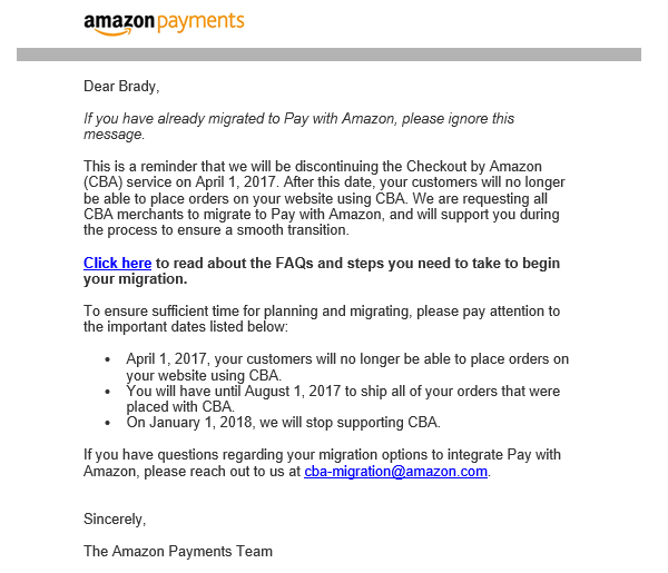

9 years 8 months ago #262369
by SolarMade
Replied by SolarMade on topic Checkout with Amazon plugin - debugging
Hello Hikashop team,
I wanted everyone to be aware that starting April 1st, 2017, "Checkout by Amazon" will no longer be supported and people will not be able to order through the website any longer. Amazon's new service is "Pay with Amazon".
Is the Hikashop team working on a new plug-in for "Pay with Amazon"?
During the last Amazon transition, our company helped with getting the plug-in going. We would be happy to do it again so we don't lose sales and customers. Please let me know.
Thank you,
Brady Thompson
Solar Made
Thank you,
Brady Thompson
Solar Made
