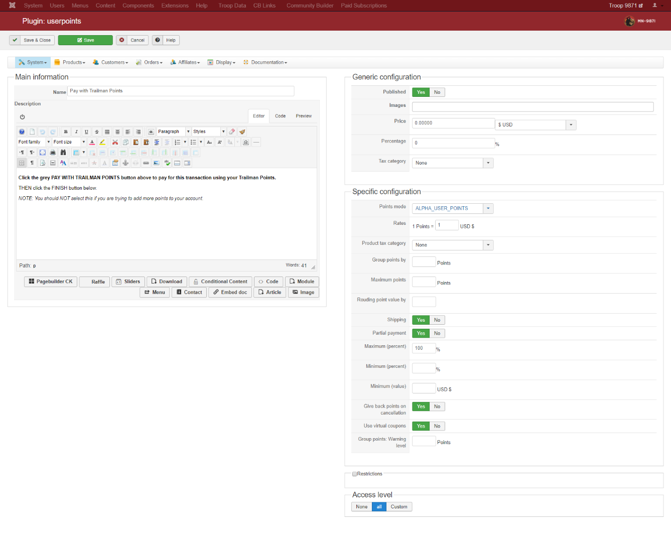

8 years 8 months ago #286020
Here are the screen shots of the settings
  • Posts: 26386
  • Thank you received: 4078
8 years 8 months ago #286086
I can see that you have activated the checkout "user points" block.
But you also have settings to ask the customer if he wants to use its points and by default the points are not used.
What would be interesting is to know if you have correctly added the block in your workflow and if you're using that block to ask for the usage of points.
At that moment you will see directly in the checkout cart ; long before the order creation ; if you will use points.
Since we do not have information or details regarding that points, we don't know if you see any discount ; we can't know if you're using points.
Because by default, it looks like the system is set-up to not use points ; so it would be logical that points are not used and deduced.

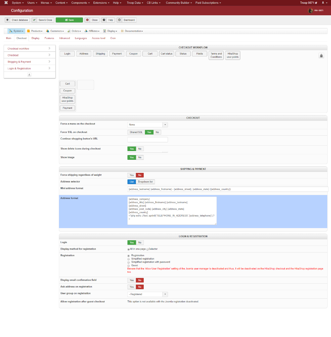

8 years 8 months ago #286100
The configurations there are set so that the points are not used 'by default' - the user must indicate that they want to use the points for them to be used.
The checkout flow is working properly.
You can see the checkout workflow in the attached configuration screen shot.

  • Posts: 196
  • Thank you received: 6
8 years 8 months ago #286101
Ooops forgot to attach the config screen shot

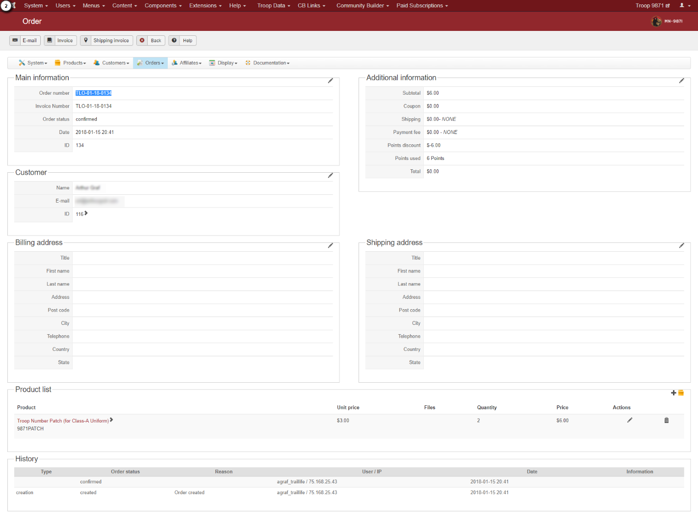

  • Posts: 196
8 years 7 months ago #286639
We presently have:
HikaShop Business 3.2.2 [1801150943]
Here's what is listed in the order_payment_params of an order that was place for $6 total an $6.00 points used:
O:8:"stdClass":1:{s:10:"userpoints";O:8:"stdClass":4:{s:10:"use_points";i:6;s:11:"earn_points";a:0:{}s:8:"use_mode";s:3:"aup";s:9:"give_back";b:1;}}
Attached is a screen shot of the order view from the admin-side of this order.

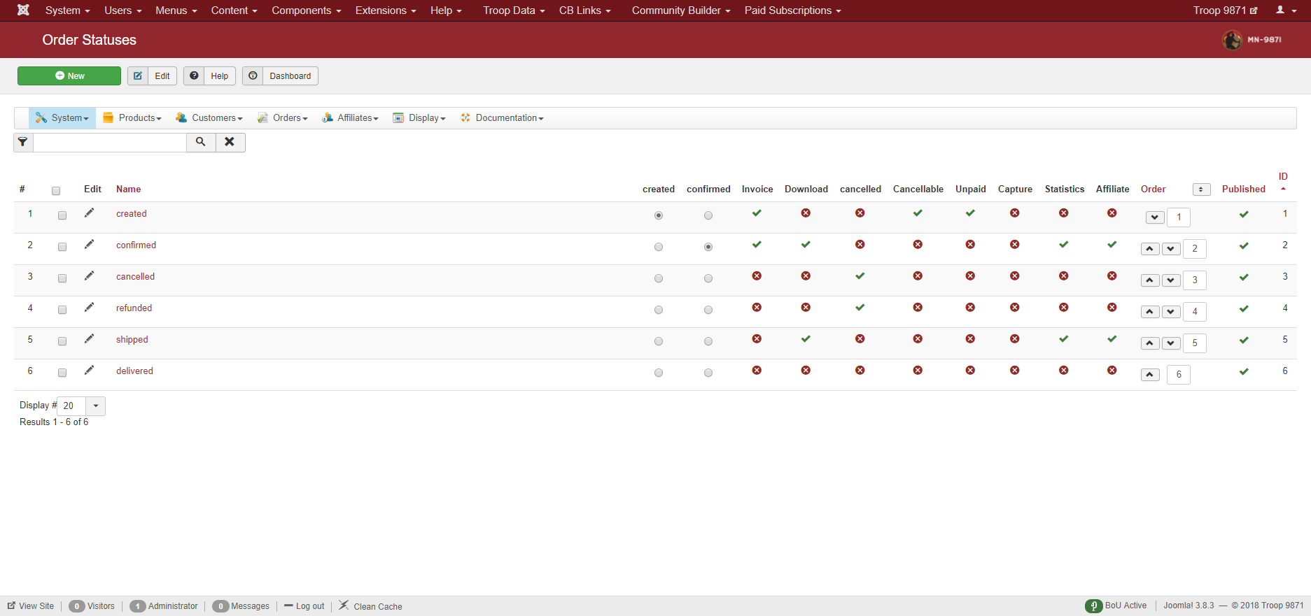

  • Posts: 196
8 years 7 months ago #286694

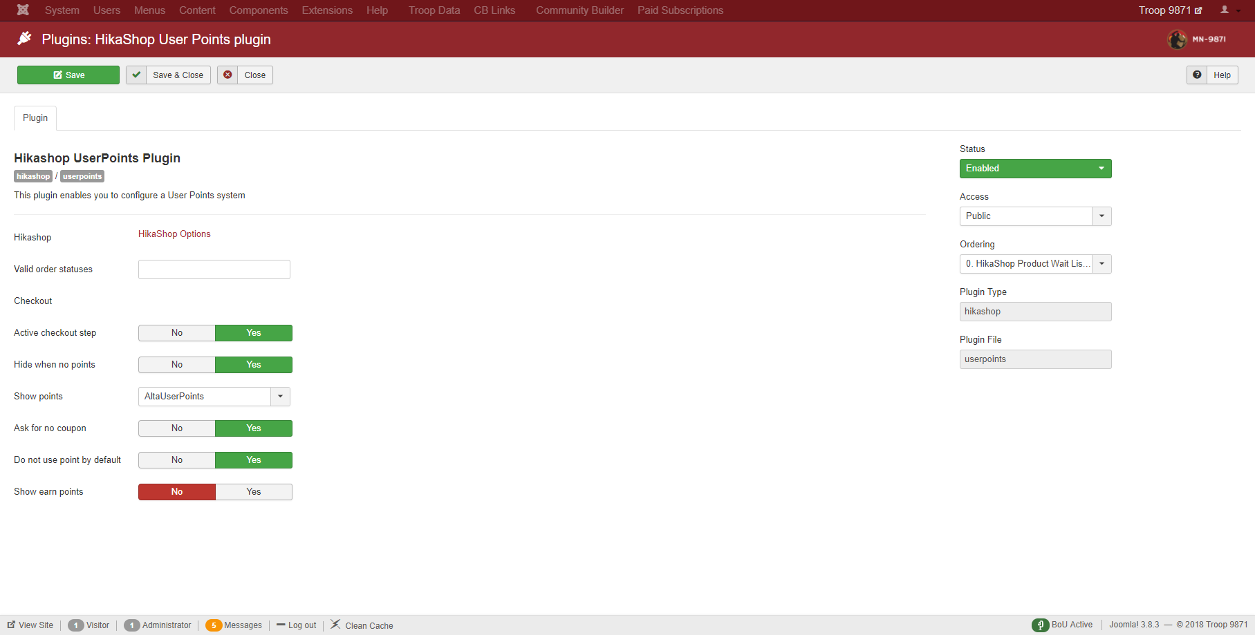

  • Posts: 86187
8 years 7 months ago #286825
I was talking about the settings of the user points plugin in the menu System>Plugins, not the settings of the payment user points method in the menu System>Payment methods.
Could you provide the correct screenshot please ?
  • Posts: 196
8 years 7 months ago #286826
Here it is

  • Posts: 26386
8 years 7 months ago #287186
I'm afraid that it's not possible to see anything with your screenshot since it's too small and it's all blurry.
So unfortunately, without it we can't go further.
Regarding your order status configuration ; you have some errors.
"created" should not be listed as an "invoice" order status ; but "shipped" and "delivered" must be (regarding what you said).
Since it looks like very difficult to get information from your configuration and you do not understand each time what we're talking about ; I can potentially have a look at your website. But as you will understand, the solution won't be solve this week.
You can provide us some admin access via the "contact us" form including an URL for that forum thread so the support team will understand what to do with the credentials.
If you can also provide order number that you used for your tests and maybe a front-end test account to perform a test ; it would be very helpful.

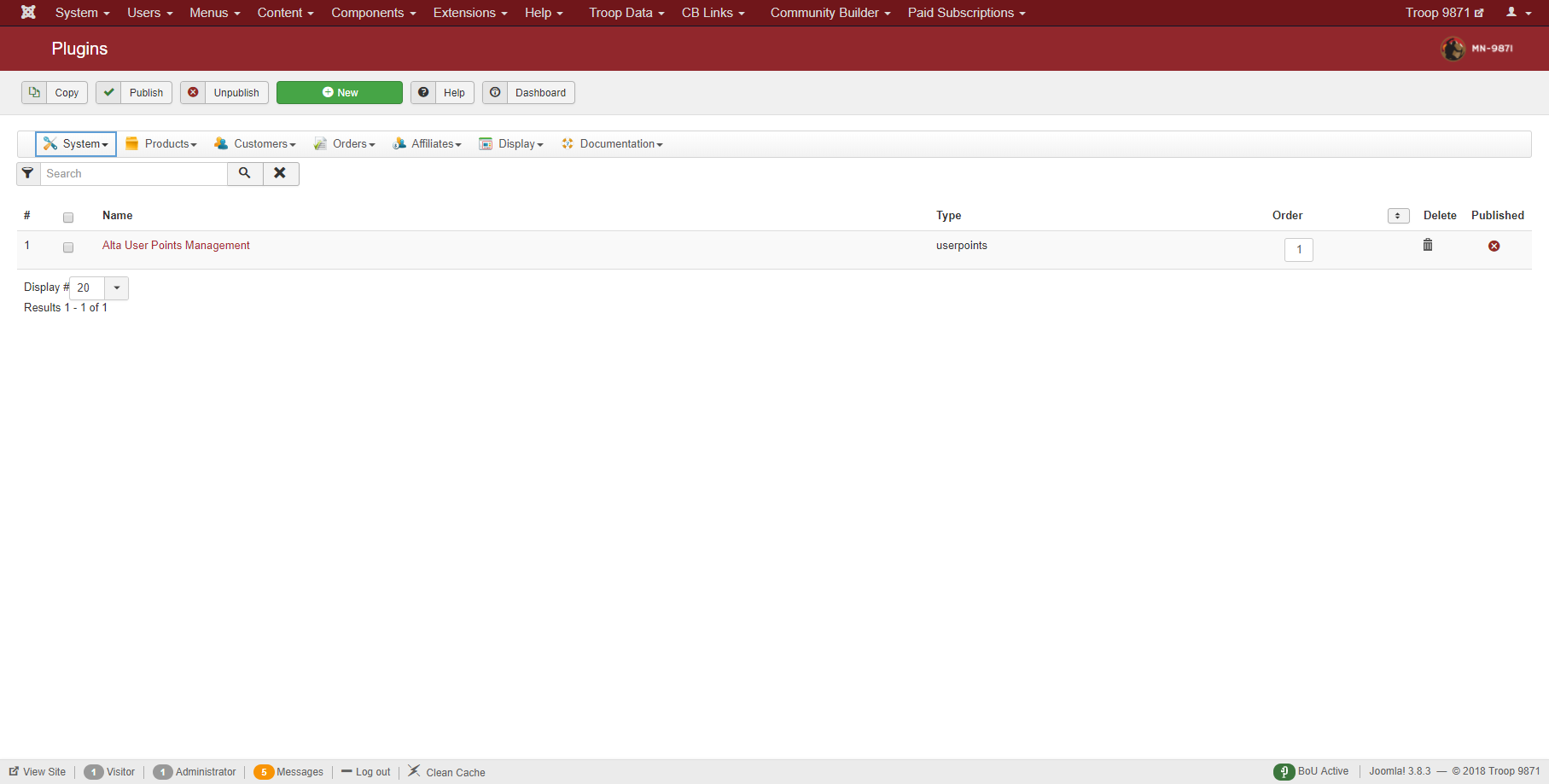

  • Posts: 26386
8 years 7 months ago #287306
See : pasteboard.co/H6fctGc.png
I'm wondering why the "unique function name" which is added by the plugin with the name "plgaup_orderValidation" has the name "plgaup_orderValidation_tlp" in your website.
Since that functions name is used by the plugins to add or remove the points ; if the function can't be found, it cannot work.
I changed the function name in your AltaUserPoints configuration ; it should work better with a correct rule set !
