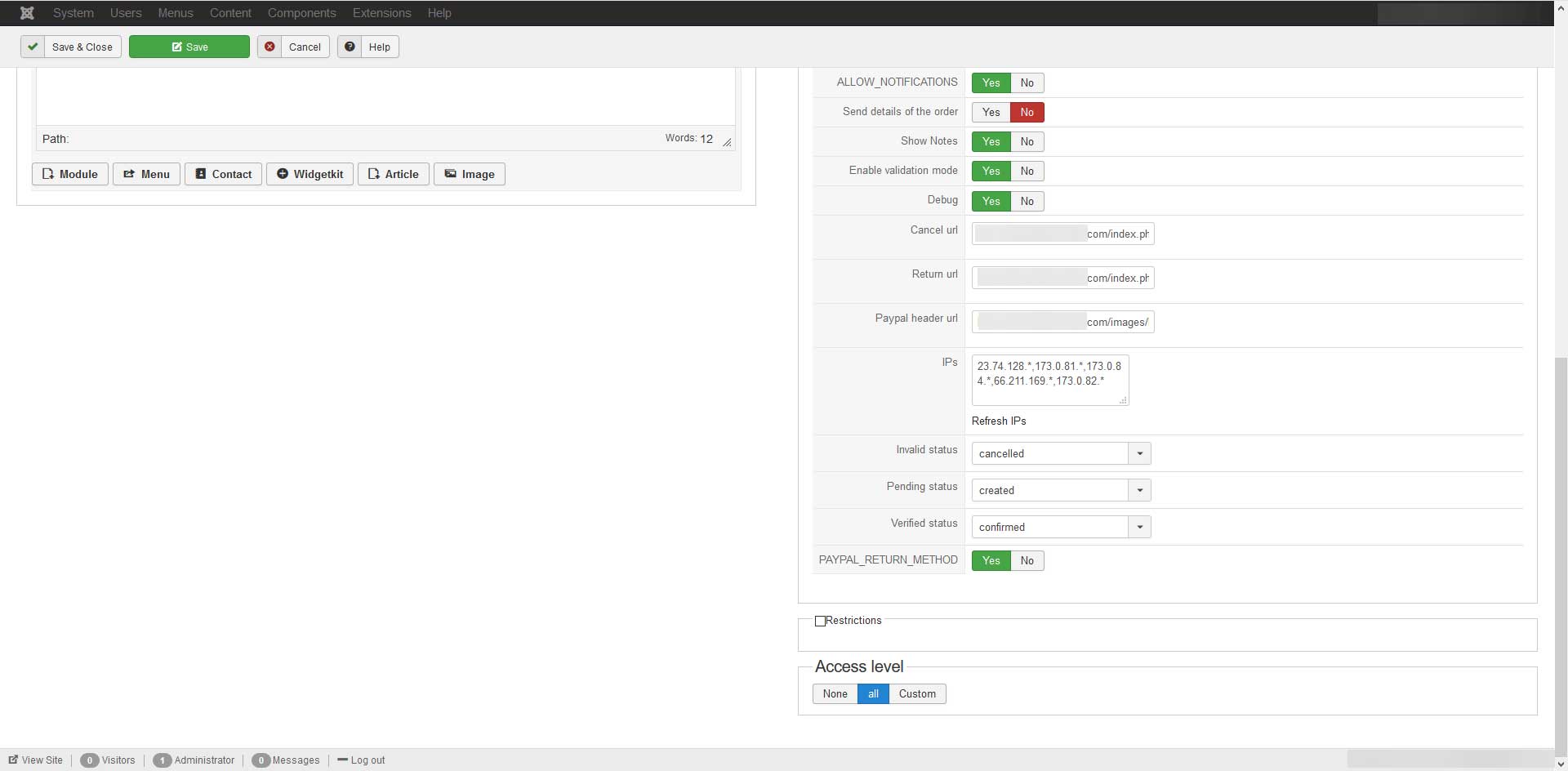

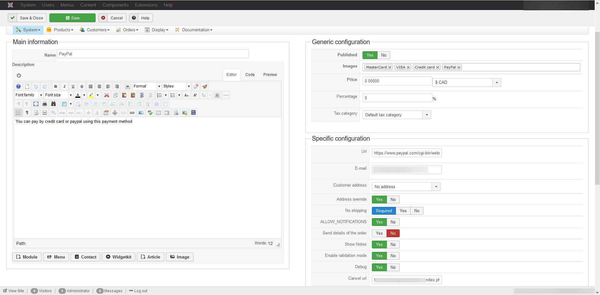

I've gone through the troubleshooting list regarding this issue but I haven't found a resolution. Please note the payment logs. What am I missing?

You have the "enable validation mode" setting activated. This means that when the payment are done, you have to validate them on your PayPal merchant account to receive the money. Once done, HikaShop will receive the payment notification from PayPal and the order status should be changed to confirmed.

I have disabled "enable validation mode" as I don't want to have to validate each transaction. After the transaction the status is still created.
