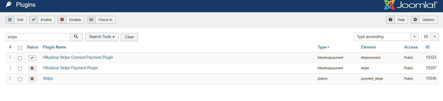

5 years 11 months ago #322429
Hi Jerome,
Attached is the stripe plugin activated and installed.
I've done several testing yesterday and I found out it actually working BUT it takes 5mins to complete the process and redirect to thank you page.
  • Posts: 26376
5 years 11 months ago #322458
We would require more details about the actual configuration of the HikaShop payment plugin instance and a way to test the plugin.
Best would be to have an instance set with a test account so we could use Stripe test cards and see what could cause that long wait.
