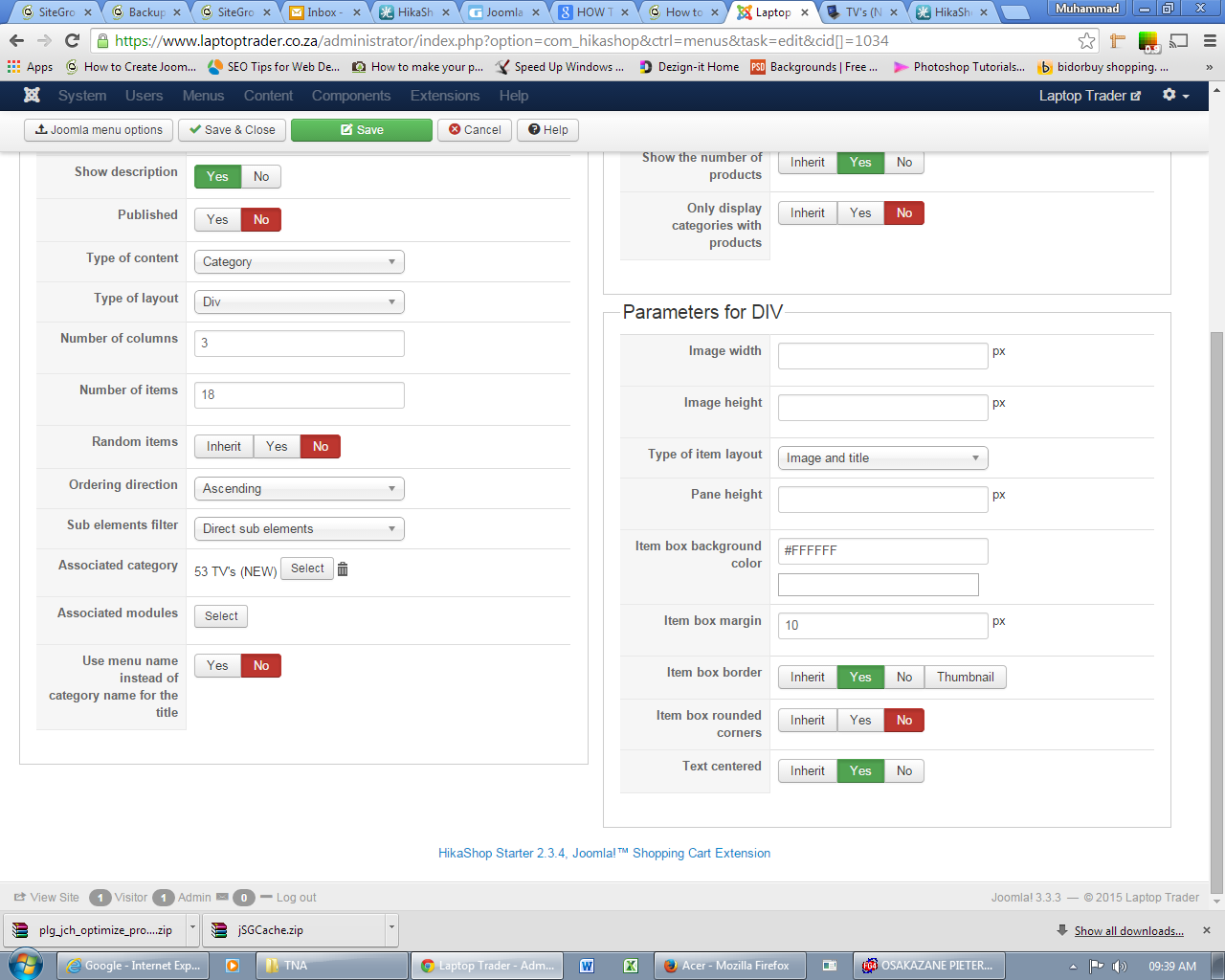

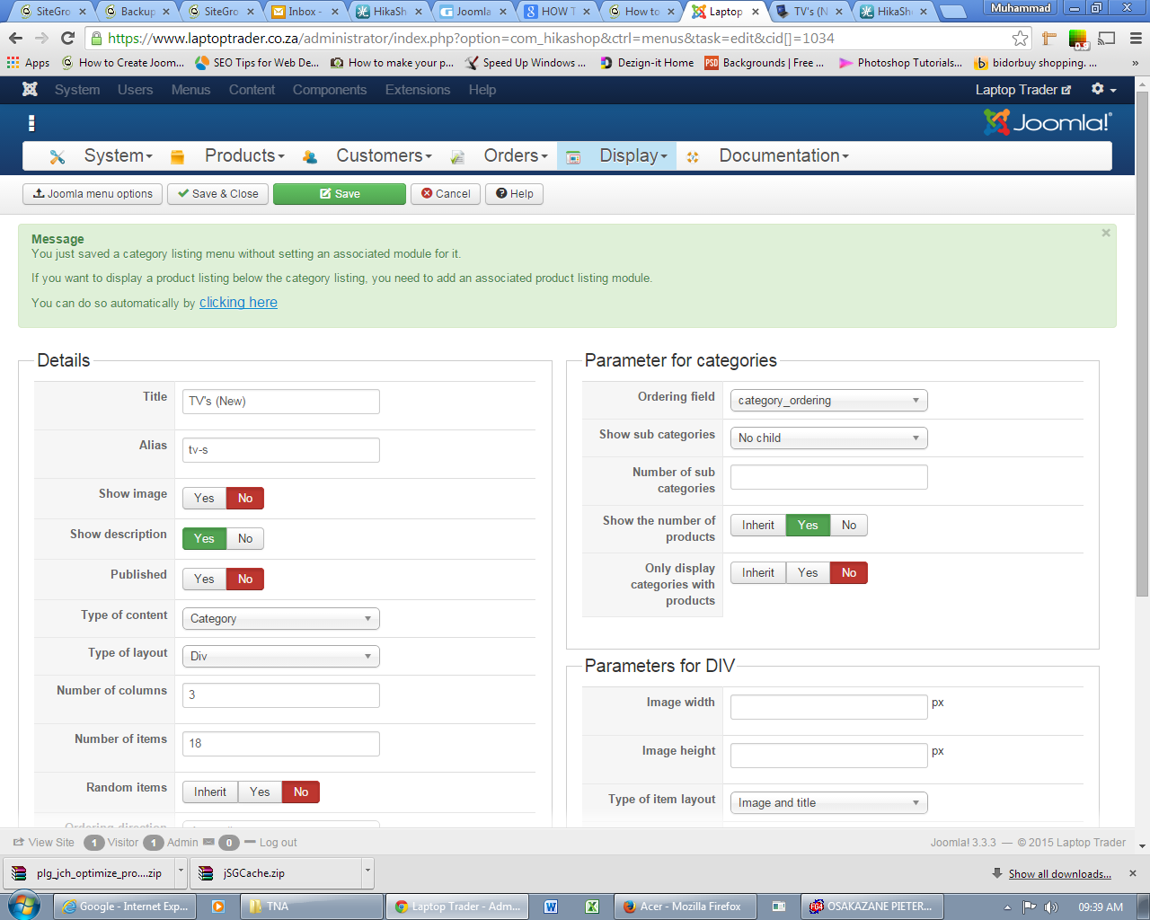

  • Posts: 19
11 years 5 months ago #193790
  • Posts: 86077
  • Thank you received: 14185
11 years 5 months ago #193796
Don't you see the message at the top which says that you need to click on the link in order to get a product listing associated with your menu ?
Click on the link there and it should then work.
