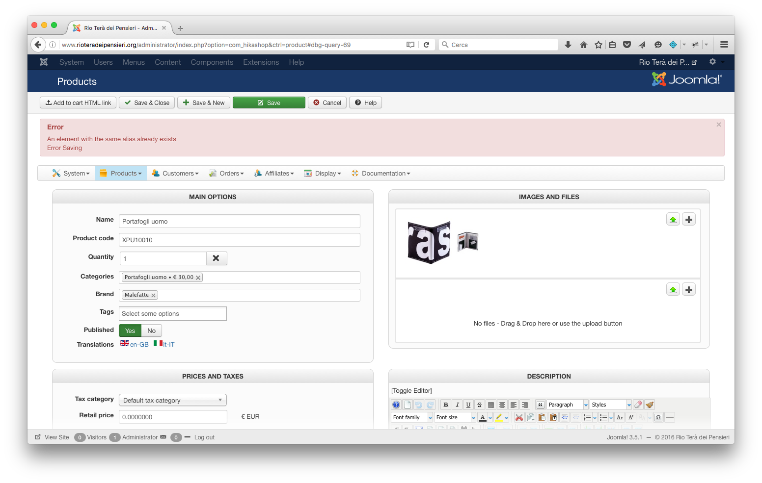

I've a problem whit last Hikashop's version. When I try to save some change on product item. System give me back this error: "Error - An element with the same alias already exists - Error Saving".
In attach a screenshot about this error.

Can you click on the "Check database" button via "Hikashop->System->Configuration" and test it again after the check is complete ?

I did, but system give me the same error. What can i do?

Then please make sure that the alias you're using in your product is not already used by another product.
It should then work fine.

Ok, Now it works. It was about alias.
