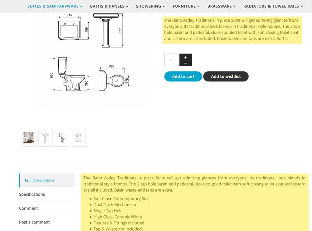

The intro information stops midway through the words (please see attached). Is there a way to have separate entries for the intro text and the full description?

If you want it to cut at a certain place, you can add a read more tag to your product description.
Your product page layout is already heavily customized so I'm not sure what code you have to display the intro information.
By default, it's this code:
if(!empty($this->element->product_description)) {
			$resume = substr(strip_tags(preg_replace('#<hr *id="system-readmore" */>.*#is','',$this->element->product_description)),0,300);
			if (!empty($this->element->product_description) && strlen($this->element->product_description)>300)
				$resume .= " ...<a href='#hikashop_show_tabular_description'>".JText::_('READ_MORE')."</a>";
			echo JHTML::_('content.prepare',$resume);
and if you want to use another text than the description for that intro text, then you can create a custom product field via the menu Display>Custom fields and change the product_description text to the column name of your custom product field in the code above.
That code is normally in the product/show_tabular.php view file that you can edit via the menu Display>Views.
You can use the "Display view files" setting of the HikaShop configuration to know which view file is used where in HikaShop

It's not possible to do that via CSS. Note however that if you do view files modifications via the menu Display>Views, these modifications will be saved as view overrides and you won't loose them when you update HikaShop in the future.

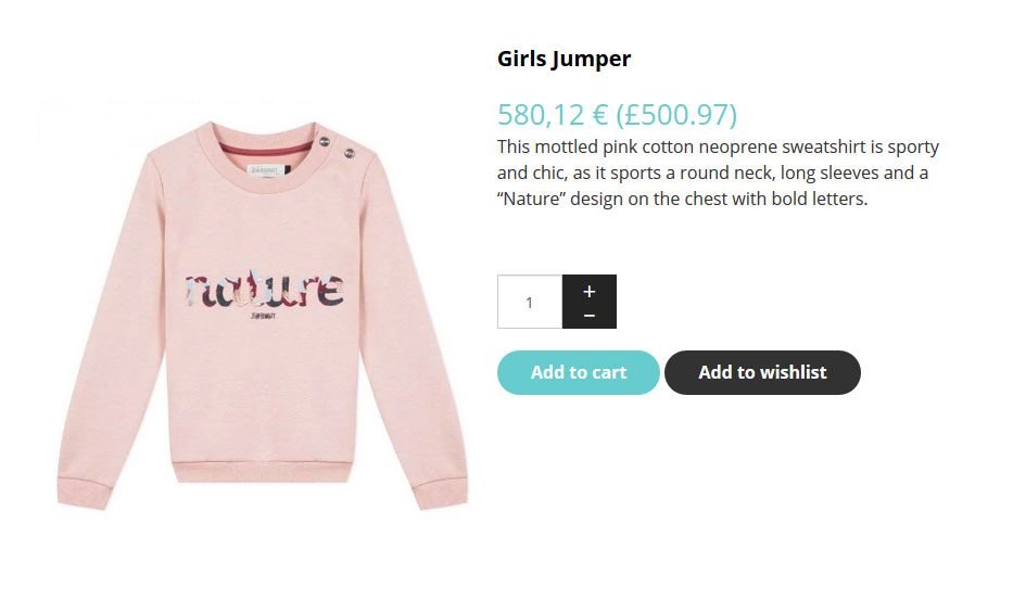

I am working on a site at www.luxminime.com/en/new-in/product/387-test-girls-jacket
I would like the product description to display as standard Hikashop. So, I don't want the Description or the Specifications tabs at the bottom of the page.
i have deleted the custom fields, but I'm not sure what to change in 'show_tabular'. I have attached the file and was hoping you could take a look for me.
Thanks.
Colin.

Yes, I would like to just have the description under the price with no tabs or comments. I have attached a screenshot.
Colin

Then, turn off the votes and comments in the HikaShop configuration. That will remove the comments area.
And then, you can leave the description empty and fill in the "product_intro" custom field instead and it should display where you want it.
Finally, you can do the modification I talked previously to remove the description and specifications tabs and that should leave you with a page resembling your last image.
