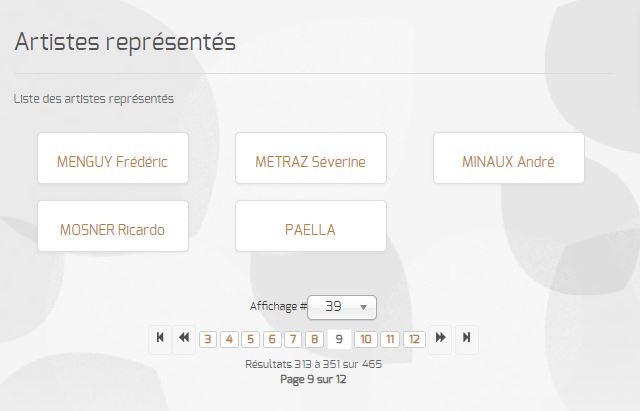

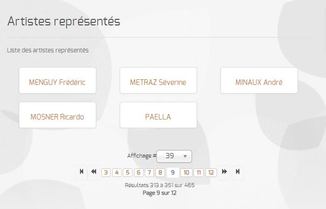

i have a problem with the listing of categories on my website.
I have more than 400 categories and i want to have a web page which lists them only if they have products.
In presentation options i asked 3 columns and 13 rows (39).
The problem is that some pages have 39 items shown but some have 5 (image attached) and some have none.
I have seen that each time i click on the pagination bar (bottom of the page), the url adds new parameters without erasing the older ones.
for exemple, dev.pozor.com/artistes becomes dev.pozor.com/artistes?limitstart_catego...category=78&limit=39 on the third page.
Could you help me to fix these problems ?
Thanks !
PS : excuse me for my english but i didn't find the way to publish in the french forum..
Sorry !
6 years 10 months ago #314060 by nicolas
To be able to keep 39 categories per page, what would be required is to load all the categories of all the pages in memory, then count the number of products of each category, to be able to remove the ones without product, and then do the pagination in memory and throw out the data of the categories on the other pages.
At that point, pagination would be useless since you would already have loaded all the categories data on the page, you could as well directly display the data directly.
Of course, due to the restrictions of the server, the page processing would likely crash in such case.
So to avoid this, we do it differently:
We first ask MySQL to load only the categories of the current page, and then count the products of each category on that page and remove the ones without products. That's a lot less resource intensive.
What could be done would be to pre calculate the number of products of a category each time a product quantity is changed, deleted, added, etc. That way, we could directly load the categories with products as that information would be readily stored in the database. But that brings issues as it's not easy to be sure that the count is always accurate. You would likely end up with inconsistencies because of operations like mass actions or imports and such which would circumvent that pre calculation in order to speed up the processing, ending up with innacurate listings.
So I'm afraid there is no easy solution to your problematic. I would recommend to manually disable/enable the categories when there are no products in them or turn off the option to only display categories with products.

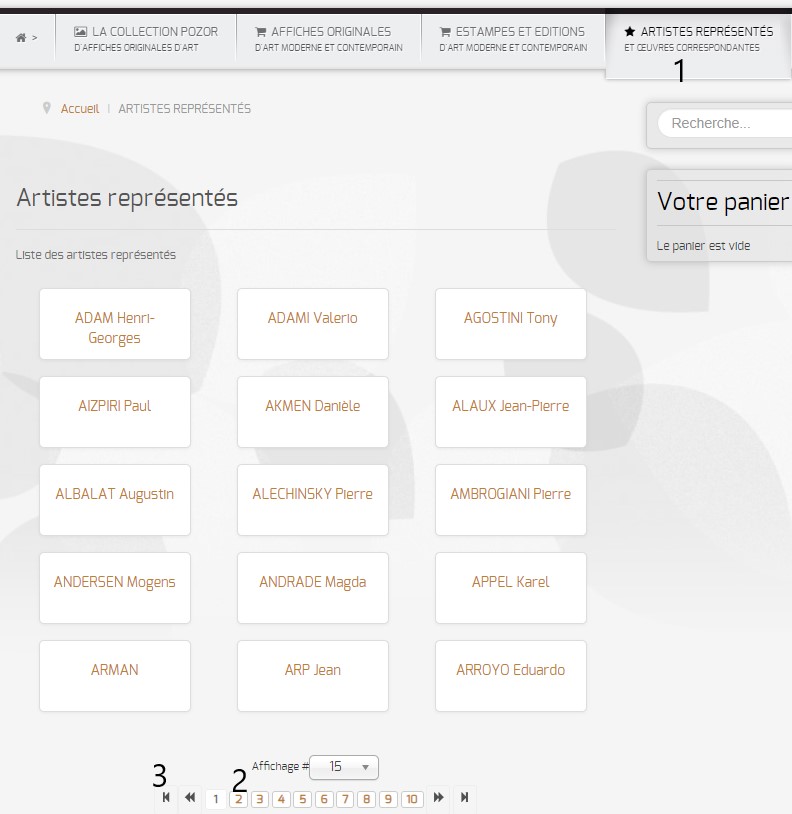

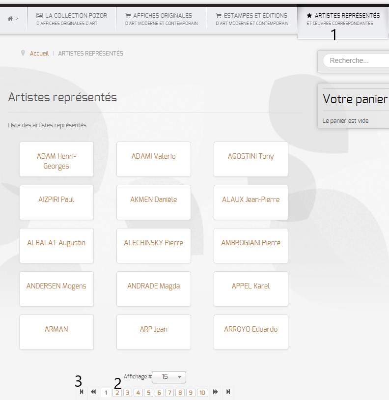

Par ex, dans l'image 2 que je vous joins, l'url affichée est obtenue après avoir cliqué sur la page 1 puis 2 puis 3.
Y a t'il un moyen de ne pas avoir ce problème d'affichage ?

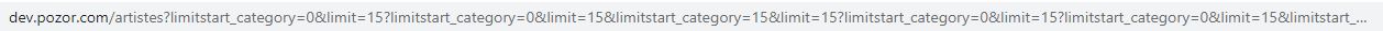

Quand je clique sur le menu du site pour afficher les artistes, l'url est : dev.pozor.com/artistes
Quand je clique sur le bouton 2 (page 2), l'url devient : dev.pozor.com/artistes?limitstart_category=60&limit=60
Quand je clique sur le bouton 3 (page 3), l'url devient : dev.pozor.com/artistes?limitstart_catego...ategory=120&limit=60 (paramètres passés 2 fois)
Quand je clique sur le bouton 4 (page 4), l'url devient :https://dev.pozor.com/artistes?limitstart_category=180&limit=60?limitstart_category=180&limit=60?limitstart_category=180&limit=60?limitstart_category=180&limit=60 (paramètres passés 4 fois)
Quand je clique sur le bouton 5 (page 5), l'url devient :https://dev.pozor.com/artistes?limitstart_category=240&limit=60?limitstart_category=240&limit=60?limitstart_category=240&limit=60?limitstart_category=240&limit=60?limitstart_category=240&limit=60?limitstart_category=240&limit=60?limitstart_category=240&limit=60?limitstart_category=240&limit=60 (paramètres passés 8 fois)

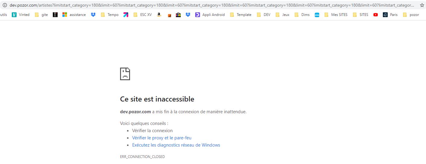

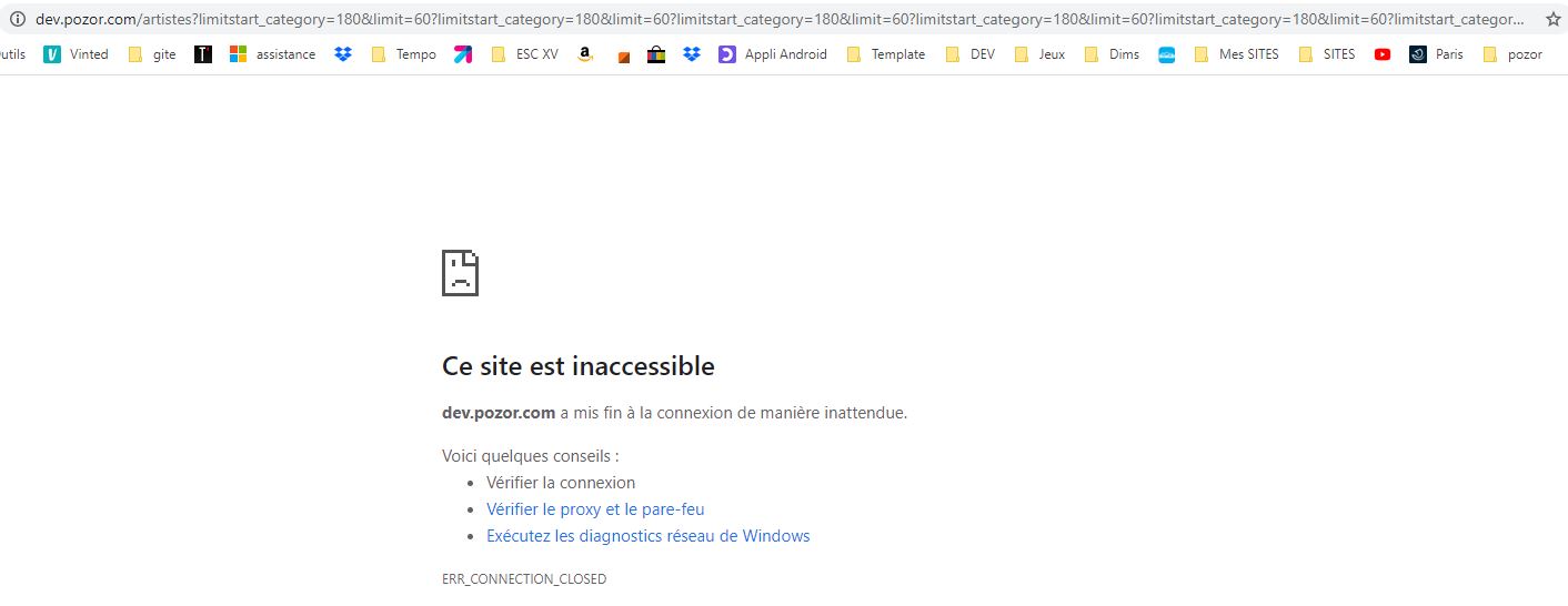

Il semble donc qu'à chaque clic, l'url générée, concernant les paramètres, se compose de l'url précédente dupliquée 2 fois et des valeurs des paramètres correctement mis à jour.
De plus, si je clique 9 fois pour naviguer entre les pages, l'url devient incroyablement longue et provoque une erreur (image jointe)
Je ne trouve pas la solution en ayant édité le fichier pagination.php que vous m'avez indiqué et dans lequel j'ai bien fait vos modifications.
Cordialement.

- A la consultation des pages de produits d'une catégorie, la requête s'ajoutent dans l'url à chaque nouvelle page, ex page 5 :
dev.pozor.com/affiches?limitstart=120&li...itstart=120&limit=30
et finit par faire une erreur après une dizaine de page visionnées, voir après :
dev.pozor.com/affiches?limitstart=60&lim...mitstart=60&limit=30

6 years 10 months ago - 6 years 10 months ago #314657 by Mohamed Thelji
Nous avons modifier l'option "Mode actuel du serveur URL" à "Automatique" via "Hikashop->System->Configuration->Avancée" et tout semble fonctionner correctement de nouveau, merci pour votre retour !

1/ Nous avons chargé la nouvelle version mais le mode liste multi-colonne ne fonctionne toujours pas correctement… même si ce n'est pas le plus gros souci.
2/ Vous estimez que c'est le désagrément le moins important mais comme je vous l'expliquait, il est inacceptable d'indiquer "résultats de 1 à 30 sur 237" quand on en affiche 17 produits sur 180 avec des trous en bas et l'activation manuelle est totalement impraticable. Merci de trouver une réelle solution s'il vous plaît.
3/ Problème effectivement résolu, merci. Reste les xxx autres…

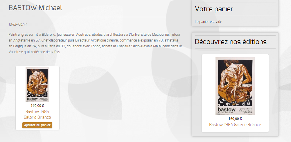

4ab/ Même en activant le module "Découvrez nos éditions" sur toutes les pages, il n'affiche pas la catégorie demandée (Editions POZOR) sur les pages de la Catégorie Artistes (fabricants), sur les pages d'artistes, ainsi que sur les pages de produits…
4c/ Comment peut-on faire pour afficher les articles en rapport sur les pages produits, comme le font tous les sites d'e-commerce. On ne peut afficher que les produits du même artiste (fabricant) ou de la même rubrique.
Il faudrait pour cela pouvoir afficher les produits du même artiste ET (surtout si il n'y en a pas) ceux du même éditeur, galerie ou événement, soit d'après les mots du titre, ou de ceux du code produit.

2.
Dans ce cas là utiliser les lignes de code CSS suivantes via HikaShop > Configuration > Display > CSS fera l'affaire :
Code:
span.hikashop_results_counter { display: none; }

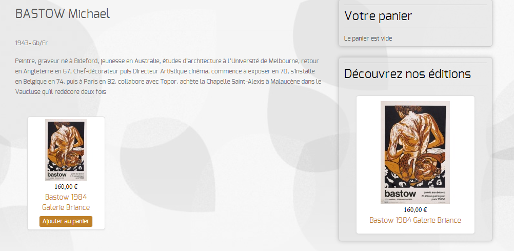

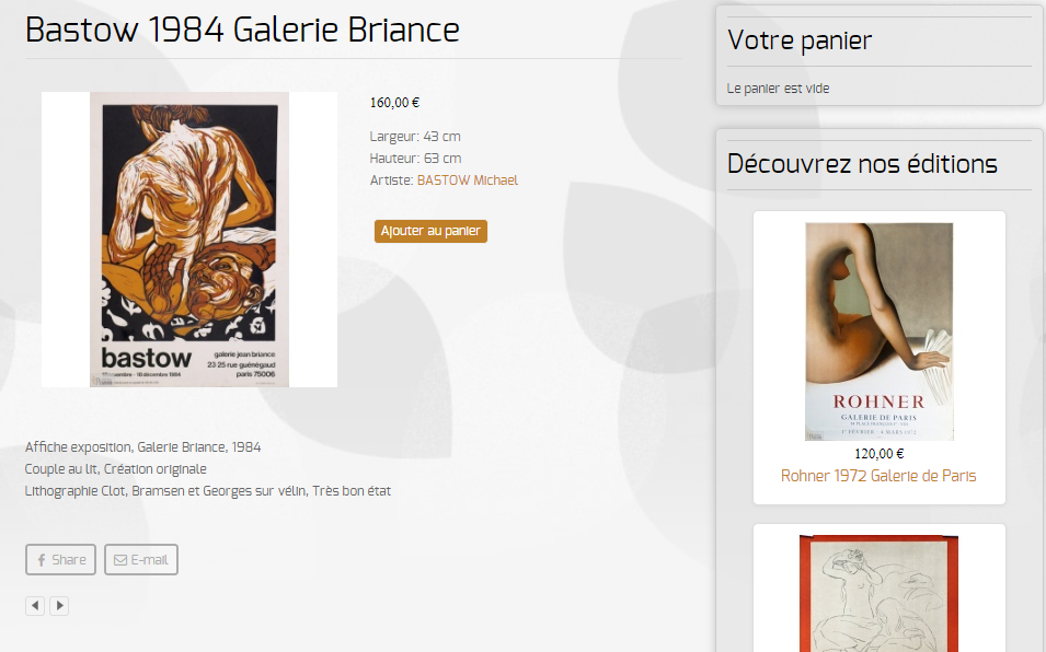

4.ab. Le module "Decouvrez nos editions" est actuellement présent via :

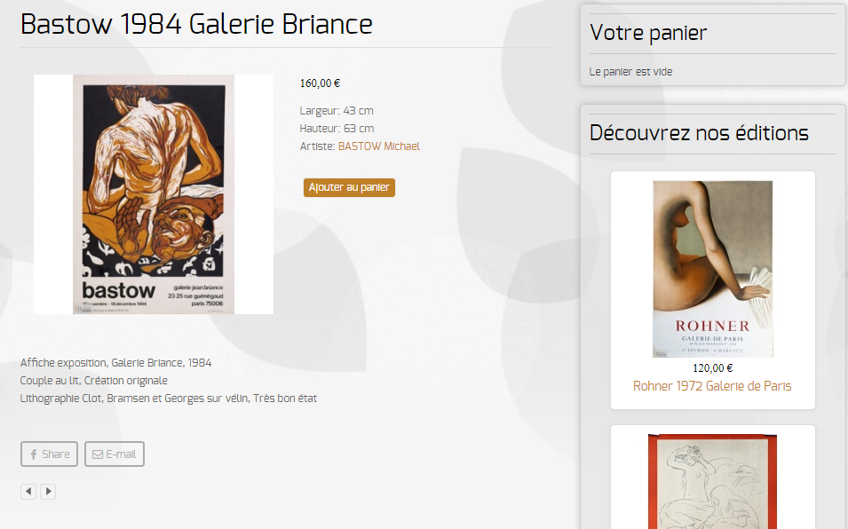

dev.pozor.com/artistes/aizpiri
dev.pozor.com/affiches/id/bastow-84-briance
4.c. La solution serai d'utiliser directement l'option "Related products" via la page de configuration des produits et les produits s'afficheront automatiquement.

1/ Ah merci, le mode liste fonctionne enfin, cela permet d'afficher beaucoup plus d'artistes par page.
Cependant le problème, qui avait été résolu depuis, de l'url qui s'ajoute à chaque consultation de page (voir notre post d'il y a 3 semaines, #314259), est revenu.
2/ Masquer les quantités par pages et totale n'est pas une solution quand on a plusieurs pages, car on se retrouve alors dans le flou, avec des listes de quantité différentes à chaque page, se terminant régulièrement par des trous, qui donne l'impression d'être la dernière page… (voir dev.pozor.com/artistes ) Ce n'est pas sérieux, d'autant plus pour un site e-commerce qui doit montré être carré et maitrisé…
Nous auront à terme 500 artistes (fabricants), ce qui ne peut être présenté qu'en sur plusieurs pages, merci donc de résoudre le problème s'il vous plaît, d'autant que cela fonctionne bien pour les catégories de produits (voir dev.pozor.com/affiches ) alors pourquoi pas les artistes (fabricants) ?
4ab/ Le module "Découvrez nos éditions" s'affiche mais le contenu demandé (Editions POZOR) n'est pas le bon sur les pages de la Catégorie Artistes (fabricants), sur les pages d'artistes, ainsi que sur les pages de produits
4c/ C'est ce que nous avons fait en traduisant le titre, mais comme expliqué, on ne peut afficher que les produits du même artiste (fabricant) OU de la même rubrique, mais pas les deux.
Il faudrait pouvoir afficher les produits du même artiste ET ceux de la même galerie ou événement, en pouvant ajouter les critères (du même artiste + De la même catégorie), ou d'après les mots clefs comme ceux du titre ou du code produit, les deux seraient top.

6 years 9 months ago - 6 years 9 months ago #314986 by Mohamed Thelji
1.
Le problème provenait du fait que la correction que nous vous avions fournit concernant le fichier administrator/components/com_hikashop/helpers/pagination.php a été retirée.
Nous avons re-modifié le fichier et tout fonctionne de nouveau.
2.
Comme expliqué via notre message précédent : Nous avons décidé d'opter pour le chargement des catégories sans précalcul des quantités. Ce qui fait que si une catégorie n'a plus de produits elle est enlevée de la page en cours avec donc le nombre d'élément affiché qui ne correspond pas à ce qui est configuré. Nous avons estimé que favorisé la performance était le désagrément le moins important.
HikaShop est un composant proposant un grand nombre de fonctionnalité et cela même dans la version gratuite. Cependant, avec un nombre de fonctionnalités gratuite croissant, des choix et compromis technique doivent être fait.
4ab. Le contenu affiché est bien "des produits de la même catégorie", comme vous l'avez configuré via l'option "Rapport" du module "Découvrez nos éditions".
Pourriez vous nous fournir plus d'information sur ce que vous voulez afficher ? Merci.
