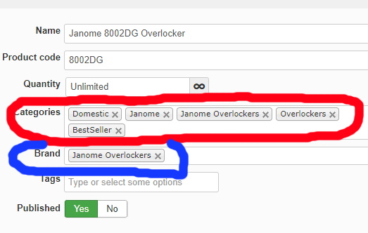

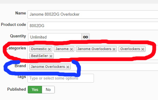

I should probably say that the reason I want to make this change is so that I can have one product in multiple categories. Such as a sewing machine being both a sewing machine and a quilting machine (As multi purpose machines occur a lot in this industry)

You are correct that the "Domestic machines" Menu is working as I want the rest of them to work, it is drawing them into categories based on the product "Category" field, where as the rest of the menus are only allowing them to be in One category, due to it organising them from the "Brand" field.
And as you can only have one it can only be in that one category in the menu, as you can see in the image above.
I'm just not sure why the categories in the "Domestic machines" menu are populated with the "categories" field from the products and the categories in the other sections are populated by The "Brand" field.
I assumed it would just be an option that I was missing somewhere.

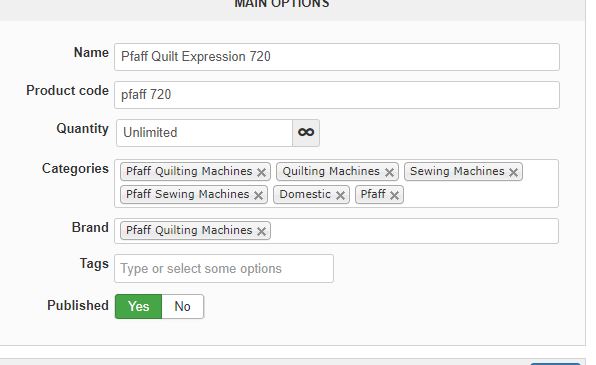

A good way to explain the issue I guess is with an example.
In domestic machines I have the Pfaff Quilt Expression 720, and it is both the sewing machines and quilting machines category (As it is both of those)
However, In the Pfaff menu that would not be the case, as in the pfaff menu it only gathers the data from the brand field.
Which in this case is "Pfaff quilting Machines" and therefore only ends up in that one location, when it should show up in "Pfaff sewing machines" and "Pfaff Quilting Machines" at the same time.
Sorry for the confusion, It feels like I've typed category 1000 times.

Well, I understand what you mean and what you explain in the video.
And yes, that's normal. You're not supposed to moving a brand as a child of a category.
That's why it doesn't work properly when you do as while the parent is then a category, the type of the element is still "brand" not "category" and thus, when you do that, the element is in a transient state and the system doesn't know what to do with it, especially since they are linked to the products as brands, not as categories.
In that case, it's indeed better to recreate the brands as categories and add them to the products with mass actions so that you don't have to use the brands.
But well, you already know all this since you wrote it yourself.
I thought that your purpose with this topic was to avoid doing that by keeping the brands as is while still having the result you expected. And that's why I proposed the band-aid solution.
But I agree with you that it would be better to use categories for what you want to do.
