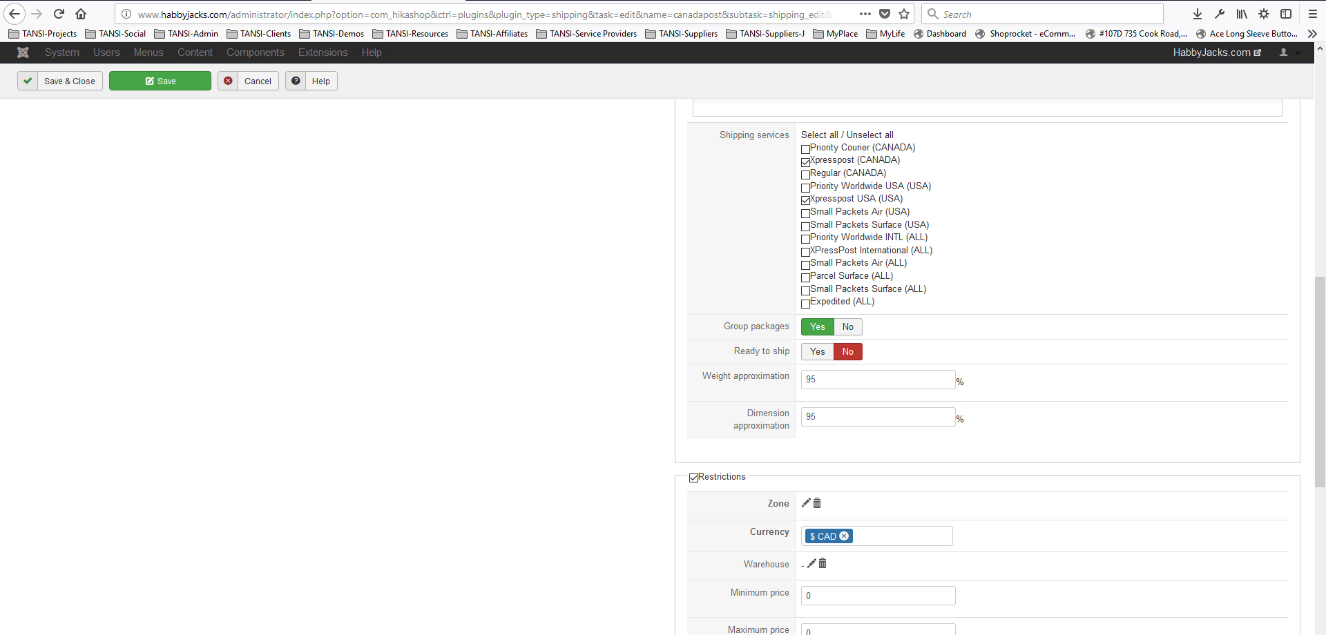

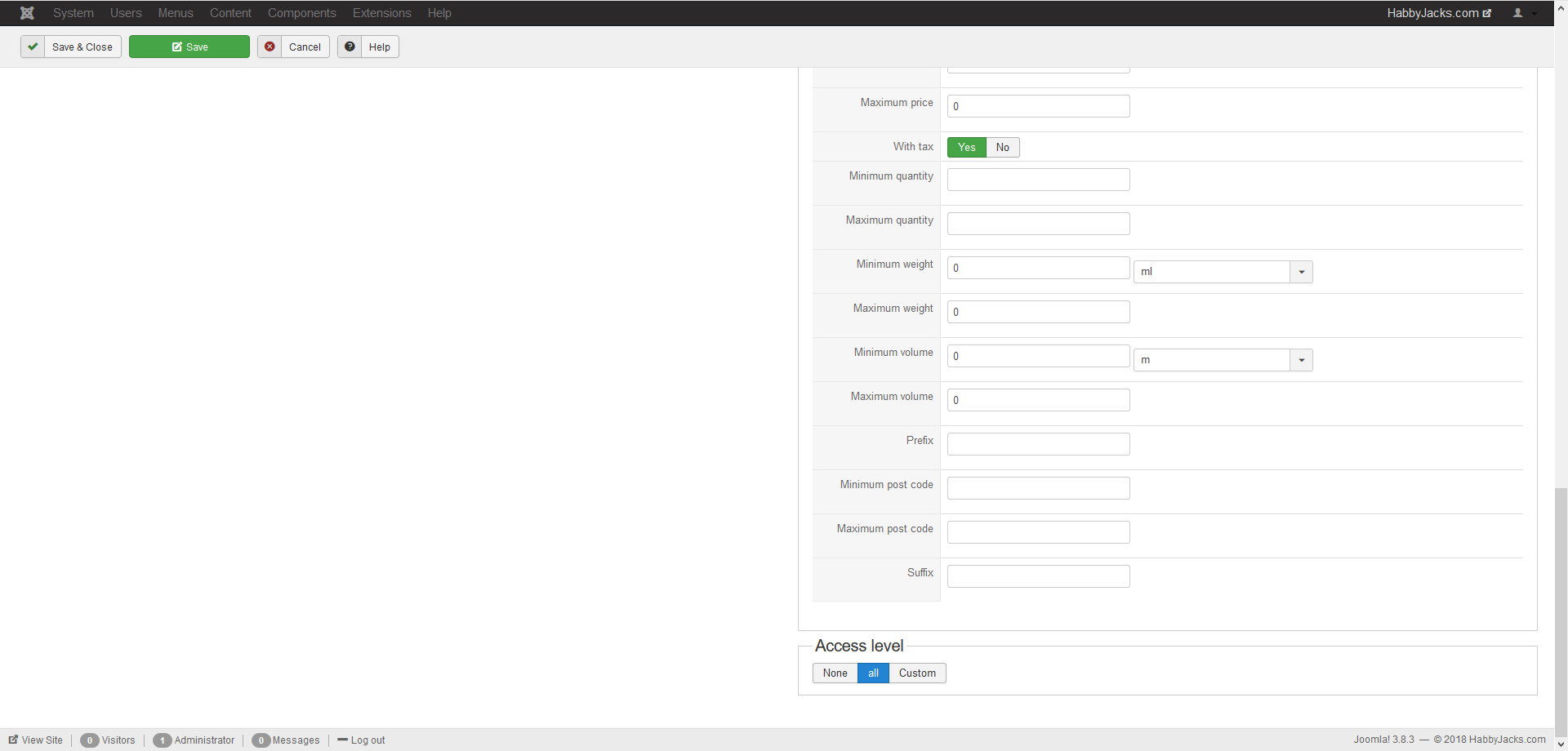

8 years 10 months ago - 8 years 10 months ago #285564
by jukeboxjunkey
Replied by jukeboxjunkey on topic Canada Post - Checkout Error

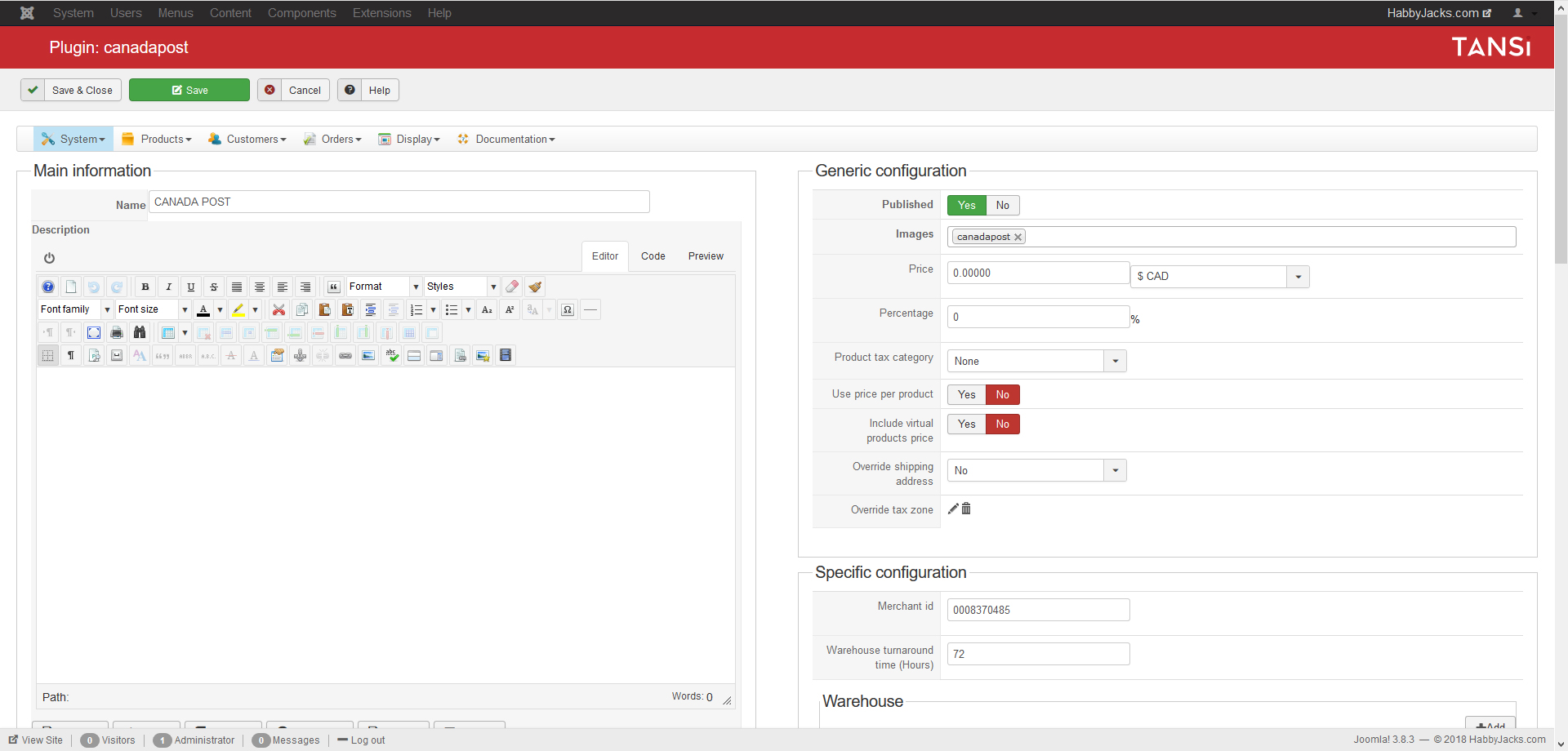

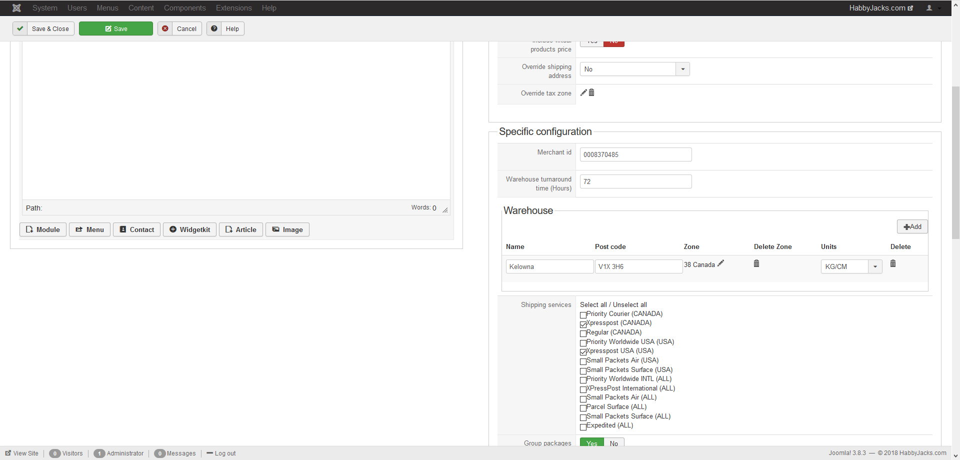

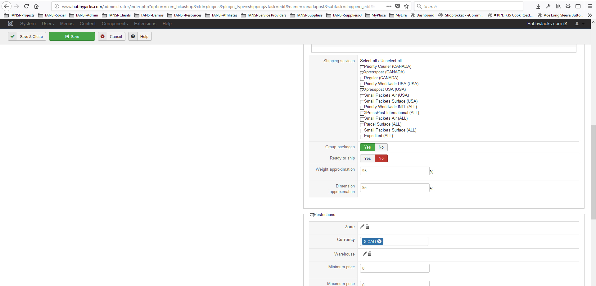

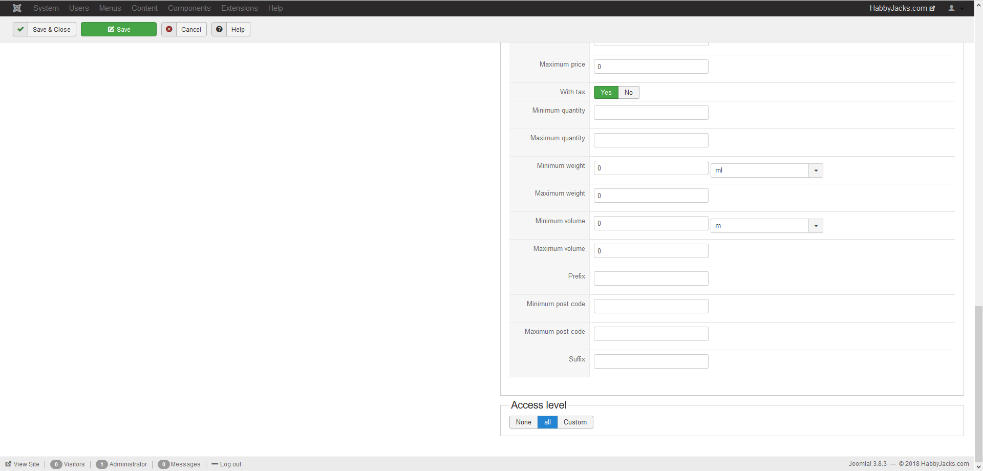

Please see attached

- Posts: 12953
- Thank you received: 1778
8 years 10 months ago #285583
by Mohamed Thelji
Replied by Mohamed Thelji on topic Canada Post - Checkout Error
Can you try it without any space on your the "Post code" option of your canada post warehouse configuration space ? Also, you should contact the Canada Post platform regarding the "Error code: -2001. Message: Merchant CPC Id not found on server." error message, it generally means that your credentials aren't valide or enabled.
