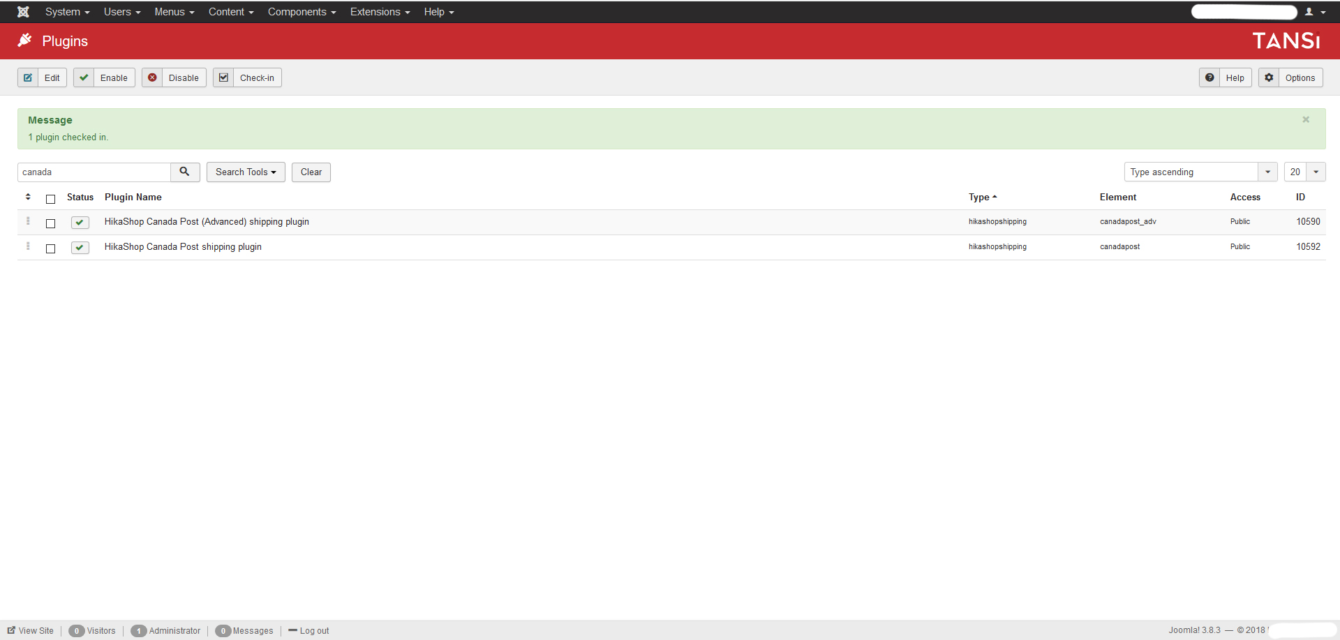

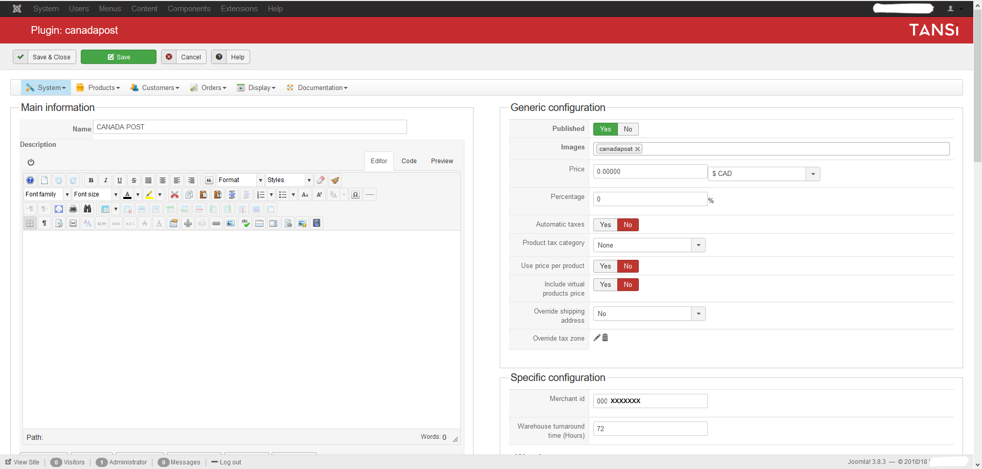

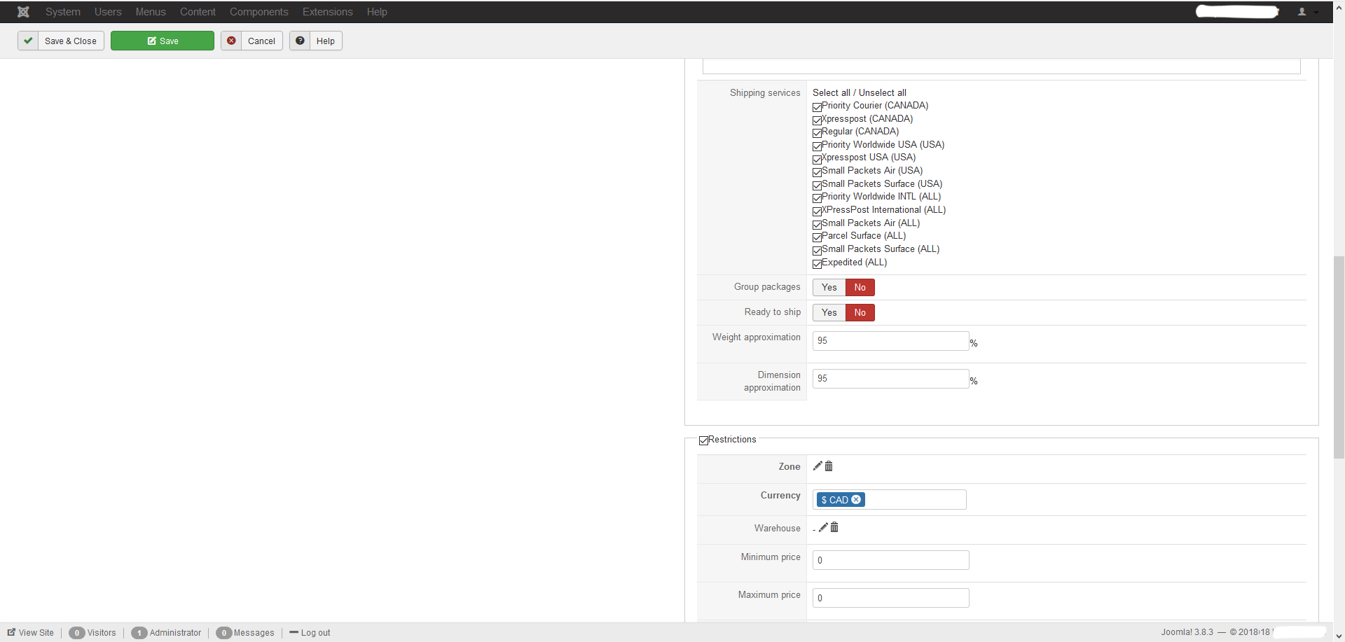

8 years 9 months ago - 8 years 9 months ago #286065
by Jerome
Replied by Jerome on topic Once again for the umpteenth time: Canada Post - No Shipping Method Found
I can see that you have some frustration with HikaShop regarding the "Canada Post" plugin.
Unfortunately, regarding your screenshots we can see that you're not using anymore the free Canada Post plugin that we provide in HikaShop packages.
It's also, not the Canada Post Advanced plugin that I have developed and which is available on our website:
www.hikashop.com/component/hikashop/prod...-canadapost-adv.html
So I have to deduce that you're using the Canada Post plugin by E-DIMENSIONZ.
As you will easily understand, we can provide support for our products but not for plugins made by third party developers.
If you have issues with the Canada Post by E-DIMENSIONZ ; you should contact directly that developer for help and bug fixes.
All we can say right now is that, if the Canada Post plugin does not retrieve shipping estimation, HikaShop won't have shipping methods available and will display you that error message.
Please do not make fast and harsh judgments and criticisms which are currently misdirected since your issue is not related to our work.
Specially when that "limited support" (to quote yourself) already helped you to configure the official Canada Post plugin.
CF : www.hikashop.com/forum/shipping-methods/...-checkout-error.html
And when I can see a 9 months old thread with, at the end, the same e-dimensionz issue :
www.hikashop.com/forum/shipping-methods/...ng-method-found.html
What I'm currently wondering is that, did you not make the same mis-configuration that you did 9 months ago ?

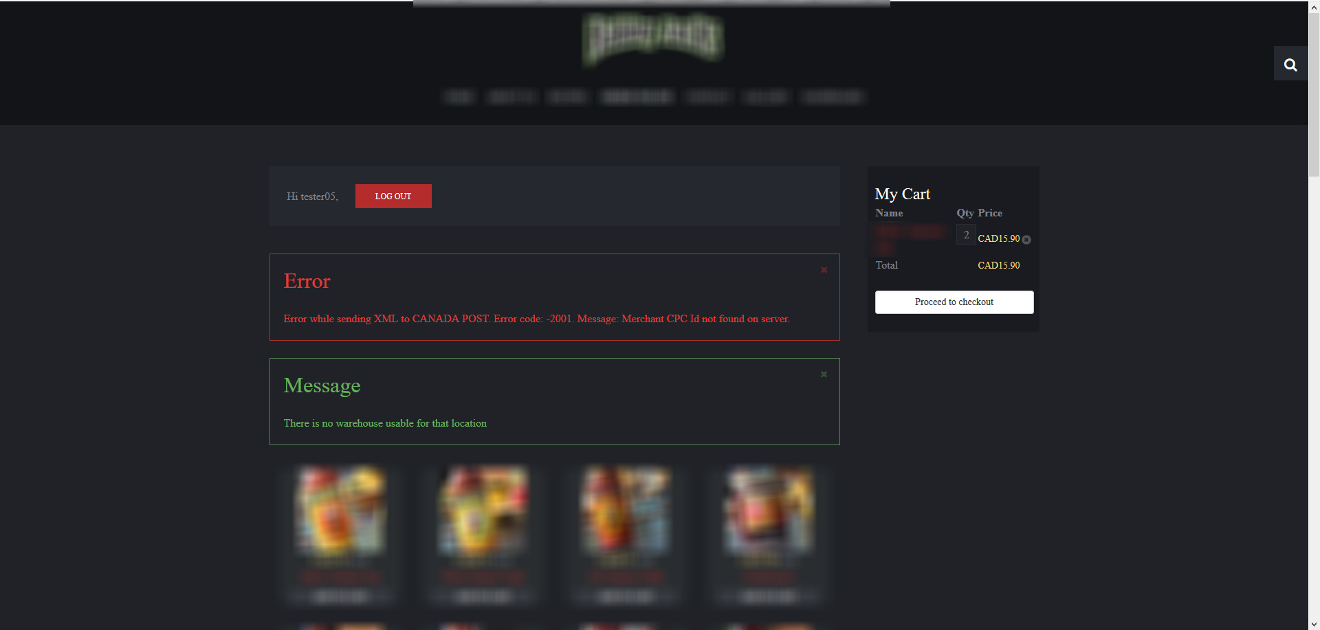

I purchased and installed your Canada Post Advanced Plugin. Now I am getting the following errors:
Error while sending XML to CANADA POST. Error code: -2001. Message: Merchant CPC Id not found on server.
There is no warehouse usable for that location
Note: I have contacted Canada Post. My account w/them is functioning correctly.

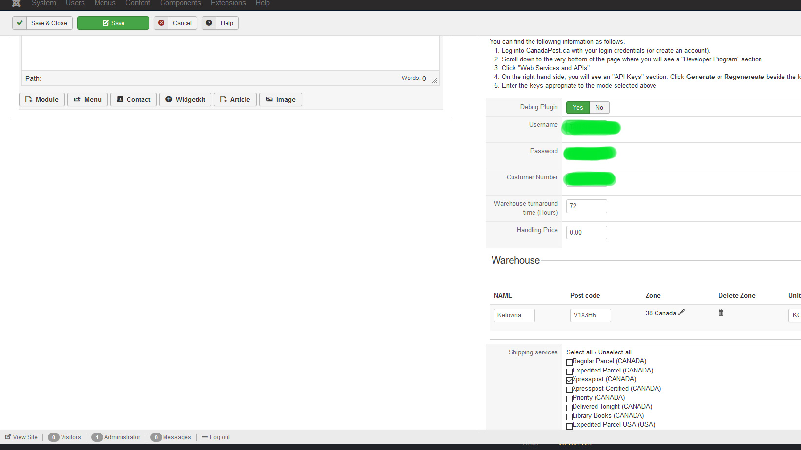

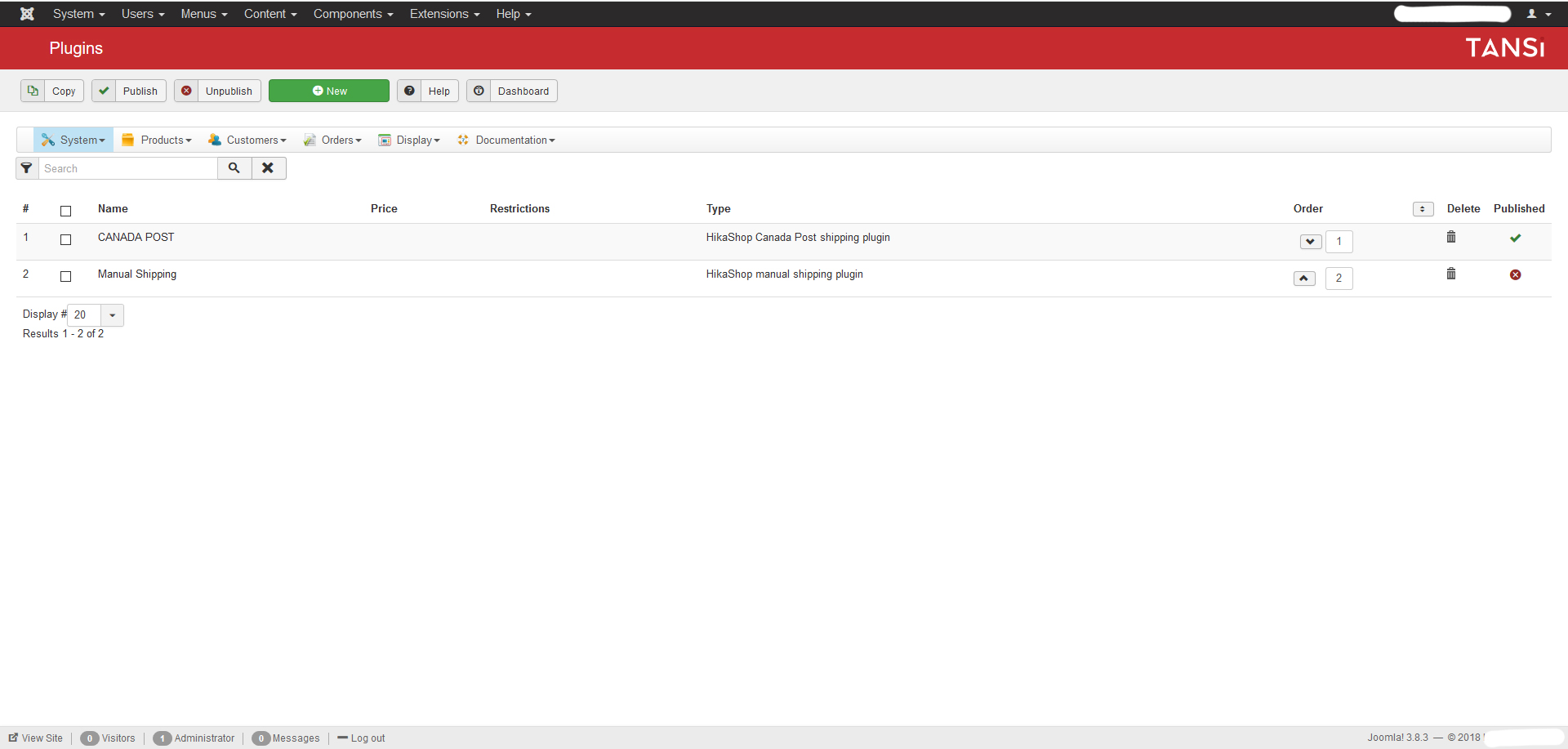

8 years 9 months ago #287676
by Jerome
The Message "Merchant CPC Id" not found on server indicate that the credentials are not working.

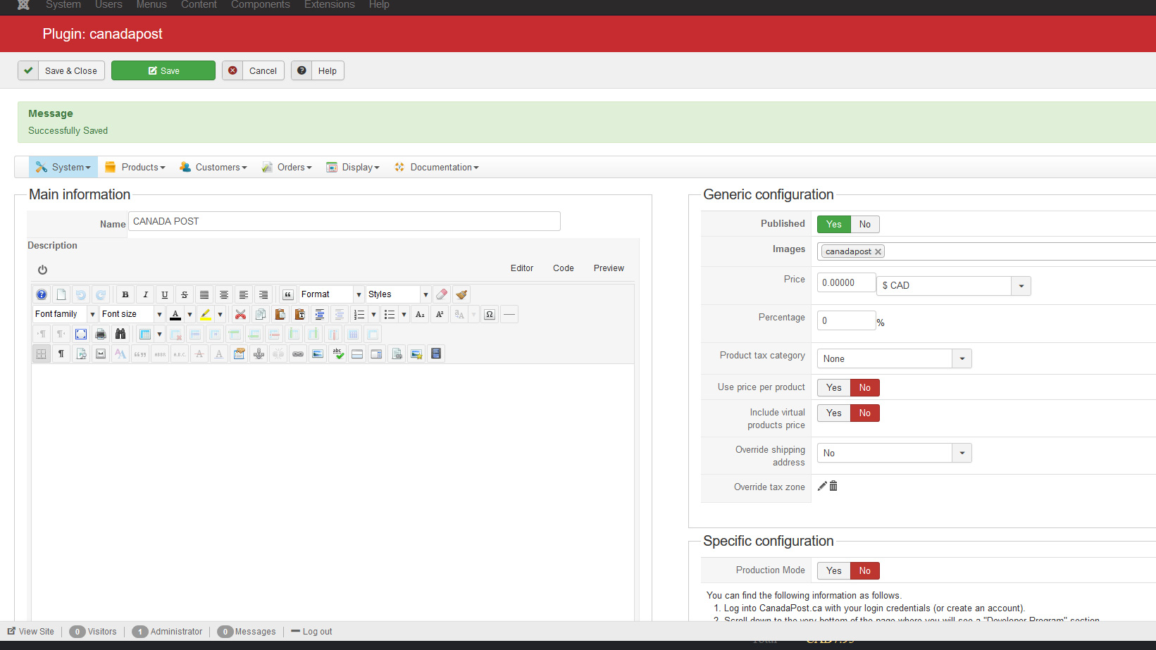

Now regarding your screenshot, you right have the plugin "Canada Post (Advanced)" installed in your website but you need to create a new shipping method using that plugin.
Your "Canada Post" method is still the one for the "Canada Post" plugin provide with HikaShop (which use the old API).
"Canada Post (advanced)" do not replace the HikaShop Canada Post plugin (otherwise you would lost it when updating HikaShop) ; it creates a new one.
The "Canada Post (Advanced)" plugin is using the new Canada Post REST API ; the configuration of the plugin requires a "username" and a "password".

8 years 9 months ago #287693
by jukeboxjunkey
Replied by jukeboxjunkey on topic Once again for the umpteenth time: Canada Post - No Shipping Method Found
I see. I thought that the Canada Post Advanced plugin was the one displaying. Adding the new shipping method plugin after installation did the trick.
I did have an issue trying with the no shipping method found, however when I changed the packing mode to "per-item" it was resolved.
Thanks for your assistance.
