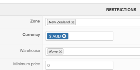

You should select the corresponding country in the "zone" setting of each shipping method.
That way, only the shipping method corresponding to the country selected in the shipping address of the user will appear.

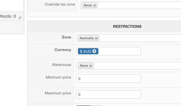

See attached what setting I have for Australia and the other countries I mentioned.
So the zone changes to each country selected.
I'm using the Manual Shipping method plugin.

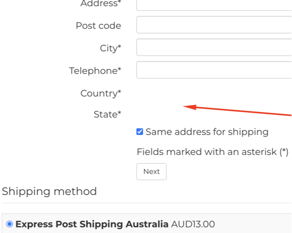

Using my UK proxy server to access and still No Country or State possible
Tried my VPN as well via UK and no change.
I've obviously got something enabled/disabled that is causing this :angry:

5 years 7 months ago #329258
I wasn't able to reproduce your country/state fields issue on my end, can you send us a temporary back-end access to your website using our contact form so that we can directly test it on your website ? Thank you.
Please, specify a link to that thread in your message.

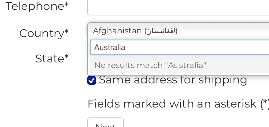

  • Posts: 23
5 years 7 months ago #329273
Attached is the issue I'm facing.
I downloaded a browser that has never been to the site before to ensure a clean access as well
My VPN is via the UK and check myIP shows this
Will change security settings to allow access and report back.

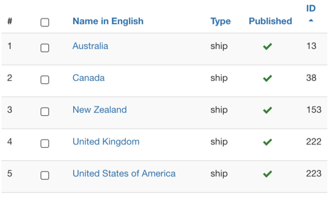

5 years 7 months ago #329292
Your issue is coming from the fact that you have unpublished through "Hikashop->System->Zones" every zones of the type "country" and "state".
Publishing them back should fix the issue.
Kind regards,
Mohamed.

5 years 7 months ago #329359
Your issue is coming from the fact that you changed the type of these zones from country to shipping (cf screenshot).
If you want to create a shipping zone, you'll have to :
- Create a new zone via "Hikashop->System->Zones"
- Set its type to "Shipping"
- Add every zone you need in it (countries or states).
So if you previously changed the type of country/state zones to shipping/payment, you should revert your changes if you want addresses field to properly work.
Kind regards,
Mohamed.
