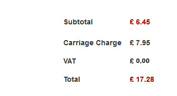

I have a shop up and running which was originally for UK only. However the client is now intending to supply the Chanell Islands & Eire. They do not pay VAT and this has been set up as 0%.
The issue I need to overcome is that with 0% the VAT/TAX line disappears from the cart. On the first attachement it shows a price with VAT the second has no VAT and I would like to show it as VAT: 0.00. Currently that line is missing if zero rate VAT is applied

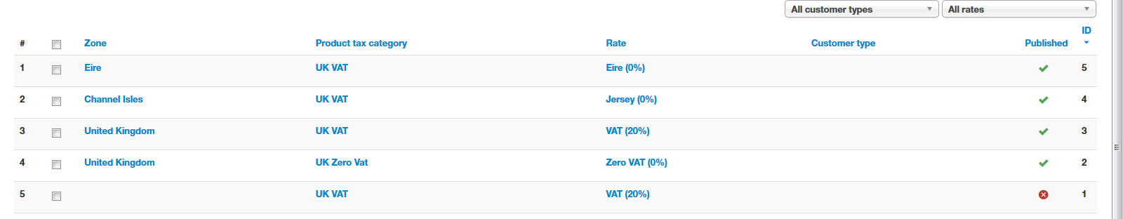

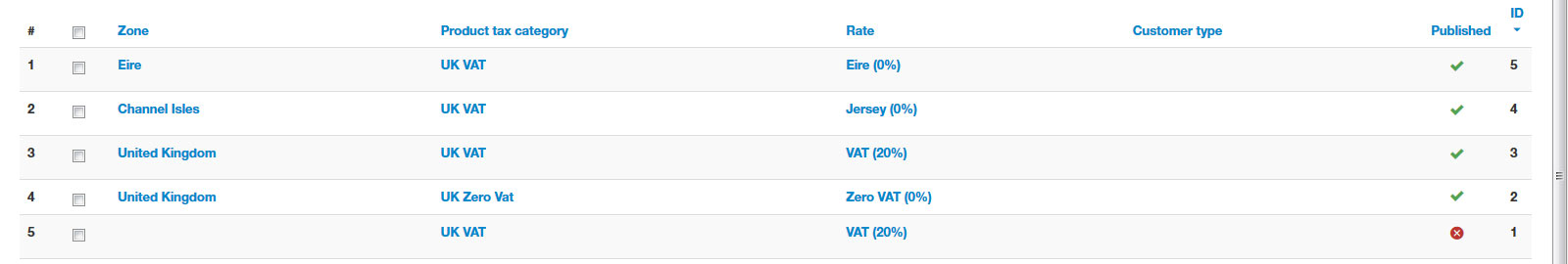

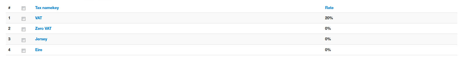

11 years 11 months ago #173009
The problem is still there. I had to remove the code as it affects what is a live site. I am quite happy to set the test account with admin access.
I have attached a couple of screenshots. One is for Tax rates and the other for Tax Rules. I am pretty sure these have been set up correctly!
The Channel Islands and Eire do not pay VAT on goods brought from the UK so the rate has been set as 0% as you will see from the attachments. As per my original post the Tax/VAT line is not shown on the cart/checkout page. I would like it to show as per the attachment tax display 2
Dave

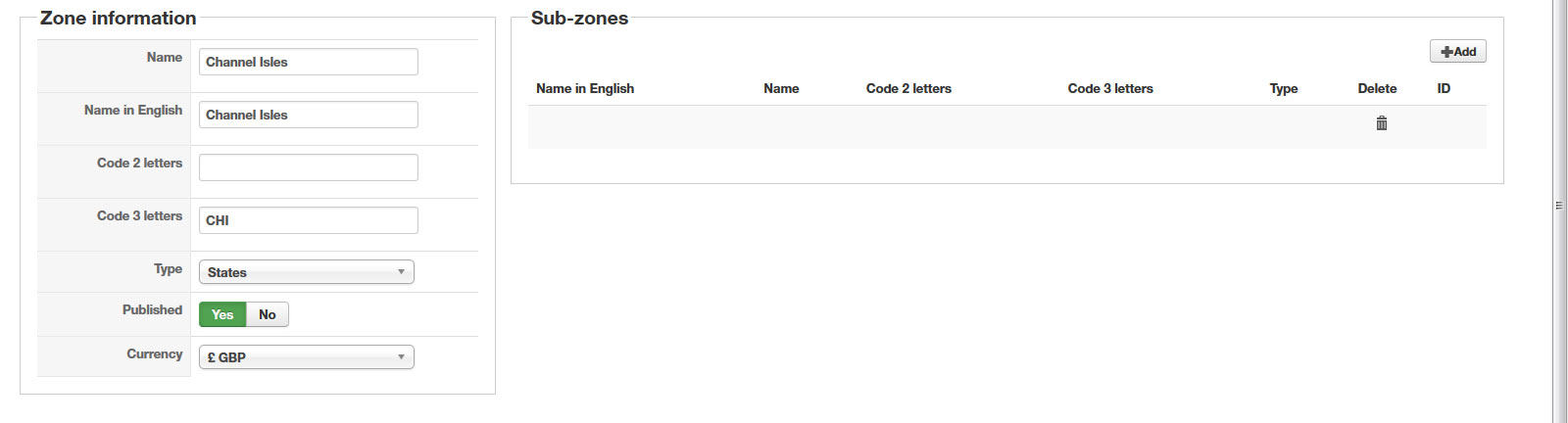

11 years 11 months ago #175095
the Channel Islands and Eire are set up to work with the UK product tax category. This is how Im understand it to work. I have attached 2 screenshots. More than happy to activate admin access so that you can conifirm these have been set up correctly?
Dave
11 years 11 months ago #175127
This seems to be set up correctly.
As the tax rate is 0% so we go in the else condition I gave you earlier and the 0 VAT should be displayed, I tried on my end and it seems to be working fine.
