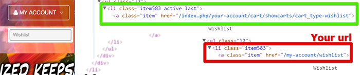

9 years 8 months ago - 9 years 8 months ago #260838 by Philip
Replied by Philip on topic Wishlist Display Issue
How do you proceed to create your menu ? I think the root issue is around there, because when I look on your html code I see a wrong url link, see by yourself :
The correct url is :
Code:
/index.php/your-account/cart/showcarts/cart_type-wishlist
Hope this will help you move forward, awaiting news from you.

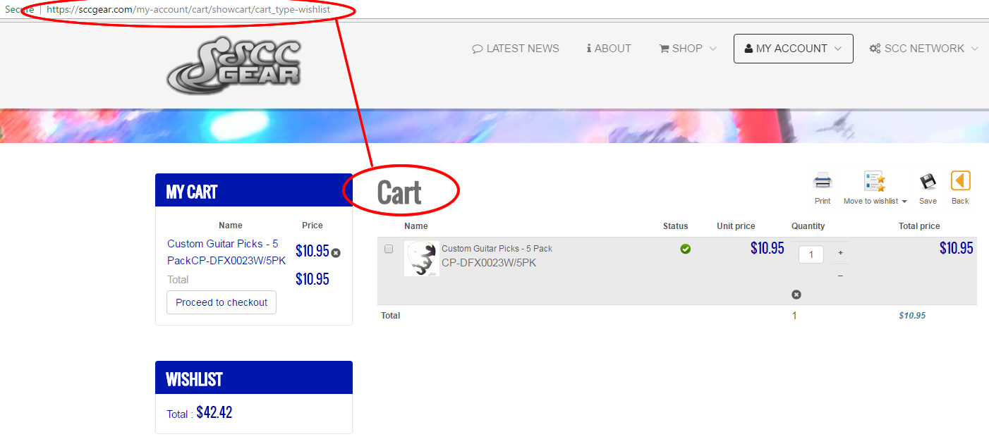

9 years 8 months ago #260859 by wild4gsus
Replied by wild4gsus on topic Wishlist Display Issue
Philip wrote: Hello,
Code:
If you go to the Control Panel, the button has the URL you show as correct, yet it still does not work. If you click Carts and Wishlists, they are two different links but both go to Carts. If you go to the Control Panel and click Wishlists, you will get the image I attached. Before upgrading to 3.0, I was testing it in 2.X but decided not to use it. just yet and it appeared to work fine at the time. I was thinking that maybe if I created a new link, maybe that would work, as there may have been something that changed for the 3.0 upgrade. No luck. The link that does work is in the Wishlists module... "/my-account/wishlist/cart/showcart/cart_id-393/cart_type-wishlist"
I don't mind not having the Wishlists link on the "My Account" menu, as I really only put it there to test things, but I would think the Wishlists button and the Wishlist module would link to the same thing.
