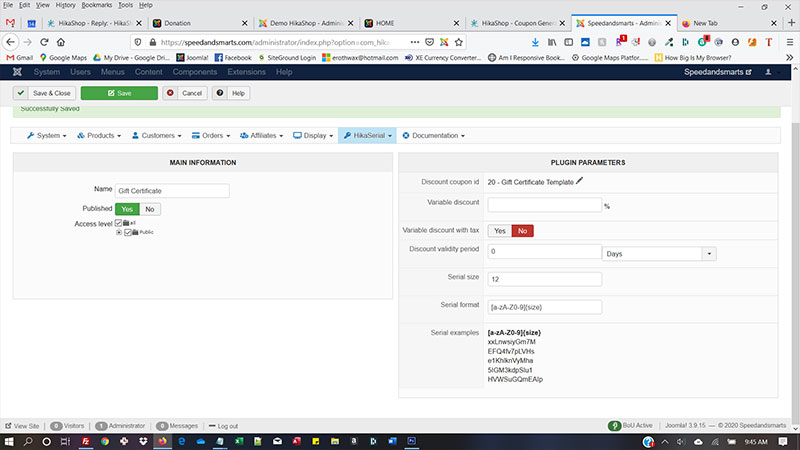

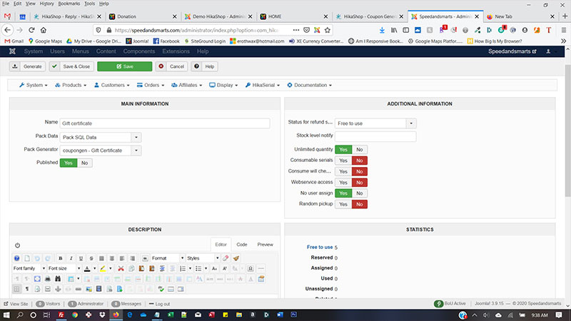

  • Posts: 106
6 years 6 months ago #315713
I created a pack, see image for settings.
My coupon is unpublished.
I would like to use the variable discount setting but I don't know what to put in there. The demo has 100, but I think the documentation is telling me I should leave it blank for a 'donation', is that correct? What about any other settings in the coupon generation plug in. I am attaching an image of those settings. Anything I should change?
Then what? How do I present the gift certificate option as a menu item or link on the front end?
How do I test if it works once It is purchased and applied to a product?
Can it be applied to a category of products or each product individually?
Thanks for all you patience and help,
Ellen
  • Posts: 26381
6 years 6 months ago #315722
Please check the documentation page I gave you and yes, you have to use the same value than the demo website.
It is a percentage value ; if you let the input empty, you're not using the feature at all.

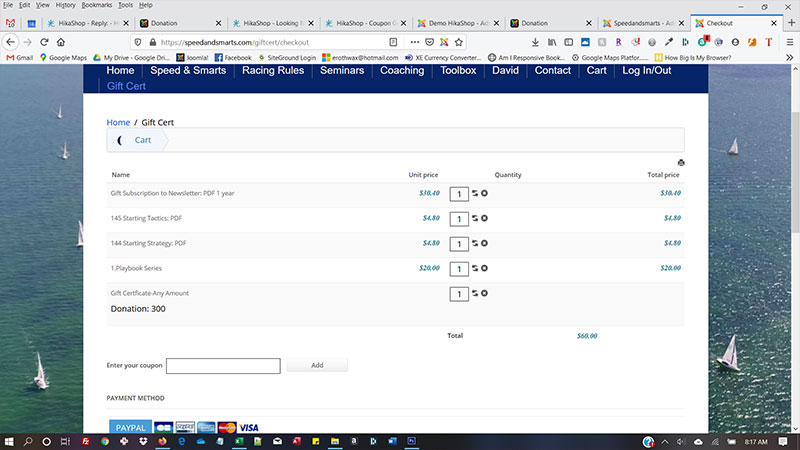

  • Posts: 106
6 years 5 months ago #315808
I changed the percentage value back to 100 in the coupon generator.
I created a menu item for the product Gift Cert.
I filled in the amount and proceeded to cart. The item is listed and the amount, but the amount is not listed under Total Price and it is not included in the totals.See attached.
What am I doing wrong?
  • Posts: 26381
6 years 5 months ago #315822
Your question is related to the configuration of HikaShop donation system.
In the HikaSerial section of the forum, we can only help you with HikaSerial questions.
Please open a new thread for your HikaShop question.

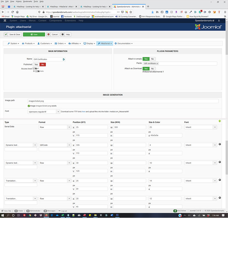

  • Posts: 106
6 years 5 months ago #315919
I am attaching a screen shot of my settings. I think I have it right.
How do I set up a virtual product file?
  • Posts: 26381
6 years 5 months ago #315924
There is no screenshot in your last message.

  • Posts: 106
6 years 5 months ago #315931
Here is the screenshot of the Attach serial plugin
  • Posts: 26381
6 years 5 months ago #315932
Your plugin instance is not published.
