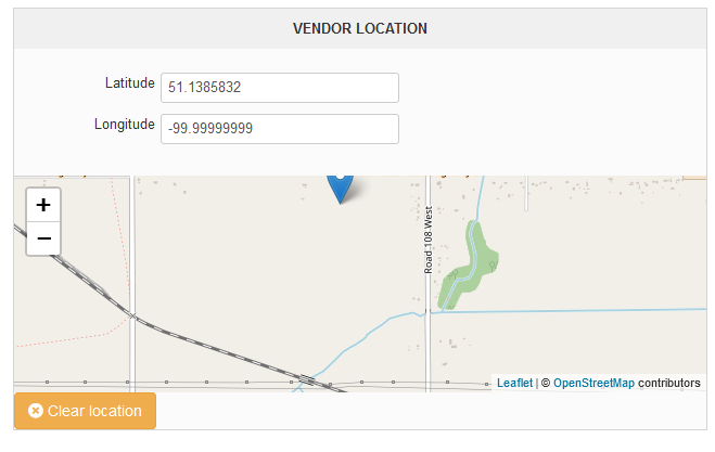

When I go into the vendor account on Hikamarket, scroll down to the vendor location, and enter the latitude and longitude of my vendor, then save, the information does NOT update the map.
As you can see in the attachment, the latitude and longitude ARE set, but if you go tot he page itself www.shoppin.ca/our-vendors/test-user it is showing a completely different location.
How do I fix this so it shows the co-ordinates I have entered?

  • Posts: 324
  • Thank you received: 4
6 years 1 month ago #322154
Just tried your demo site.
It saves the longitude, but the latitude reverts to 99.9999 just like on my site.
  • Posts: 26382
6 years 1 month ago #322156
Thank you for the tests you made in our demo website.
We were able to catch the issue and develop a fix for it ; fix which is directly include in the new release we made.
www.hikashop.com/support/documentation/1...arket-changelog.html
You can download HikaMarket 3.1.1 via your subscription page and update your website with it.
We also updated our demo website with the new package which should be "synchronized" now.
So you can made a new test to check that the issue has been solved.
