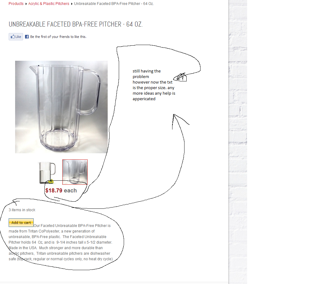

13 years 3 months ago #99096
i know it is a sad thing to have to do and others have tried it but can you show me a before and after of this i would really appreciate it and i know it would move things right along. Ok so here is the issue i finally figured out what was going on and how to move the code segments as described but what happens is the following please look at the attached screen shot this is the problem..
Last edit: 13 years 3 months ago by chaoslogic.
  • Posts: 86045
  • Thank you received: 14175
13 years 3 months ago #99111
That's the correct solution. And the modification is correct.
Your problem is now that because the description is too big, the right area goes automatically below the left area.
The solution is simple: you need to add the CSS code below in the frontend CSS file of HikaShop via the Display tab of the configuration page:
.hikashop_product_right_part{ width:45% }

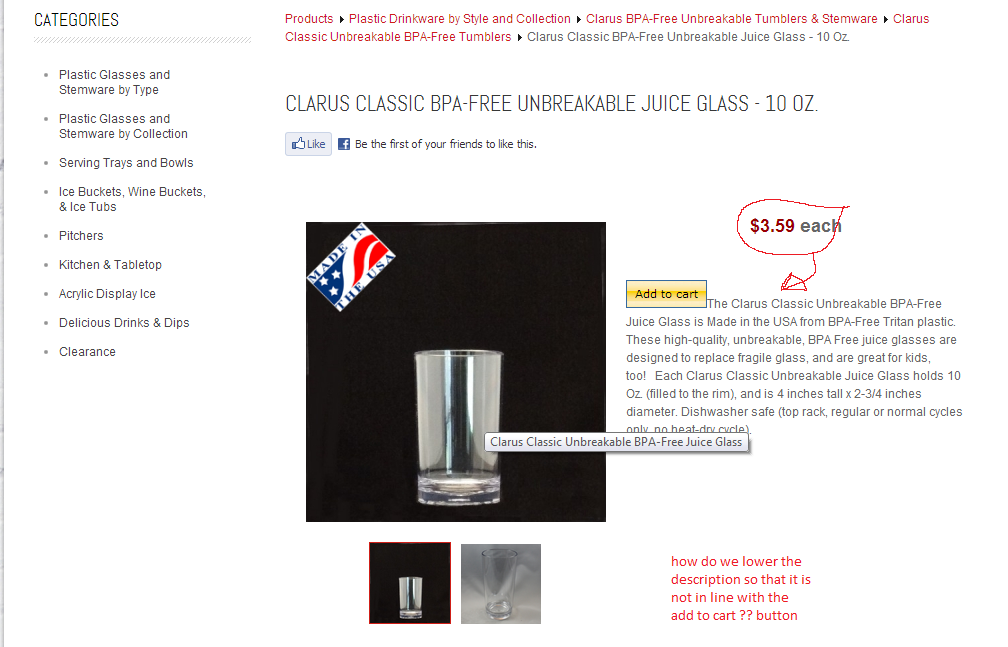

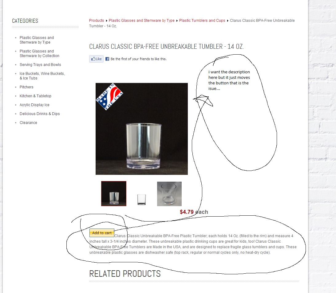

13 years 3 months ago #99362
that is fantastic that worked now i just need to get every thing lined up because that threw every thing off how do we go about doing that ? and also can we get the description below the button instead of in line with it once we get that done we will be done i have included a picture to assist and again thank you all for your help with this i could not have done it with out your assistance.
ok so i was able to fix the description issue by putting a return in but the price is quite another issue please let me know how to fix that thank you.
Last edit: 13 years 3 months ago by chaoslogic. Reason: fixed one issue still need help with the other.
  • Posts: 86045
13 years 3 months ago #99516
You can do that with additional CSS on your website:
.hikashop_product_price_main{
display: block;
float: right;
margin-top: 35px;
margin-right: 30%;
.hikashop_product_quantity_main{
float: left;
The following user(s) said Thank You: chaoslogic
