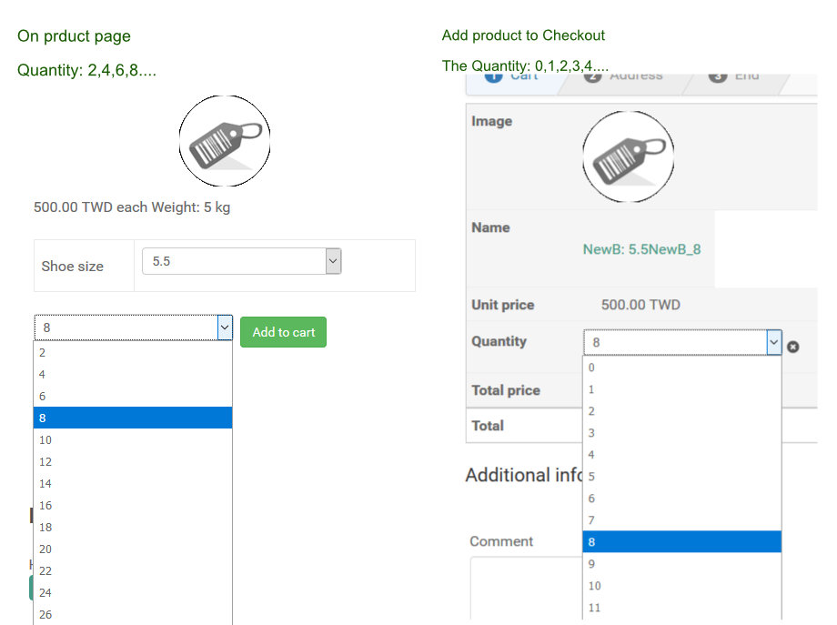

Hello, I have a problem on front-end product page.
After select the "characteristic value" the "quantity value" cannot be chose.(Click quantity select the dropdown does not work. )
and this problem only happened in Quantity input method: "Show select"
This problem just happen on one website that I managed, the other site I use hikashop is fine.
So, I was wondering where and how to check and fix the problem.
In addition, this is another question:
A product have characteristic for select and the Quantity select is " 2,4,6,8".
When add to the checkout page, the Quantity select still show " 0,1,2,3,4"(and the "1&3" can't be choose.)
I have to set quantity in every variants, could it possible that I just need to set the in product?

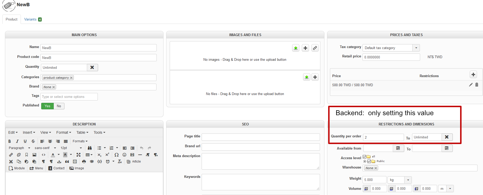

2. Again, we would need a link to such product.
Also please provide a screenshot of the settings of that product (and the default variant) so that we can analyze the situation.

I process some tests on your website, and wasn't able to reproduce your first issue... In any case, I was able to select the quantity.
=> Can you give a step by step process to see by ourself the issue ? Precise as well with which navigator do you use ?
For the second point, the variant quantity as to be set, like the main product in order to restrict quantity selection.
