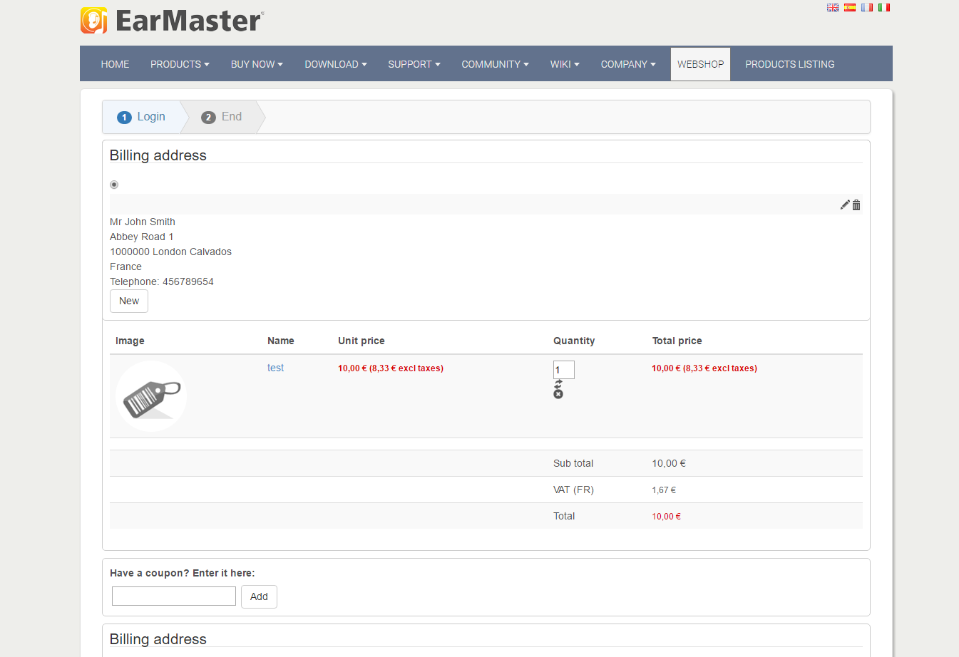

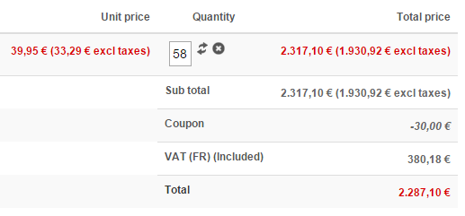

We are using the floating tax feature with multiple VAT rates (we sell products with electronic delivery).
When applying a coupon with a flat amount, it seems that Hikashop is calculating the VAT for both the coupon and the price incl VAT.
In my screenshot, the VAT amount (20%) should have been 381.18€, but it's displayed as 380.18€. Hikashop takes off 1€ from the VAT amount regardless of the quantity/total amount of the order, which led me to conclude that the missing 1€ is a VAT calculated from the coupon amount. Could it be so? What I would expect is that the Including VAT amount displayed is calculated based on the Total.
I have attached a screenshot of the checkout, as well as our Taxes settings.
Can you reproduce that problem on your end, or is there something that can be configured differently?
Last edit: 10 years 11 months ago by earmaster. Reason: typos

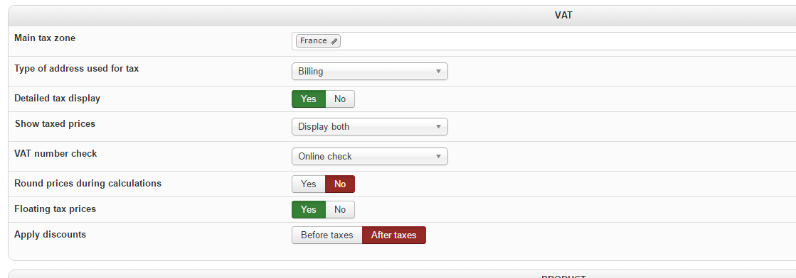

10 years 11 months ago #221340 by nicolas
You have the "apply discount" setting that you can change in order to change the behavior of the coupon tax calculation but you also have the "product tax category" setting of the coupon itself.
So I would recommend to try the different combinations so that it works like you want.

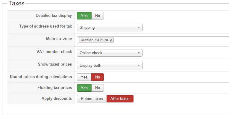

10 years 11 months ago - 10 years 11 months ago #221587 by earmaster
Turning on the "Show detailed taxes" taxes seems to have solved it for flat discounts somehow.
However, I noticed that the "Apply discount before/after taxes" has no effect whatsoever on the VAT amount though. So right now the shown calculations are correct, but it seems that something is not working as exepcted with floating taxes and discounts.
If the coupon is set to percentage, I can't get it to calculate the correct anounts. Changing the "Tax" option for the coupon has no effect.
Is this something you (or other users) can reproduce? We get the same results both on our developer install and on the production site.

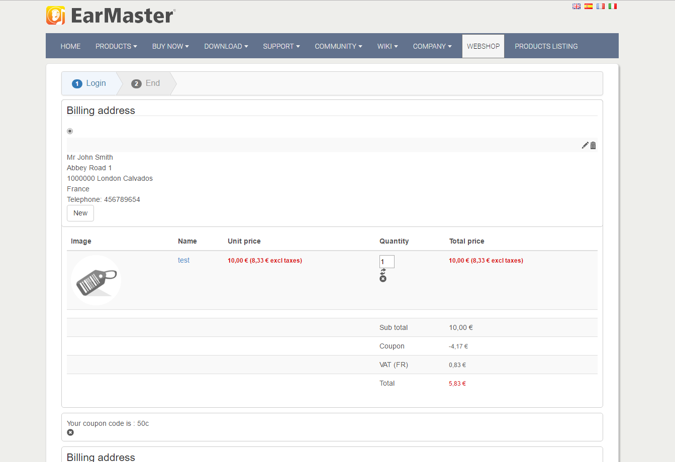

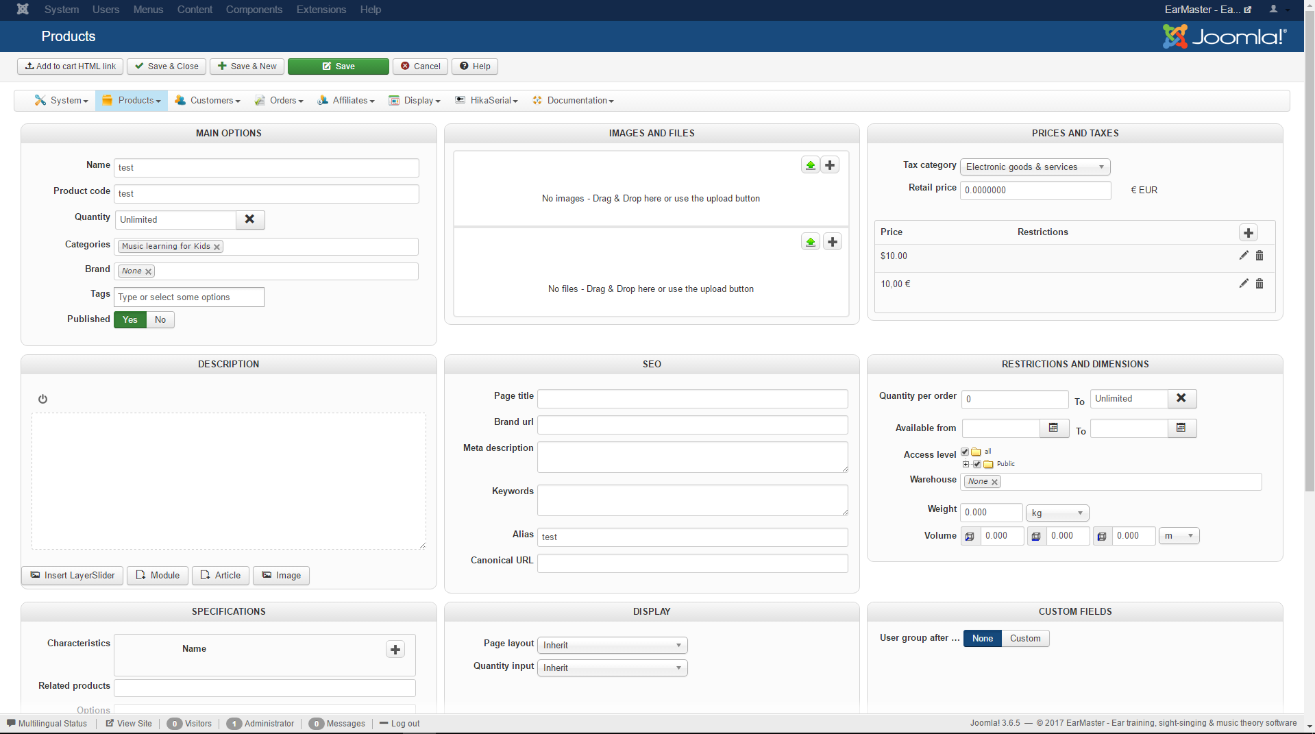

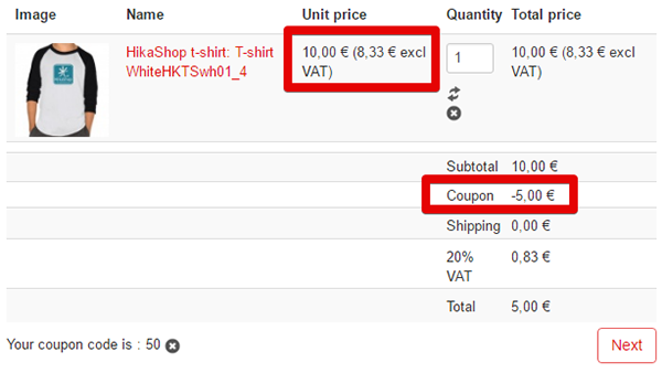

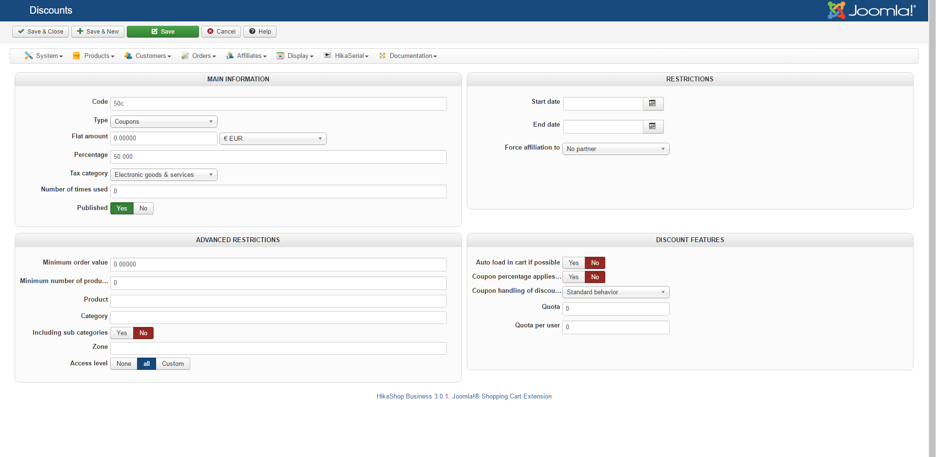

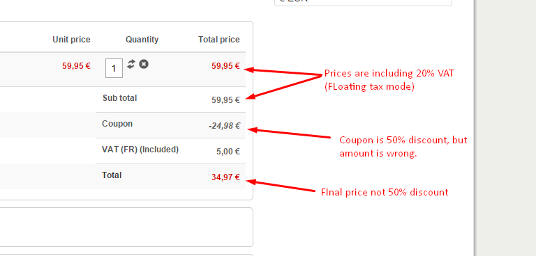

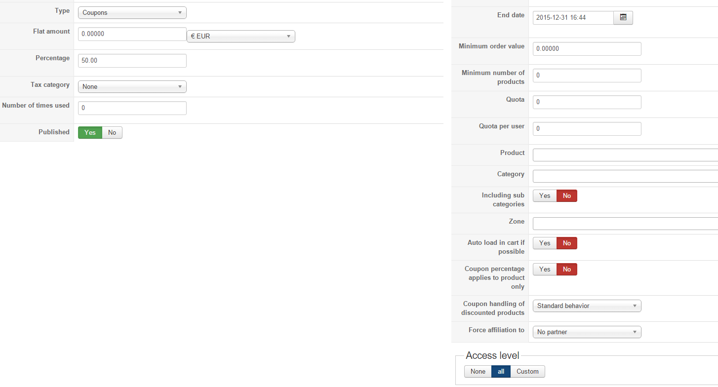

9 years 7 months ago #264360 by earmaster
Thank you. We have made an example of the error with a 50% coupon in Hikashop 3.0.1
Product settings:
VAT config:
Cart without coupon:
Cart with 50% coupon:
50% coupon settings:
The coupon value should be 5€ (50% of 10€), not 4,17€. Also the total price should be 5€, not 5,83€.
Somehow, the 20% VAT result (0.83€) seems to be correct, and corresponds to the VAT for the correct values that should have been displayed.
I will contact you via the contact form about URL.

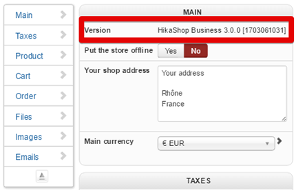

For a reason or another I'm not sure your're not on an HikaShop 3.0.1... Plus, you have to know that the latest build have some fix around this tax subject.
Can you try to update again and check in Components => HikaSHop => Configuration, and in Main tab and in Main part check the version and if needed reinstall from zip file and in Extensions => Manage => Install :
Awaiting news from you.
Last edit: 9 years 7 months ago by Philip.

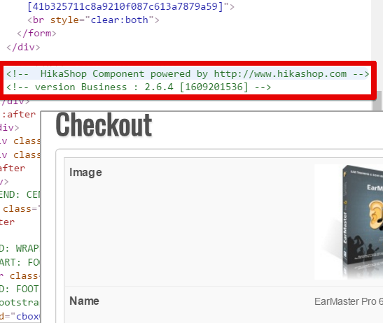

9 years 7 months ago - 9 years 7 months ago #264439 by earmaster
Sorry, forget about the link you got by email, it was a mistake. It's our production site, and yes, it runs 2.6.4.
The problem is in 3.0.1. The screenshots we posted are from our internal developer site, and it runs 3.0.1.
Check the last screenshot, it has the version number at the bottom. The problem is identical in both versions.
Our developer server is not accessible from outside at the moment. Would it be possible for you to reproduce the problem on your end by selecting the same VAT and coupon options as those in our screenshots?

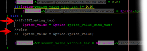

9 years 7 months ago - 9 years 7 months ago #264575 by Philip
Strange, maybe there is someting we can do that can solve your issue and will work with your specific configuration...
Can you try to modify your currency.php (in file YourWebsite\administrator\components\com_hikashop\classes)
Go around line 2315, find this part :
Code:
... $discount->discount_percent_amount_calculated = $price->price_value_with_tax * $discount->discount_percent_amount_calculated_without_tax / $price->price_value_with_tax; } else { if(!$floating_tax) $price_value = $price->price_value_with_tax; else $price_value = $price->price_value; $discount->discount_value_without_tax = ...
And replace it by this :
Code:
... $discount->discount_percent_amount_calculated = $price->price_value_with_tax * $discount->discount_percent_amount_calculated_without_tax / $price->price_value_with_tax; } else { //if(!$floating_tax) $price_value = $price->price_value_with_tax; //else // $price_value = $price->price_value; $discount->discount_value_without_tax = ...
Note that I'd just add '//' in order to comment (or switch off) some php orders on 3 line.
See modification with color :
Awaiting news from you to see if that fit your needs.

9 years 7 months ago #264988 by earmaster
Thank you for your answer.
Your previous quickfix hack works and it looks like it will make us running for now.
But please solve this bug in a permanent way so we don't need to make hacks every time we update hikashop and so that others can use the floating tax option too.
Our setup is not so special as you claim. There is no setting that will make coupons work with floating tax!
It doesn't matter if we use discounts before or after tax. The calculation is wrong in both situations.

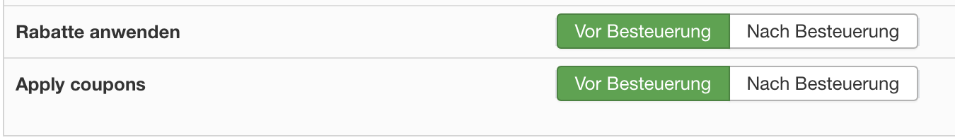

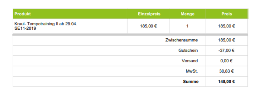

7 years 6 months ago #305594 by carniel
any update on this issue?
It's still the same with Hikashop 3.5.1
I use: floating tax prices = yes
Apply coupons : before taxes
But it still calculates the tax with the original price, then uses the discount and the customer sees the wrong tax.
Example:
185,-
includes 20% tax: 30,83
net : 154,16
With discount:
185,- full price
-37,- discount
148,- price
tax: should be 24,66 now- but is still 30,83 like before.
There are no kangaroos in Austria! ;-)
7 years 6 months ago #305611 by nicolas
We added patchs to the tax calculations with the "floating tax prices" setting activated in HikaShop 4.0.0:
www.hikashop.com/support/documentation/5...ashop-changelog.html
We've fixed taxes calculations with coupons using the "Floating tax prices" option.
So I would first recommend you to update to the latest version of HikaShop. It should work much better.

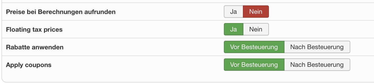

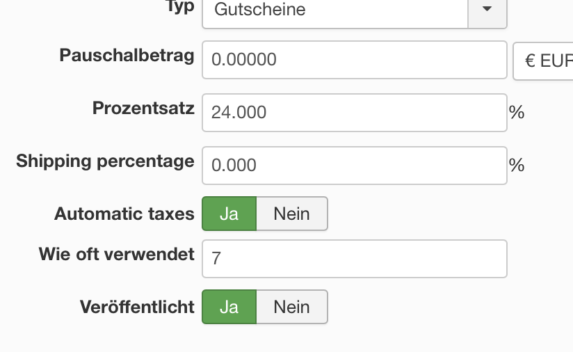

7 years 6 months ago #305930 by carniel
we upgraded to Hikashop 4.0.3
but it still behaves the same ...
attached a screenshot of the cart with discount
but the tax always calculates from full price
Options are: calculate discounts BEFORE taxes
Please advise ... !
Kind Regards, Eva
