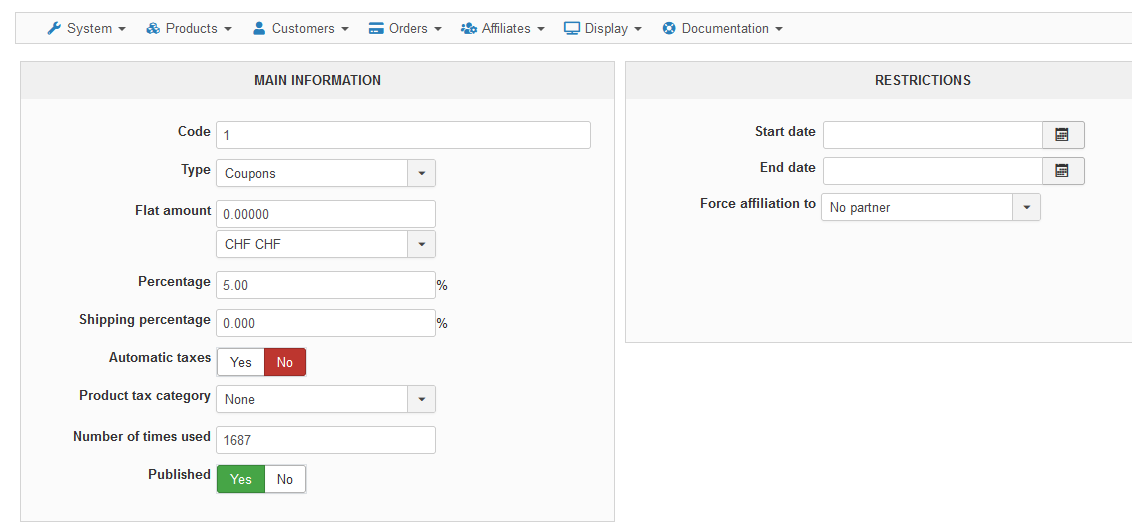

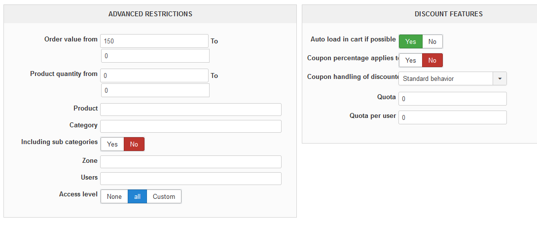

Could you provide a screenshot of the settings of a coupon which doesn't work so that we could try to reproduce the issue on our end ?

5 years 1 week ago #337161
by pat01
Replied by pat01 on topic Coupons: Auto load in cart if possible not working
5 years 1 week ago #337164
by nicolas
Replied by nicolas on topic Coupons: Auto load in cart if possible not working
Thank you. I was able to reproduce the problem and found the issue in the code. I've added a patch on our end.
Download again the install package of HikaShop on our website and install it on yours and it will fix the problem.

4 years 1 month ago - 4 years 1 month ago #345713
by speru
Replied by speru on topic Coupons: Auto load in cart if possible not working
This appears to be not working again even after after updating to HikaShop Business: 4.6.2
Update: the coupon is loaded in the cart and applied as long as there is no value in the 'Product quantity from' field.
Last edit: 4 years 1 month ago by speru.
4 years 1 month ago #345721
by nicolas
Thank you for the details.
I've made a patch for that. Please download again the install package on our website and install it on yours and it should then work properly.
Note that when you want to use an auto loaded coupon, I would first recommend to turn of the auto load setting and make sure you're able to use the coupon code in the cart when the coupon should be auto loaded. And if that doesn't work, you should get an error message explaining which restriction is the problem. That way, you can check that it works like you want before activating the auto load on it.
