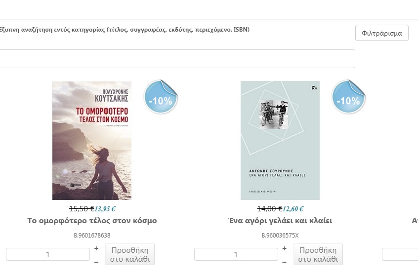

In exp1 i am using filter search in a category to search in for books in that category.
I want to use that search in the main page (exp2) as a search for the whole e-shop.

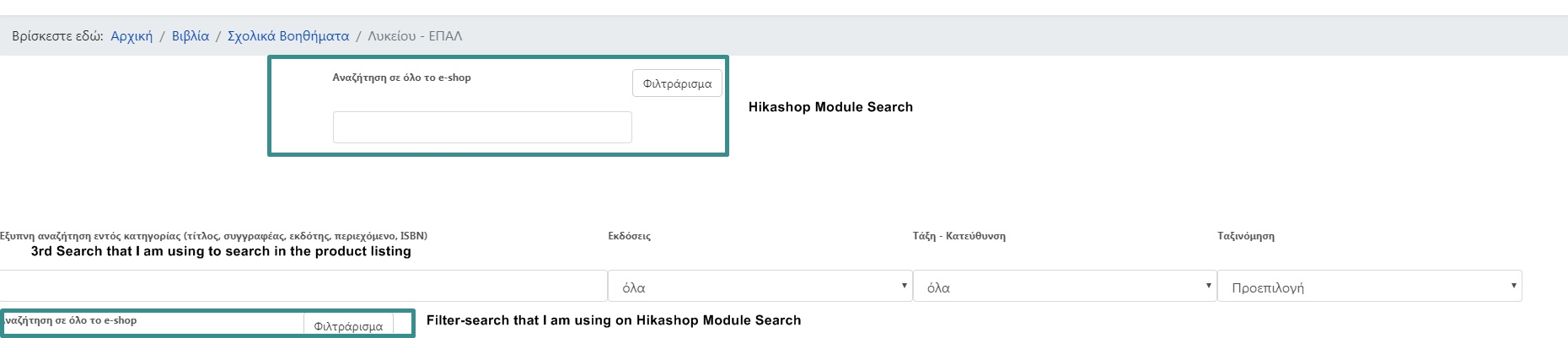

The problem is that if I publish the filter-search that I am using on the Hikashop Module Search, that filter-search will be displayed on the products listings. In the products listing I have enabled some other filters to: sort/display most popular/most recent etc. In that case I have two searches in the product listing: I have the global search (thought module) and one search (that filter-search that I am using in Hikashop Module Search) in filters position thought filters display. I dont want to have two searches, which are the same, when the second search will search in the displayed category. I have tried to disable the Menu Assignment in Hikashop Module Search, in order to be displayed only in Main Page.
Note: I have created one more (before asking you all that) search to search in the displayed category, because books have many characteristics and I want to help the user to find the book that he wants through description, ISBN, writer etc. But this search is irrelevant to what I am saying above. Just saying to state that I used another-third filter-search before I tried to set up a global search.
Here is a photo.
What I want: To keep the Hikashop Module Search everywhere and "hide" the filter-search, that I am using on the Hikashop Module Search, because I need the rest of the filters.
Hope to state my thoughts better now, sorry for any inconvenience.

Then I see a rapid solution via some css custom, for start have a look on my screenshot
And to add some custom css in your frontend_file.css, see this tutorial .
Now, in order to applied your command only when it's needed, use in your selector some class that refer to your specific listing products, by example :
=> div#hikashop_category_information_menu_123 .hikashop_filter_main .hikashop_filter_main_brandsearch_2 {
display: none;
And multiply this type of command, to remove when you have 2 sub-search part.
Hope this will fit your needs.
