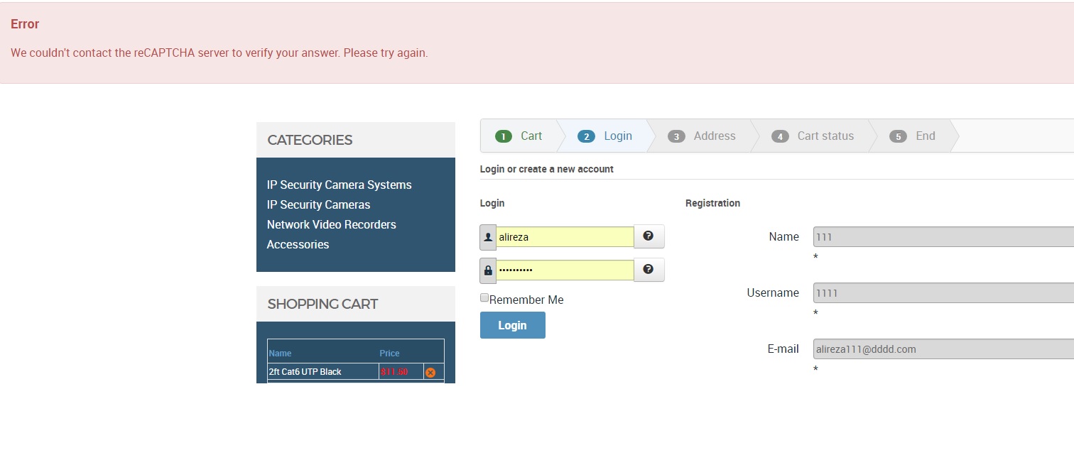

After enabling The Hikashop Captcha, I got the same error.
Please check attached file.
I changed this code
if (trim($answers ['success']) == true) {
to
if (trim($answers) == true) {
and everything is fine now.
Thanks,

Dear Nicolas,
This didnt work for me, i still got the error <i>We couldn't contact the reCAPTCHA server to verify your answer. Please try again.</i>
Do you have any other suggestions?
