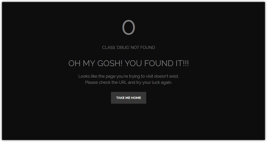

I am trying to set up the new Stripe connect payment method. When going to the point where the credit card details are entered I get a 404 page with the message "0 Class 'dbug' not found".

Hello Trevor,
Can you enable the "error reporting" and "debug mode" settings of the Joomla configuration, and send us screenshots of your error message so that we can have more information about it ? Thank you.

Hi Mohamed
The only screen message is on the 404 page (url: https://###/checkout/checkout/confirm)

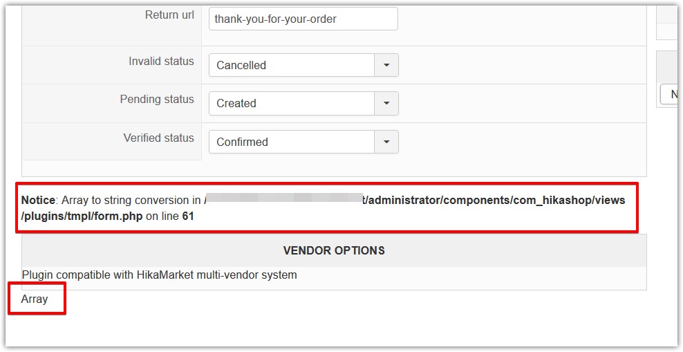

There is also an error message at the bottom of all the payment and shipping plugin pages:
In the /administrator/error-log file I found this:
