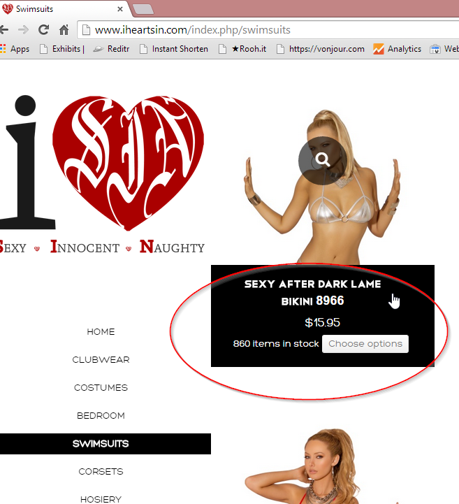

11 years 11 months ago #180738 by sison2466
Replied by sison2466 on topic remove stock level
I believe I set up my parameters correctly for both categories, but I am getting different responses for removing the stock showing.
Stock amount does not show in Corsets - www.iheartsin.com/index.php/corsets
Stock amount DOES show in swimsuits - www.iheartsin.com/index.php/swimsuits

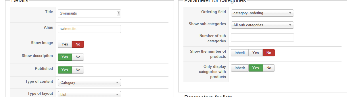

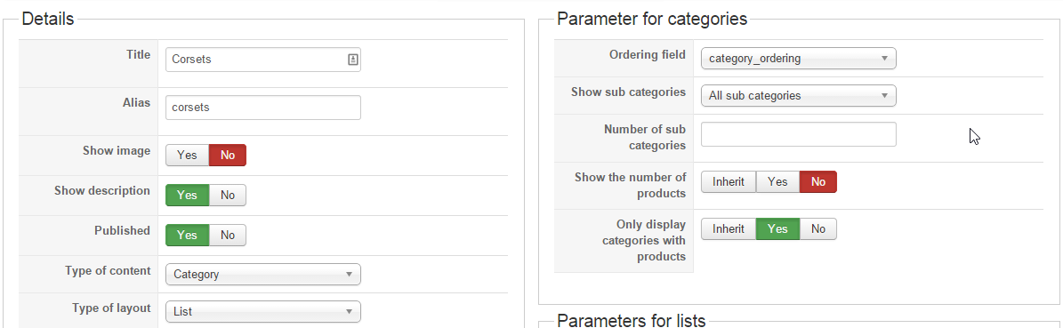

Screenshot of both categories are attached showing the "Show the number of products" is set to NO.
Am I missing a step?

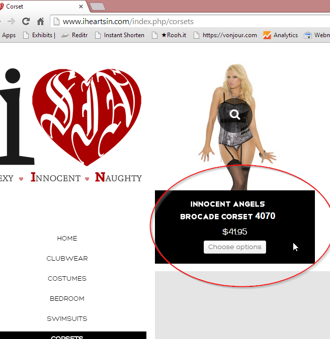

11 years 11 months ago #180868 by sison2466
Perhaps it is the terminology that I am incorrectly using.
Let me try saying it differently. Picture A shows up when I click on the menu to show the products in a specific category (Swimsuits). As you point out, the quantity is shown.
Picture B shows up when I click on the menu to show a DIFFERENT category (Corsets). In this picture, the quantity is supressed. The problem is I cannot figure out what setting I needed to change to get the quantity suppressed. I would like both instances to NOT show the quantity.
Are we still talking about the same topic|

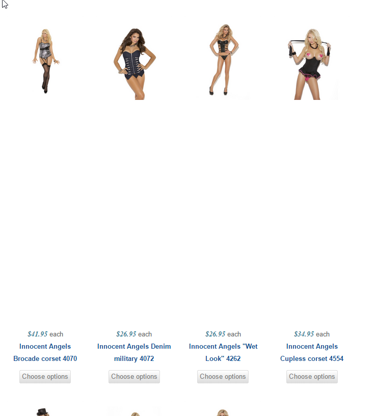

Also, I switched to a beez3 and still did not get a quantity
