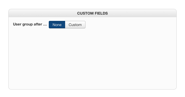

  • Posts: 42
10 years 3 months ago #241794
Is there any documentation for this plugin?
Since upgrading to Business the ability to select the fields in the Product details seems to have vanished and is now replaced with this...
Last edit: 10 years 3 months ago by info@flashpoint.net.au.
  • Posts: 86094
  • Thank you received: 14197
10 years 3 months ago #241810
There are two lines written in our FAQ but that's all you need. The plugin needs to be enabled with two custom item fields "width" and "length" configured to be displayed on the product page.
It's normal that you don't see them in the backend edition page of the product since they're supposed to be displayed on the frontend product page.
We've changed the custom fields display settings in the latest version. So if you have a problem with their display, try downloading again the install package of HikaShop on our website and install it on yours (in order to get the latest patches), and then edit the settings of the field and check that the display settings are correct, and save them.

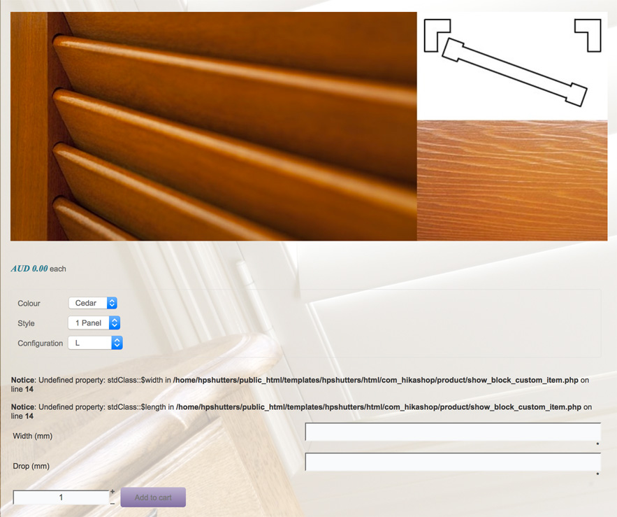

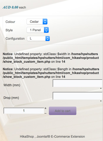

I have upgraded to both Joomla 3.6.2 and HikaShop Business 2.6.3 and the custom_quantity_width_length plugin no longer works?
Notice: Undefined property: stdClass::$length in /home/hpshutters/public_html/components/com_hikashop/views/product/tmpl/show_block_custom_item.php on line 14
Is there an update for this plugin or is it some other problem?
www.hpshutters.com.au/order-online
  • Posts: 42
10 years 5 days ago #248618
Sorry... the plugin still appears to work as far as doing the calculations, but the default values have vanished and the error message appears twice immediately above the width/length custom fields!

  • Posts: 42
9 years 11 months ago #249430
The link to the page I'm trying to troubleshoot is www.hpshutters.com.au/order-online
I currently have line 14 in the the "show_block_custom_item" file of the "product" view set as it was originally:
$itemData = JRequest::getString('item_data_' . $fieldName, $this->element->$fieldName);
I get this result:

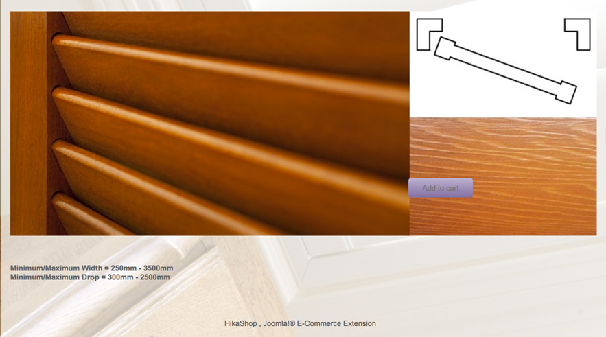

When I change line 14 code to:
$itemData = JRequest::getString('item_data_' . $fieldName, @$this->element->$fieldName);
I get this result:
All options have been removed and the Add to cart button sits over the image!
The default values for my custom fields are: width: 3500 & length: 2500 however these values aren't displayed. This wasn't the case before upgrading both Joomla and HikaShop. Everything was working fine prior to the upgrade and I haven't done anything else to the configuration. Please help!

9 years 11 months ago #249438
As expected the problem isn't coming from my proposed change.
If you leave the code as before and instead turn off the "error reporting" setting of the Joomla configuration you'll get the same issue.
The problem you have is a byproduct of the change. The issue is a CSS issue which happens because of how you configured your image. You set it to fill the whole page. But the layout of a product page is to have the image on the left and the add to cart/attributes area on the right. So it's actually normal that the image and the right area are mingled like that.
You were just lucky that the error message pushed the right area below the left area.
But normally, you should add custom CSS to do that:
#hikashop_product_left_part{ width: 100% !important; }

  • Posts: 86094
9 years 11 months ago #249553
Several things here:
1. Here is how to add CSS:
2. The custom fields are looking for the default values in the columns "width" and "length" of the products.
The error messages say that these columns do not exist.
So I suppose that you must have removed such custom fields, or you did something with the database.
The width and length you can enter as dimensions of the product in the default interface are in product_width and product_length, not width and length. So if you say that you entered the dimensions there, it's normal that the custom fields are not picking them up since they have a different name.
