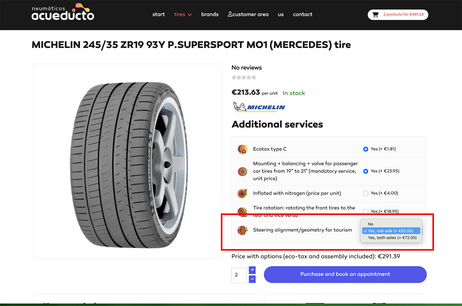

Optional service multiplying by tire quantity instead of charging once per vehic was created by pabloarias

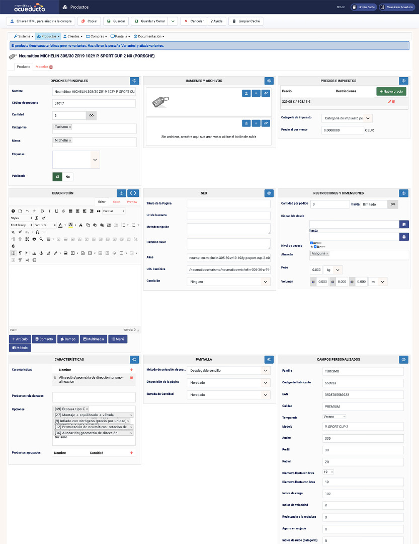

We have a tire shop configured with HikaShop where customers can purchase tires and additional services. Most services are charged per tire unit (mounting, nitrogen inflation, etc.), but we have one specific service that should be charged once per vehicle, regardless of tire quantity: "Steering alignment/geometry for passenger cars".
Current problem: This service is configured as a product characteristic, and when a customer adds 2 tires to cart and selects this optional service, the system multiplies it by 2 (85.95 € × 2 = 171.90 €), when it should only charge 85.95 € once, as this service is performed on the vehicle as a whole, not per individual tire.
What we need:
This service should remain optional (not mandatory)
It should be visible always, even when buying a single tire
When selected, it should add only 1 unit to cart, no matter how many tires are being purchased
All other services should continue working per tire unit as they do now
Question: How should we configure this service to charge it once per vehicle instead of multiplying by tire quantity? Should we use a different configuration method (option instead of characteristic, or separate product)?
Please see attached screenshots:
Product frontend view showing the service
Cart showing the service multiplied by 2
Backend product configuration
Thank you for your assistance.

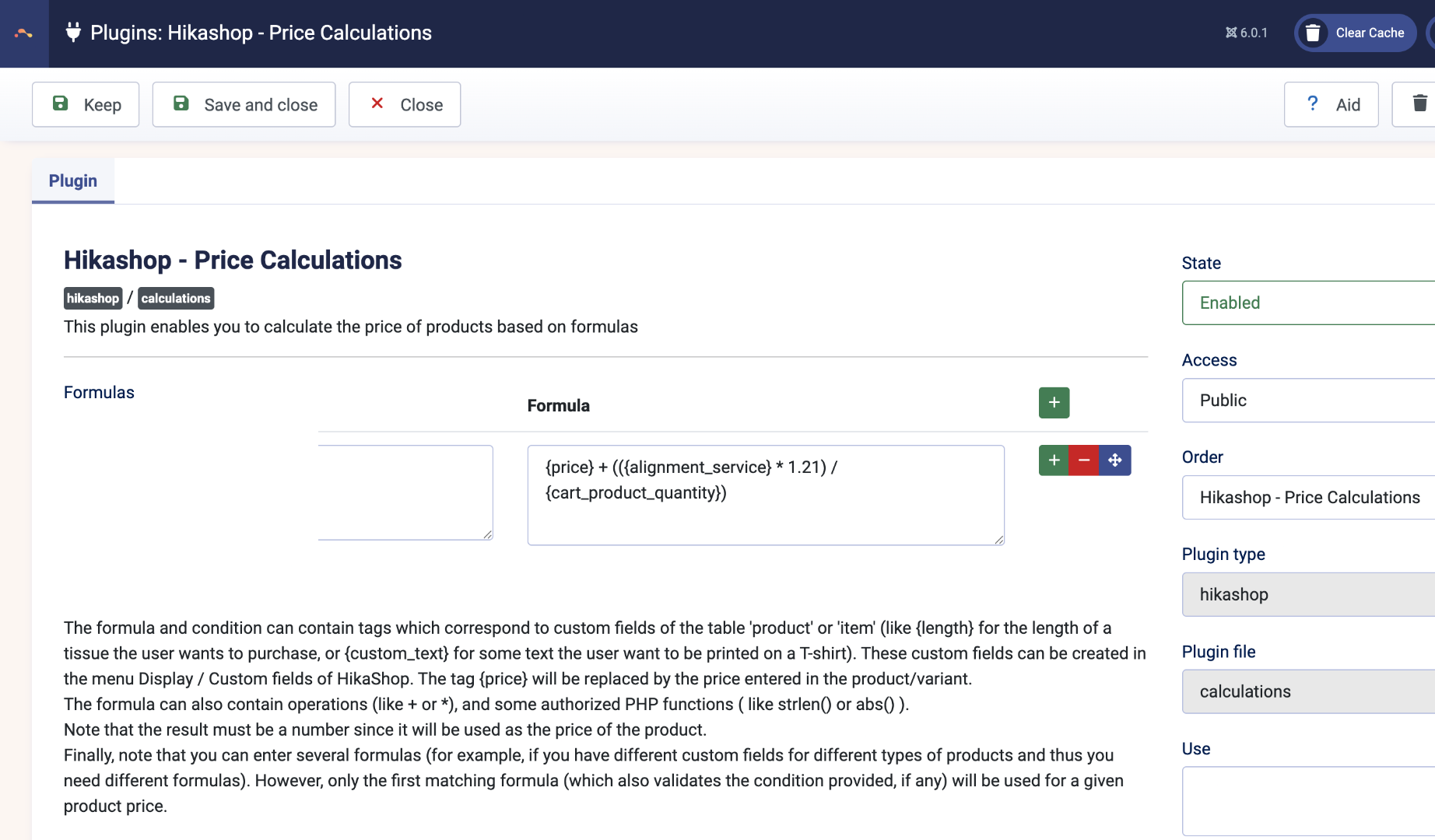

Yes, you can make an extra fee behave like a fixed charge per order instead of multiplying with quantity in HikaShop by using the Price Calculations plugin together with a custom item field. The idea is that instead of relying on a standard product option (which always multiplies by product quantity), you create a custom field for the extra service and then use the price calculations plugin to inject a flat amount into the price formula based on that field. This lets you apply the extra fee once per order even if the product quantity increases.
The key steps are:
Add a custom item field for the optional service:
www.hikashop.com/support/documentation/4...shop-field-form.html
Use the Price Calculations plugin (which supports formulas using custom field tags) to define a rule that adds a flat fee when that field is selected, without multiplying by quantity:
www.hikashop.com/marketplace/product/148...ce-calculations.html
This gives you much more flexibility than standard options and avoids the quantity multiplication.

I'm using the Price Calculations plugin to add an optional alignment service to tire products. The formula uses a division operation to charge the service once per order (not per tire), but this is causing tax calculation inconsistencies.
We are using Hikashop: 6.1.1
Plugin formula: {price} + ({alignment_service} / {cart_product_quantity})

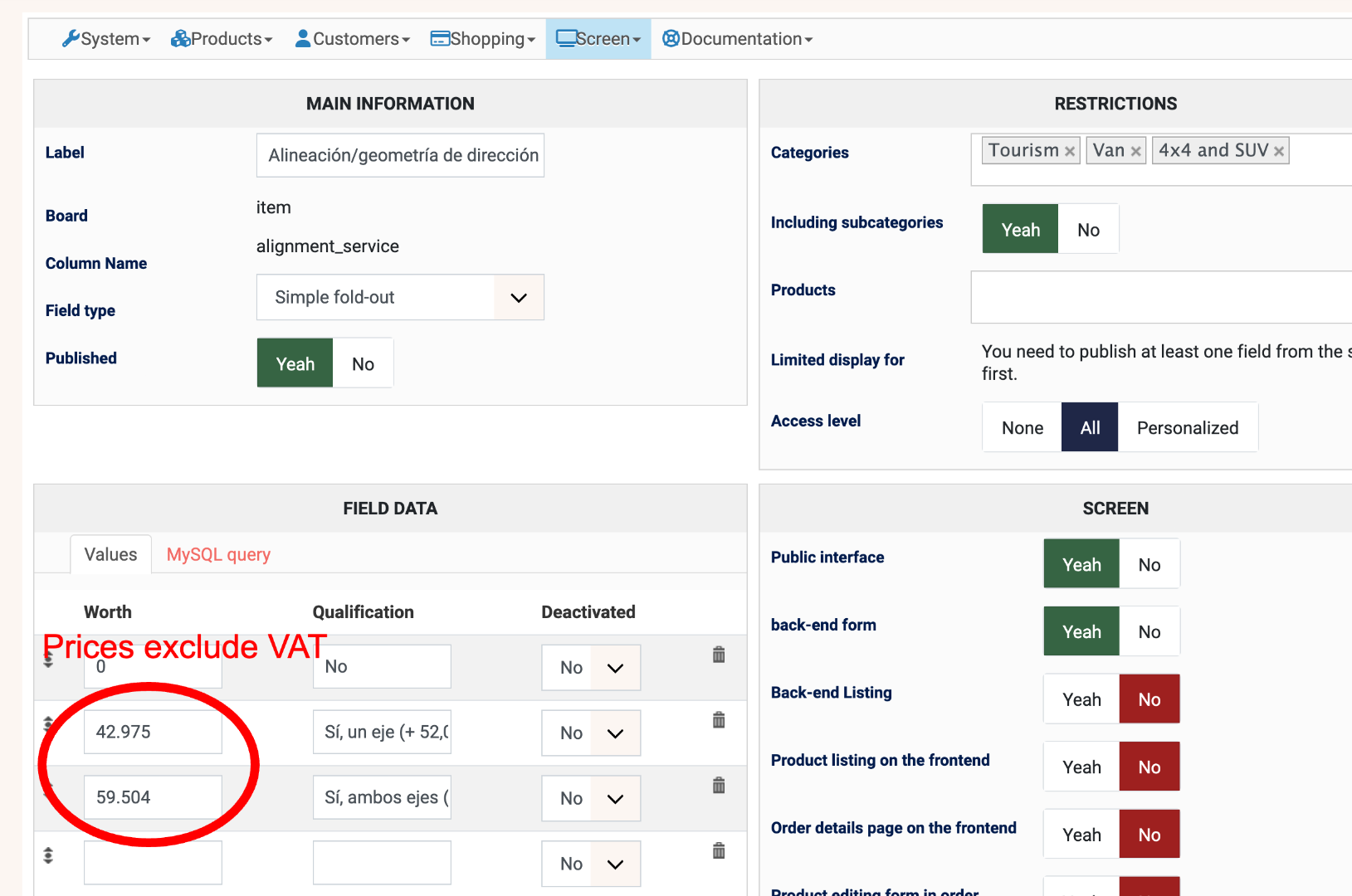

Custom field configuration:
Table: item
Column: alignment_service
Values: 0, 42.975, 72.00 (without tax)
Tax: 21% Spanish VAT
"Show prices with tax" = Yes
The problem:

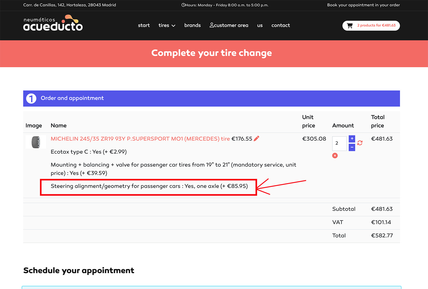

With 2 tires + alignment (value 42.975€):
If field value = 42.975€ (without tax):
Product page: 445.40€ (❌ missing ~4.51€ tax on alignment)
Should show: 449.91€
Checkout total: 899.82€ ✓ (correct)
Checkout unit price: 475.67€ (❌ should be 449.91€)
If field value = 52.01€ (with tax):
Product page: 449.91€ ✓ (correct)
Checkout total: 910.74€ (❌ tax applied twice, +10.92€)
Should be: 899.82€
Question:
How should I configure the custom field value (with or without tax) when using division in the formula? The division by quantity seems to cause tax calculation issues.
Expected behavior:
With 2 tires + alignment (one axle) - field value 42.975€ (no tax):
Product page: 449.91€ (with tax)
Calculation: (350.34 + 21.49) × 1.21 = 449.91€
Checkout unit price: 449.91€ (with tax)
Calculation: 449.91 × 2 = 899.82€
plugin.png: Price Calculations plugin configuration
field.png: Custom field "alignment_service" configuration
imagen1.png: Product page, field value 42.975€ (without tax)
imagen2.png: Checkout, field value 42.975€ (without tax)
imagen3.png: Product page, field value 52.01€ (with tax)
imagen4.png: Checkout, field value 52.01€ (with tax)
Could you please advise on the correct configuration for this scenario?
Thank you for your support.

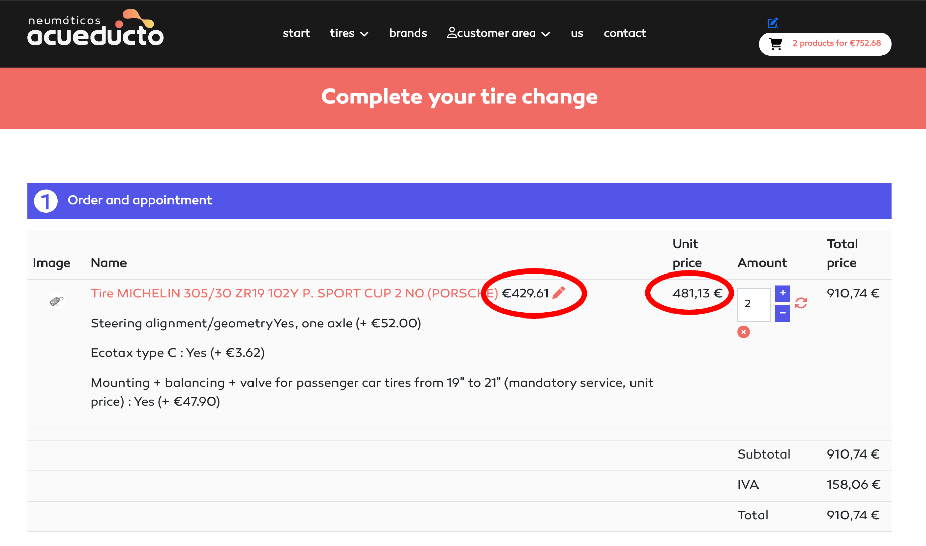

The change you suggested doesn't seem to affect the cart calculations at all. The product page calculations remain correct, but the cart hasn't changed from the previous version. Let me explain the issues I'm detecting in the cart:
The amount of 481,13 € comes from the following operation (all prices with VAT included):
481,13 € - 398,15 € (tire price) = 82,98 €
82,98 € - 47,90 € (mounting × 2) - 3,62 € (eco-tax × 2) = 31,46 €
31,46 € - 26,00 € (alignment / 2) = 5,46 €
These extra 5,46 € come from adding the alignment VAT twice: (52 × 21 / 100) / 2 = 5,46 €
So the alignment VAT is being duplicated.
Additionally, the prices marked with red circles (images in attachments) are very confusing not only for the user but also for us.
I would like to know if the product list in the cart table could be improved so that the unit price shown is for a single tire with its individual options, i.e., tire price + eco-tax + mounting, which in this case would be 423,91 €, and below it a line for alignment (a unit cost since it's per vehicle) of 52 €.
Ideally, the cart should look like this:
"Tire Title" + tire price (398,15 €) ... Unit price 423,91 € ... Qty 2 ... Total 847,82 €
Alignment/wheel geometry: Yes, one axle (+ 52,00 €) ... Unit price 52,00 € ... Qty 1 ... Total 52,00 €
Total ............................ 899,82 €
VAT .............................. 156,17 €
Amount without VAT ............... 743,65 €
I'm attaching screenshots of the current cart along with screenshots of the plugin configuration and the custom field.

THE PROBLEM:
When using division in formulas like {price} + ({alignment_service} / {cart_product_quantity}), the cart_product_quantity field was being incorrectly treated as a price and taxed, which broke the calculation.
THE SOLUTION:
The plugin now automatically detects fields that are clearly not prices (quantities, IDs, counts, etc.) and excludes them from taxation. This means your formula will now work correctly.
YOUR FORMULA:
Simply use: {price} + ({alignment_service} / {cart_product_quantity})
Make sure your alignment_service custom field stores the value WITHOUT tax (€42.975 in your case). The plugin will:
1. Tax the alignment_service value (€42.975 -> €52)
2. NOT tax the cart_product_quantity (stays as 2)
3. Calculate: €423.91 + (€52 / 2) = €449.91 per tire
4. Cart total: €449.91 * 2 = €899.82
ADDITIONAL NEW FEATURES:
We also added new modifiers that may be useful:
- :optional:VALUE - Use a default value if a field is missing (e.g., {extra_fee:optional:0})
- :withtax - Force taxation on a field even if it’s auto-detected as non-price
Please update to version 2.2.0, by downloading the latest version of the plugin via the same download link you got after your purchase, and let us know if you have any questions.

I've just tested the new version and I confirm that the VAT issue is completely resolved. The calculations are now correct both on the product page and in the cart.
The prices are calculated perfectly:
Unit price: 449,91 €
Total (2 tires): 899,82 €
The alignment VAT is no longer duplicated
Excellent work, the plugin works exactly as I needed.

I didn't explained myself clearly.
I don't need to add additional fees to the cart—the Cart Fee plugin doesn't solve my problem.
My problem is with the cart display.
Current situation:
Unit price shown: 481,13 €
Quantity: 2
Total: 962,26 €
But the math doesn't add up: 481,13 € × 2 ≠ 962,26 €
What I need:
Unit price shown: 449,91 € (the actual price of 1 tire with all its services)
Quantity: 2
Total: 899,82 €
And the options (Eco-tax, Mounting, Alignment) displayed as separate rows in the table instead of text below the product, so the customer can clearly see what they're paying for.
Does this require modifying the cart template (/templates/xxx/html/com_hikashop/checkout/cart.php)?

Yes, in that case, you'll have to customize the display with a view override:
Note that it is the view file checkout / show_block_cart.php that you want to modify.
