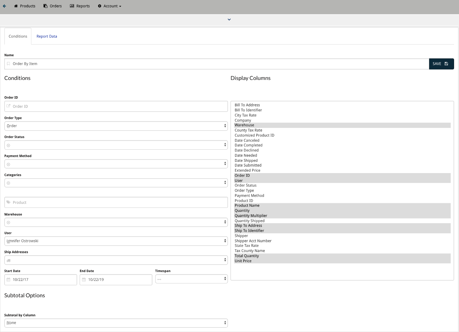

By way of example, attached is another ecommerce system we use that has this reporting capability.

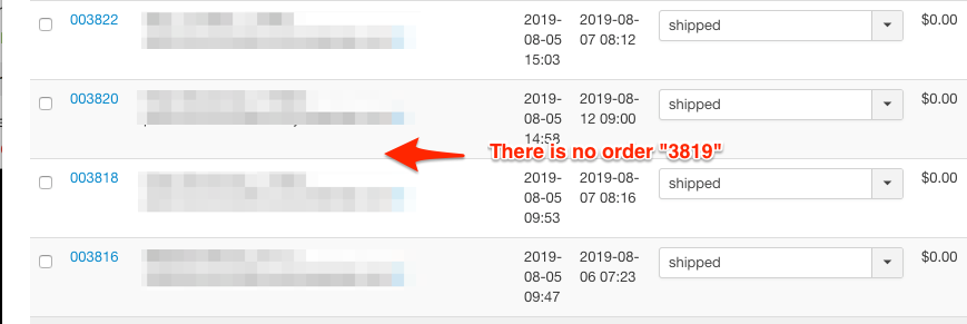

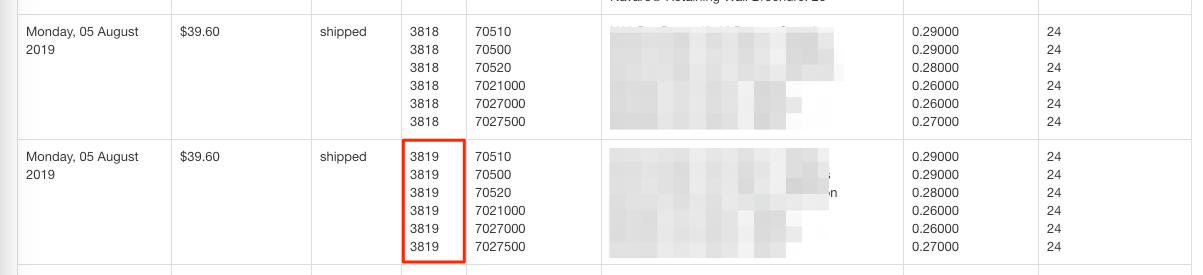

Thank you. We were able to pull the data via massactions following your example. But there seems to be a problem with the way the data is listed.
There are duplications listed with order numbers that do not exist.
For example,
Orders 3818 and 3819 are the same in the massaction reporrt. However, there is no order 3819. That is an order that was canceled and deleted. Same with 3820 and 3821
3822 and 3823
etc.
It appears that if an order is removed, it shows up incorrectly in the massaction reports as a duplicate of the previous order.

6 years 10 months ago #313274
This is probably a "subsale" generated by HikaMarket. If you check the hikashop_order table in your database, you should have an entry with the id 3819. But its order_type should be different from "sale".
So what you want to do is add another filter on the order_type column being equal to sale to skip HikaMarket's subsales in your reporting.

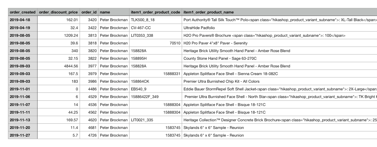

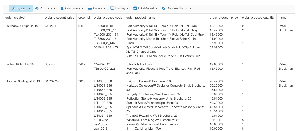

  • Posts: 176
  • Thank you received: 5
6 years 9 months ago #313863
Here is a screenshot of the difference.
Selections are exactly the same for each. The display to screen is good. But the csv is unusable. Is there a way to make the csv export be more like the display version?
Specifically: The display version has all the items from each order displayed together in a single column. This results in 8 total columns displayed. The csv version has each item on an order spread out into thier own columns. This results in columns all the way out to "IU" (over 200 columns).

  • Posts: 86187
6 years 9 months ago #313872
There is no option for that. It's normal that the products information is split into different columns in the CSV exports.
Or it could be made into different lines, but then you would have one line per order per product so it wouldn't be anymore an export of orders but an export of products of orders.
