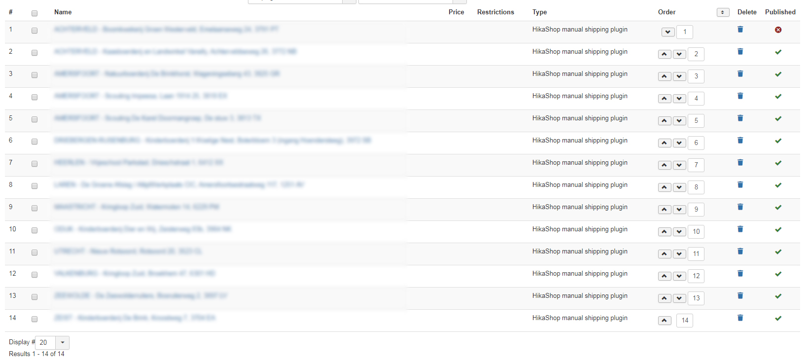

I'm afraid I jumped into conclusions, although I still would make a recommendation. This is what happened:
I went to the Shipping Methods screen and used the Copy function. Next thing that happens, is that you now see two identical entries. As far as I know you can't really see the difference between the existing and the new Shipping Method. I accidentally changed the existing Shipping method (thinking it was the new one). So that is what went wrong. So either I overlooked something or Hikashop might make a change in order to make visible the distinction between old and new?

What you can do is check the id of the shipping methods on the right side column. The one with the higher id is the new one.

You're right, the id column has been deleted to give more room to the other columns.
You would have to look at the id in the URL.
We'll improve that in the future.
