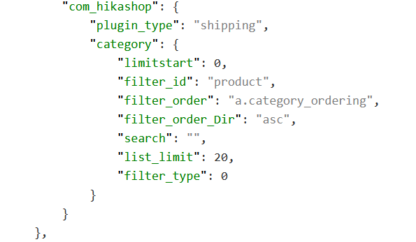

When i look at the session in the debugger i see something strange.
On this site:
Attachment not found
On other sites:
I think it should have something to do with it, but i don't know what exactly and how to fix.
